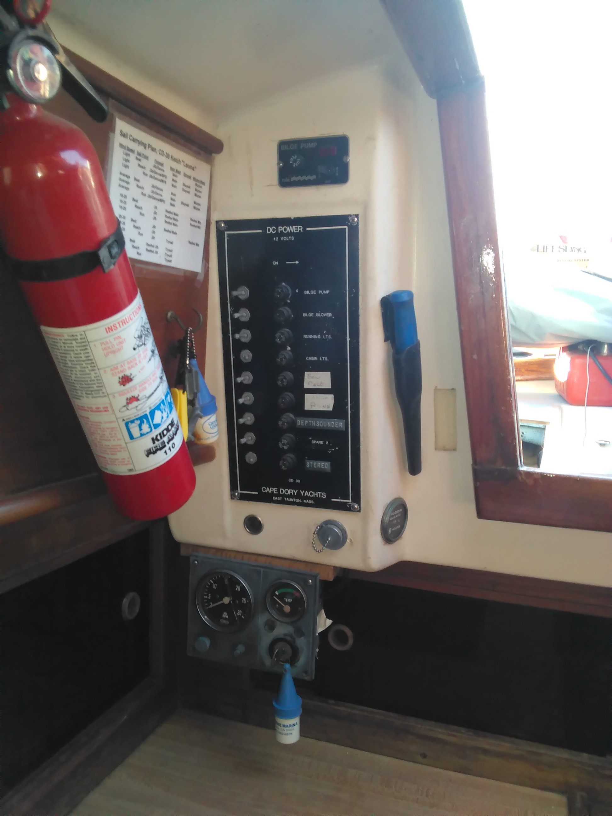

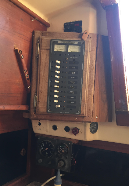

Here is the photo of my old Distribution Panel and the new one. The cabinet door and frame I got from the consignment store turned out to be too small. I had to have the panel in now, so I could install the breakers for the auto pilot and plotter. I'll have to get a better plan for the cabinet and redo it. I did however pull out all the old and useless wires. Now I have mostly new wires all routed nicely and with heat shrink eyelets. I left enough slack so I can work on it later. I also cut a piece off the power feed bar to isolate one position for a 30 amp shore power breaker. I'm not sure if that was a good idea. It's the one on the bottom that's not labeled. The panel is secure and sturdy. I'll think about how to rebuild it for a few months. I want to make that whole corner a perfect cabinet like it was original from the factory. When I got the boat, the cockpit combings were disconnected from the cabin. I drove some longer screws thru that wooden backer piece. This is probably the worst area on the boat as far as carpentry goes. There is a little water damage under the forward portlights and under the companionway. These are not a priority for me.

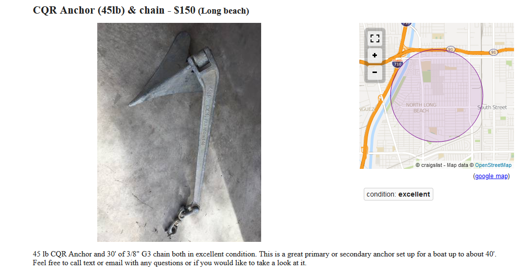

I found a 45 lb. CQR on C= list for $150. It looks like it includes a swivel and some 3/8 " chain. I wonder if its too big for my boat. I know the chain won't work with my windlass. I sold one of my 25lb er's for $100

Be patient, the right anchor will come to you. I feel the 35# CQR with 5/16" chain, is the right size for a CD-30. Anchor size is kind of like Goldielocks' porridge.

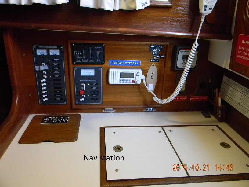

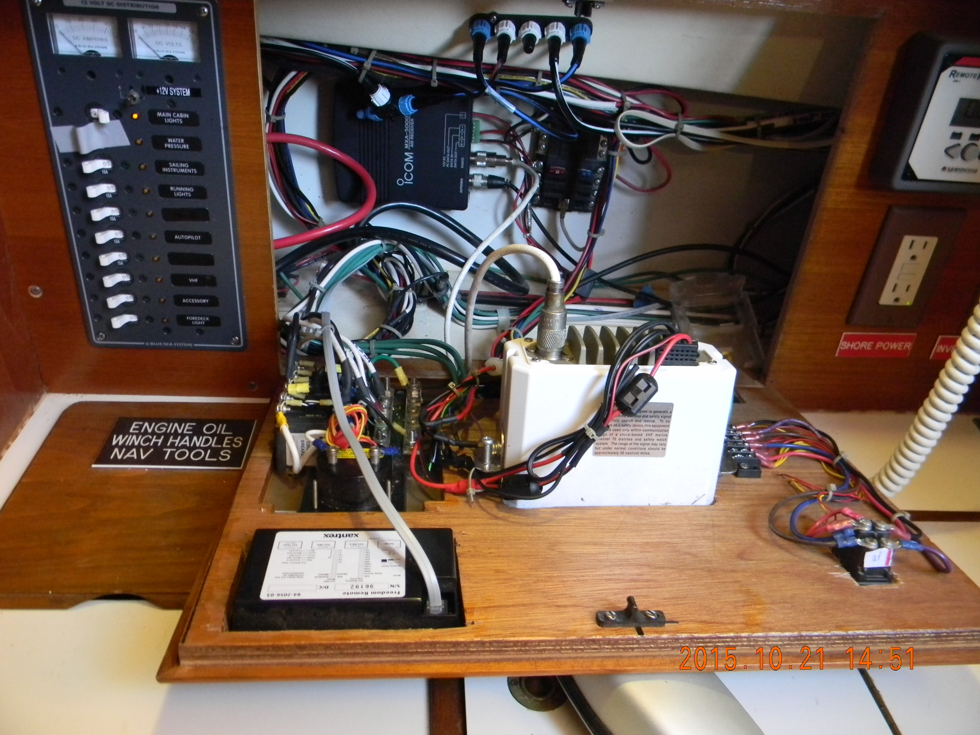

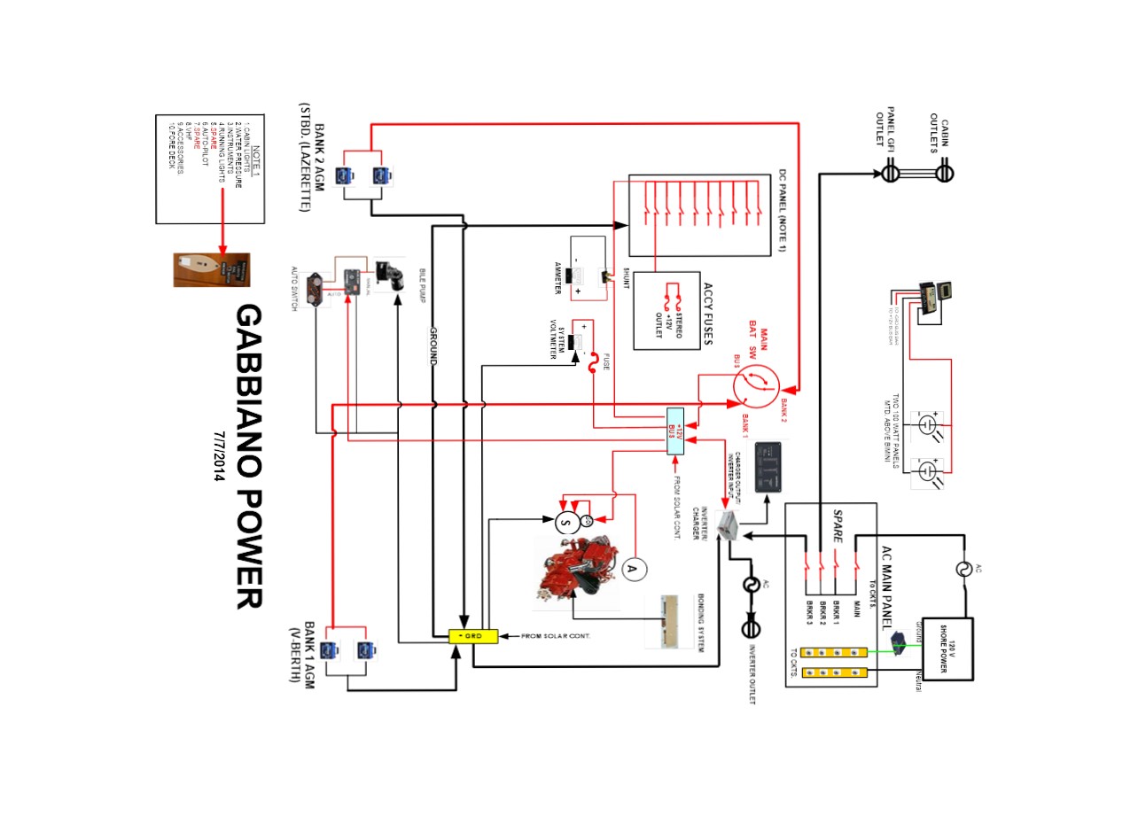

This the wiring job for Gabbiano.

Frenchy

That's impressive, Moctrams. :!: Did you do it yourself? It sure looks professional.

Did it myself. Retired telephone Co. I have rewired many boats over my 30 years at Flag Harbor in southern Maryland. Owner buys all the "stuff" and I only charge labor. The max I ever charged for labor was $1500.00. It's all fun anyway.
