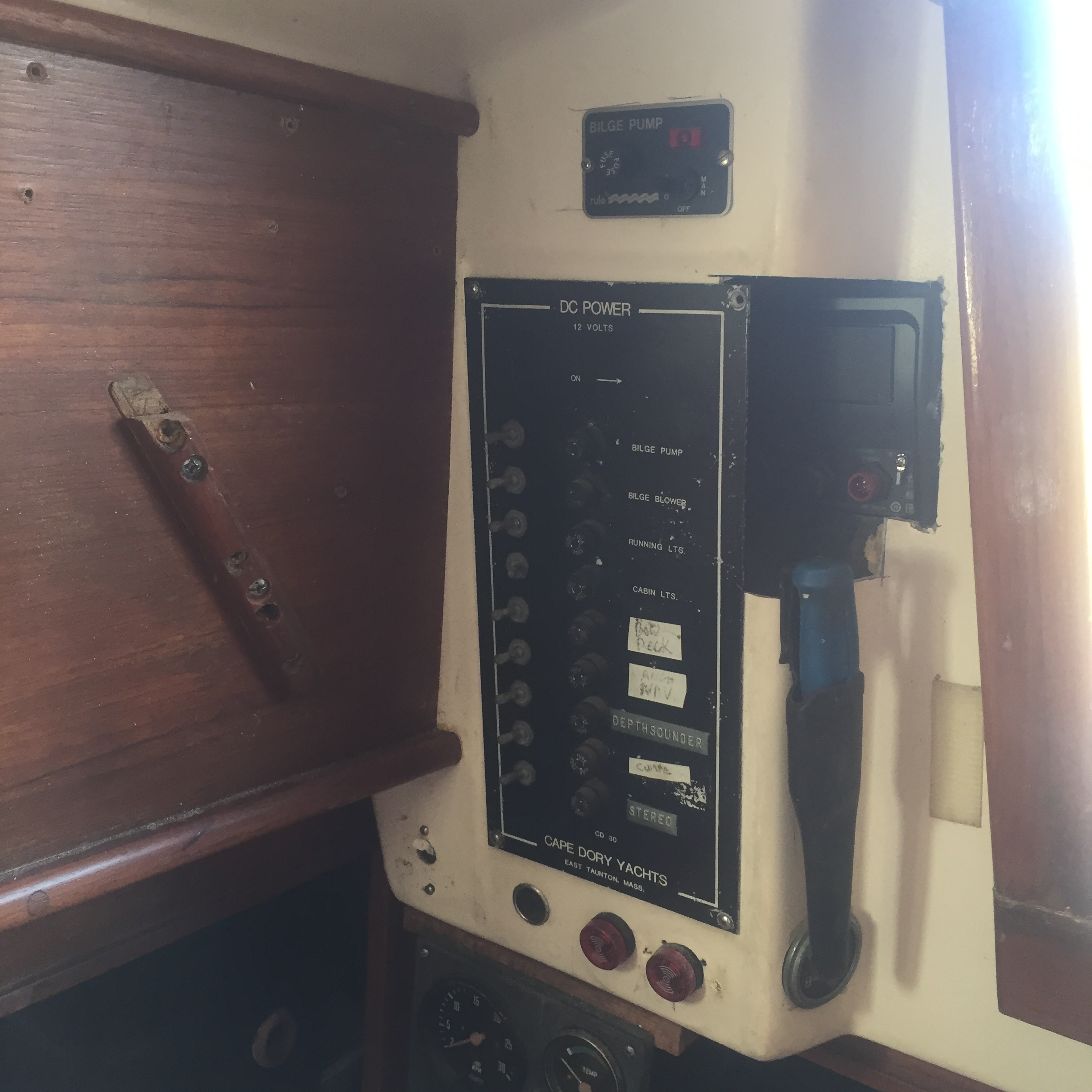

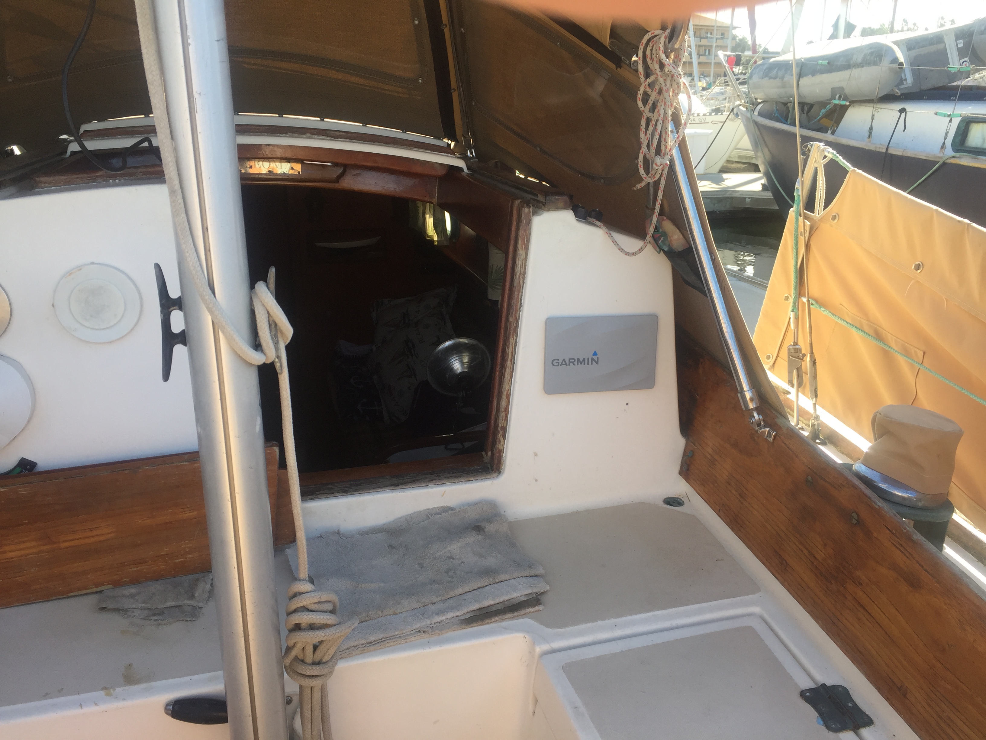

I put the Garmin 742xs Plus in. It will control my new Jefa autopilot. I’ve got all the componets mounted and pulled all the cables. I'm a little confused so I will get the technician to finish. Looks like its time to start on the instrument and distribution panels. Ill have to think about it but I think I will make a small teak cabinet to fit in the corner.

same panel I put in Jerezana two years ago ... and same spot I put my B&G chart plotter ...
My panel came with generic labels for the fuse/switches; including "Engine Room" which we used to label one switch for an L.E.D. placed right over the new Beta, mounted to the underside of the cockpit sole ... I'm still looking for table/chairs and an expresso machine for the "engine room" ...
Fred
Fred

Hi Fred. Looks like I have way more wires A lot of them dont go to anything. Im pulling out what i can. Im wondering if i should replace all the 40 yr old stuf. At least the easy ones

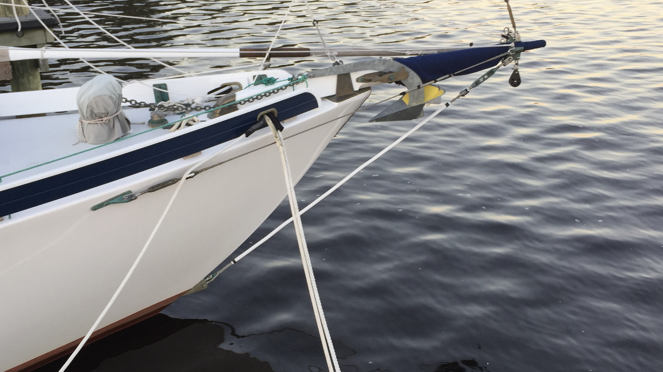

You can set up a bridal. Lots of folks use them. I use a pendant run to a block that’s attached to the kranze iron. Very simple. Pictures attached. I would think you could rig one the bowsprit opposite the side of your roller. Incorporate a wide base plate. Or perhaps a large shackle with the clevis pin also serving as the clevis pin for the bobstay turnbuckle. It would also support a robust block. That would be the strongest, simplest, and cleanest looking.

Also, it just occurred to me you can just put a roller on the port side of the bowsprit and run a snubber over that side to your bower.
Re: “Leoma” update 11/19
Thanks John. I thought It wasn't good to run the rode to the bowsprit since I don't have any lateral support. I think I said that right. I mean for the sideways forces. Maybe that big 2x12 is good enough since that is how it was designed. I thought of putting a pvc pipe over the bobstay but that would look horrible. It would be easy to make a bridle if I had all chain. Also about the mizzen. Don't I need to have eyelets for the tack and clew to reef down. I think I need a halyard winch. It seems like I'm not getting it tight enough. There is still some wrinkles. I pull it as hard as I can. It only seems good on a reach. Close hauled I have to tie it to windward a little. It seems like that would just be brakeing. I'll work it out eventually. The new reefing for the main is great, with the rings and snapshackle. (I think mine is called a carabiner), also the boom brake. It's all working great.. I got to get caught up on finances for a while, plus it's Christmas time and then taxes again. Merry Christmas everybody.
It might be best not to do so if you were preparing for winds in excess of 50 knots but I have had no issues running my rode through a roller on the bowsprit in sustained 30 knot winds for three days which included gusts to the low 40’s.JD-MDR wrote:I thought It wasn't good to run the rode to the bowsprit.

- Not a great illustration but you can see the pin that holds my rode on the roller.

I can’t imagine you need lateral support for a plank style bowsprit that short. I would not hesitate to run a snubber over an adjacent roller. Jim’s right about capturing the snubber if you run it over a roller. I have a bolt I can thread through the roller cheeks to capture the chain so it cant jump out. But my snubber runs through a block so it’s a non issue for me. Spartan makes a nice roller with a capture bolt I think. But you can weld a copy from SS.

Great I'll go back to using the roller on the sprit and back to the cleat. I'll have to figure out some kinda nipper system for my mizzen. I have two 25# CQR's. I'm looking to trade one for a 35# and I plan to get new chain and the 8 plait rode. The Lewmar windlass only takes 5/8" line. I want first class ground tackle . That was scary waiting out that blow. I'm not sure what my priorty was. I made a list while out there. It's on the boat./ It's a full page long.Here's a photo of my crewmember. (My Niece)

Your bow roller looks up to the task....in my opinion. I wouldn’t hesitate to use it.
