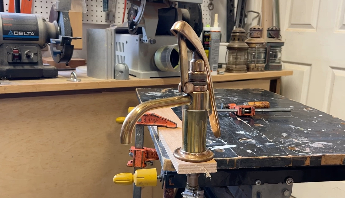

Fynspray WS 62 Brass Galley Pump

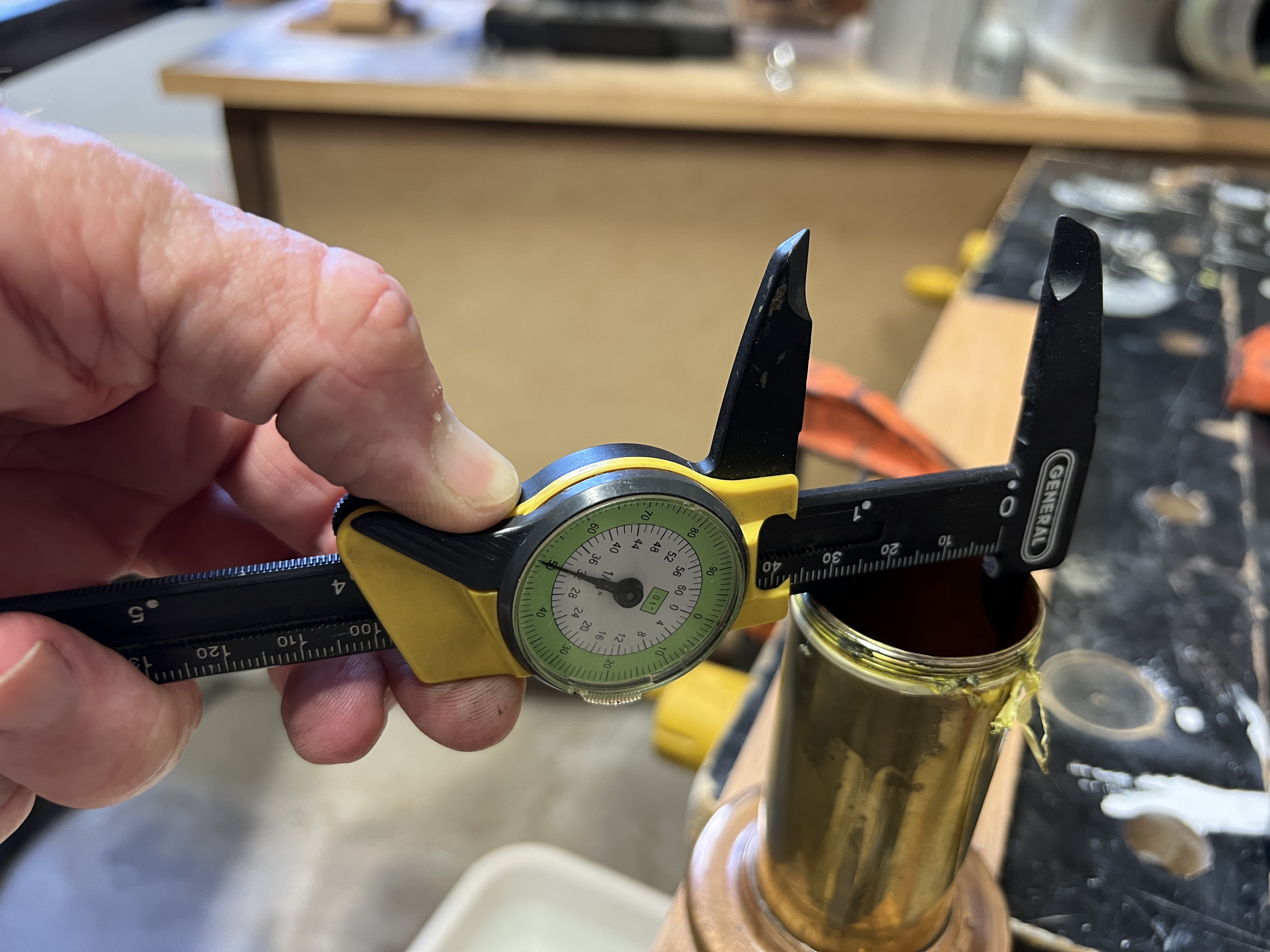

Diameter of pump Barrel

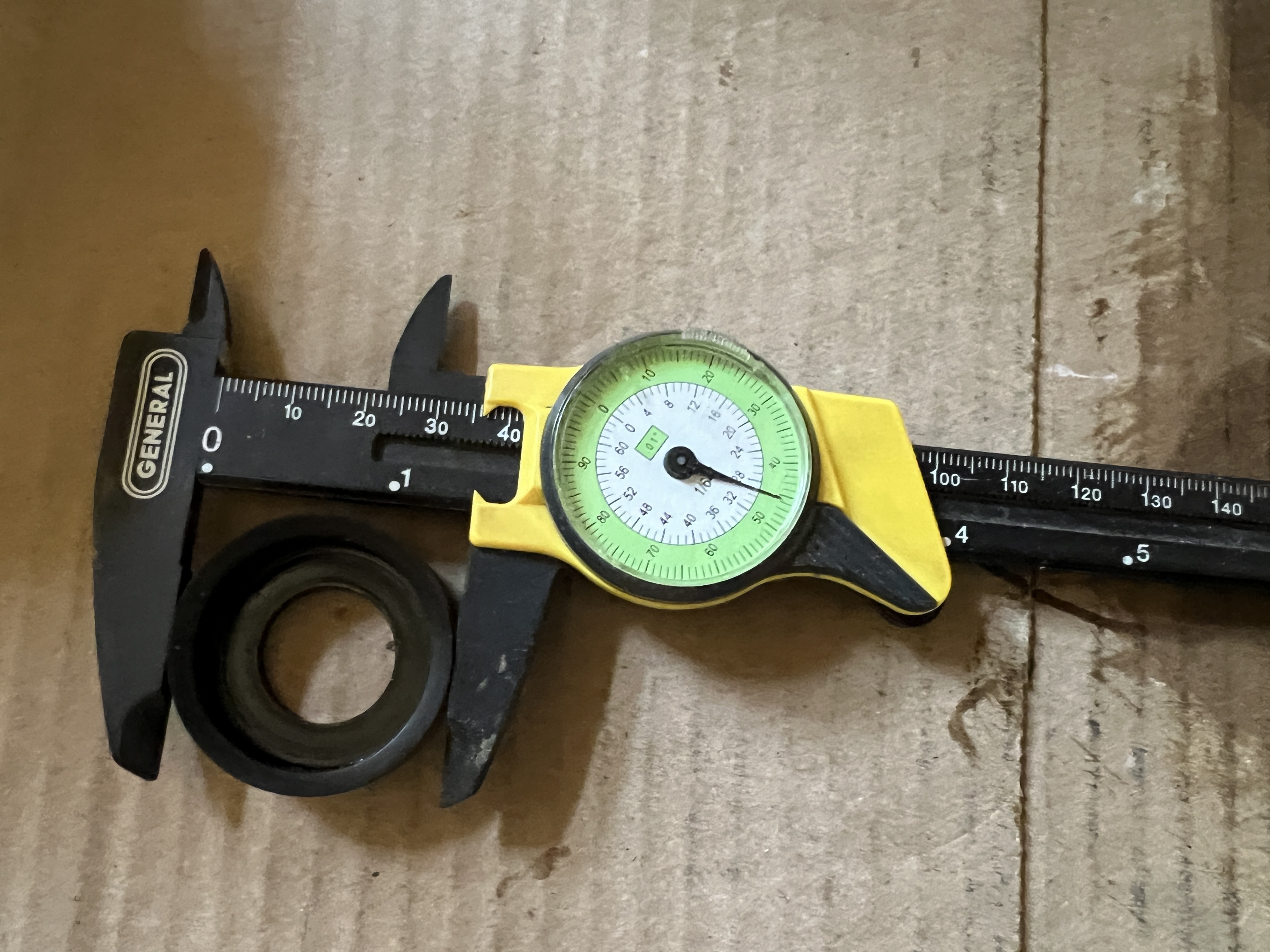

Diameter of nitrile rubber cup

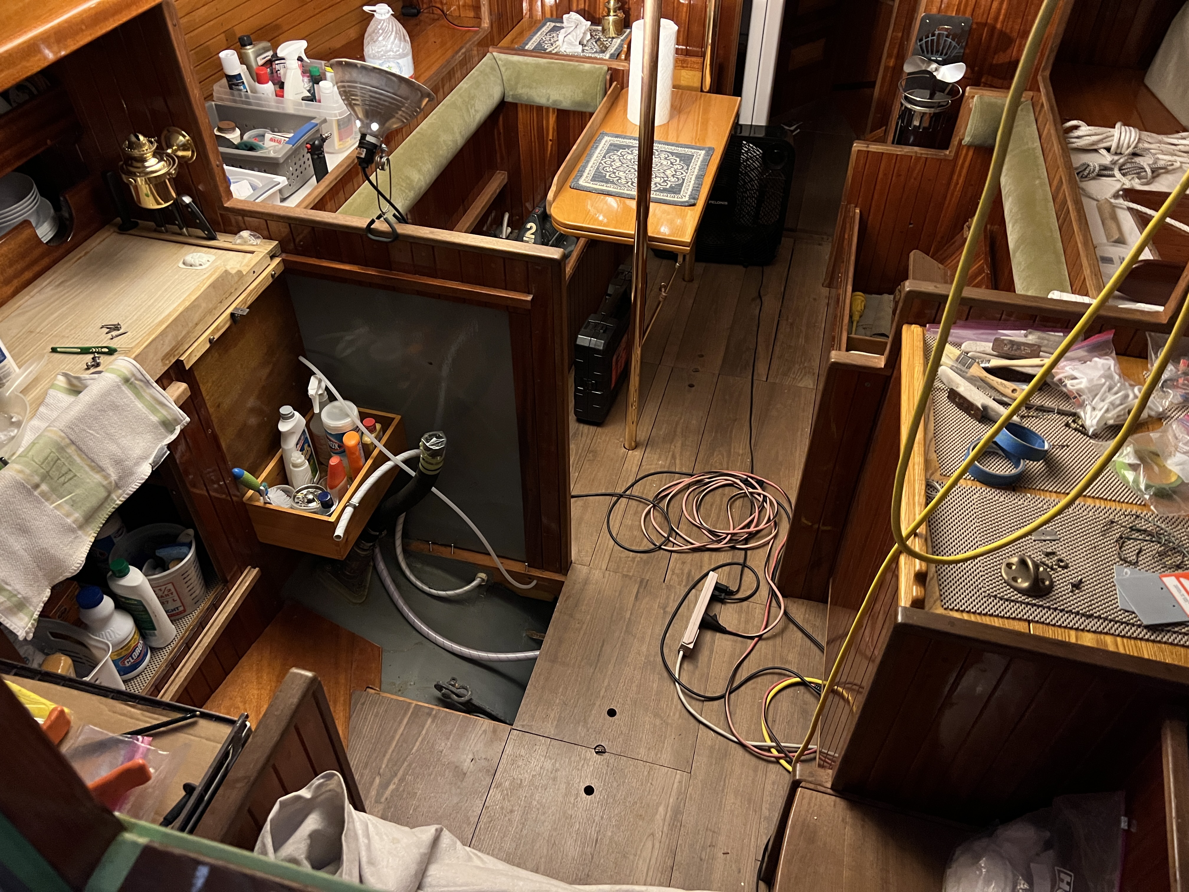

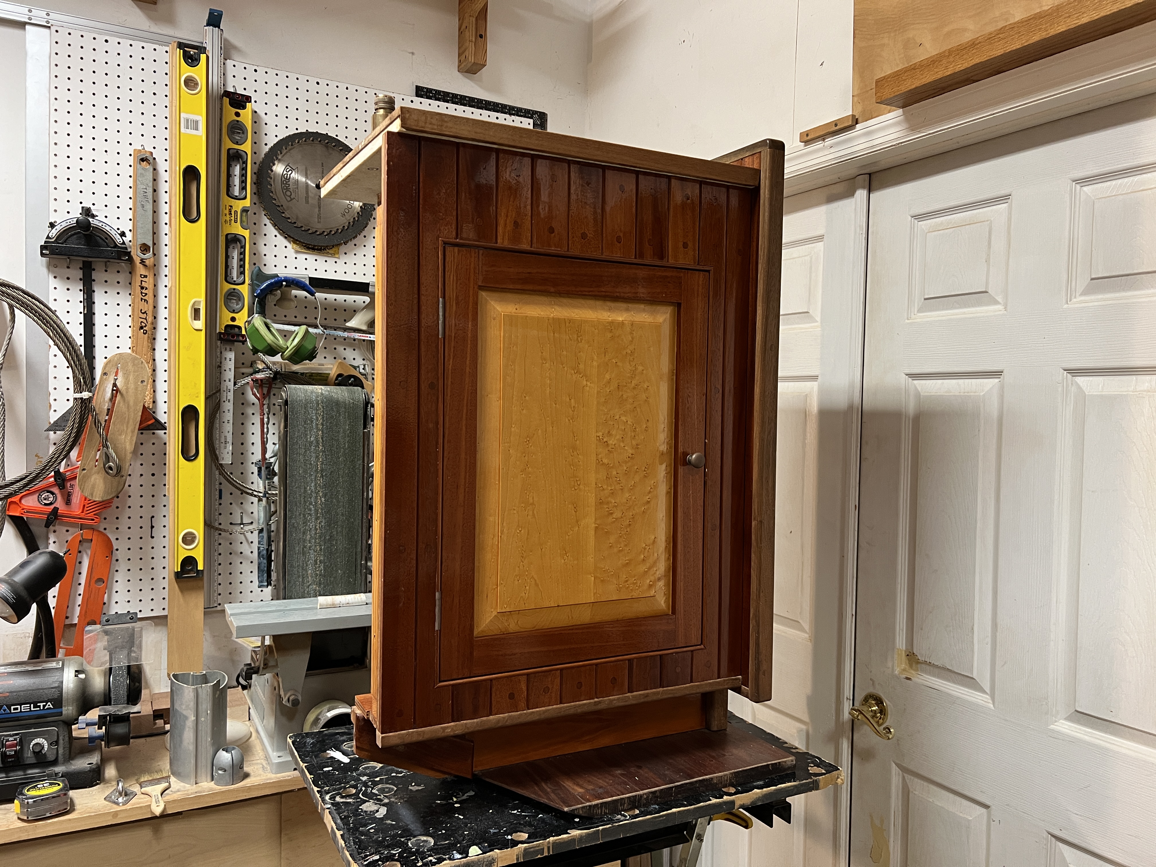

Chaos in the Far Reach....
Testing the concept....
Much easier to work in the shop.

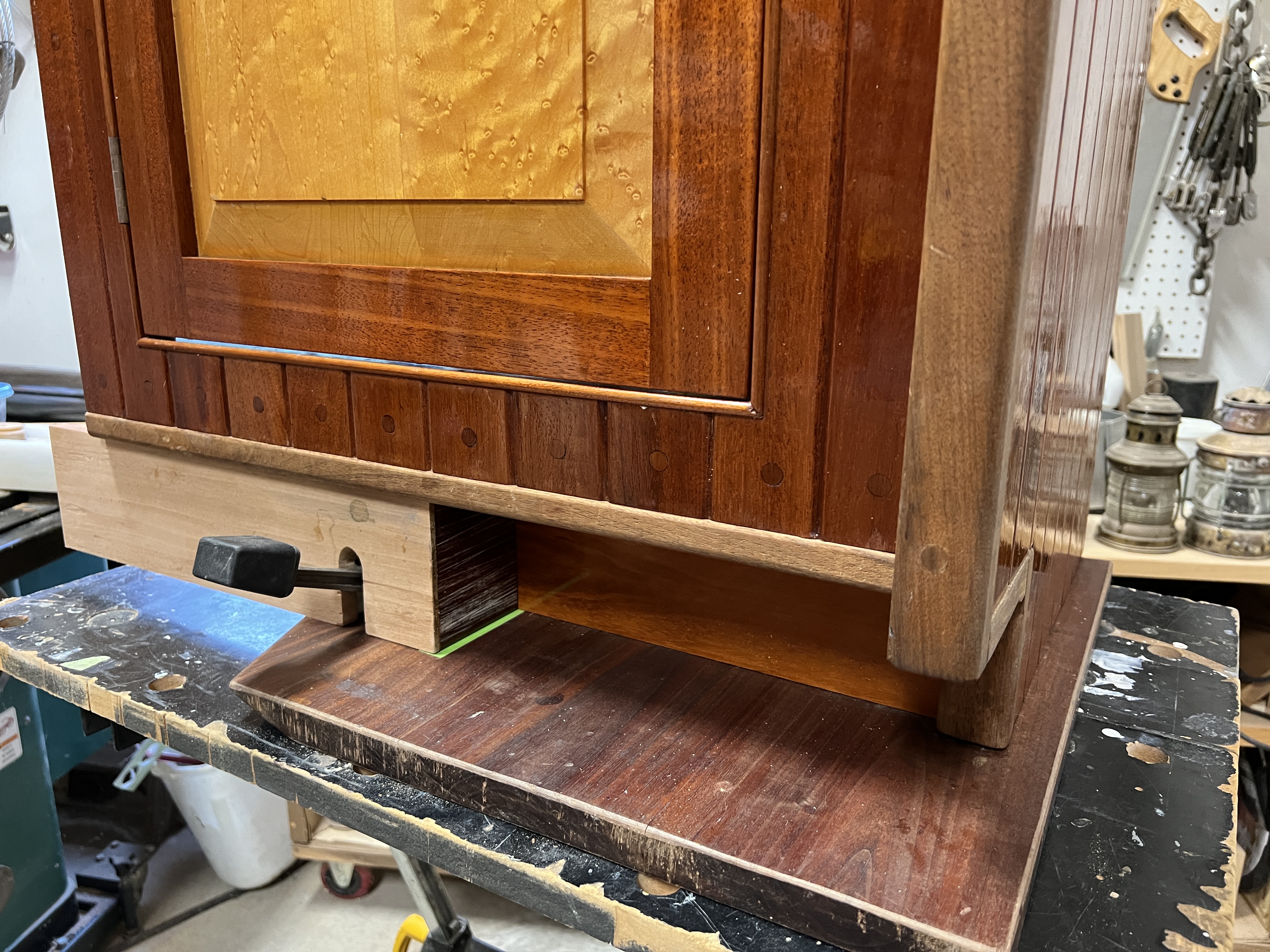

Test fitting.
Test fitting.

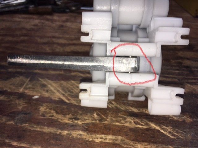

Just an FYI -
I had to replace the Whale Gusher Foot Pump (WHAGP0550) in Felicity's galley back in 2020.
The old one was leaking badly from the area shown here (this is the underside of the pump):
It worked well for one year but then the new one started leaking from the same area.
The pump has a five year warranty and the distributor replaced it free of charge.
The replacement lasted about 2 years and again the distributor replaced it free of charge.
It developed a dripping leak when used.
It leaked from the same area of the pump as the prior one.
So now I have the third pump and it is working well with no leaks since August.

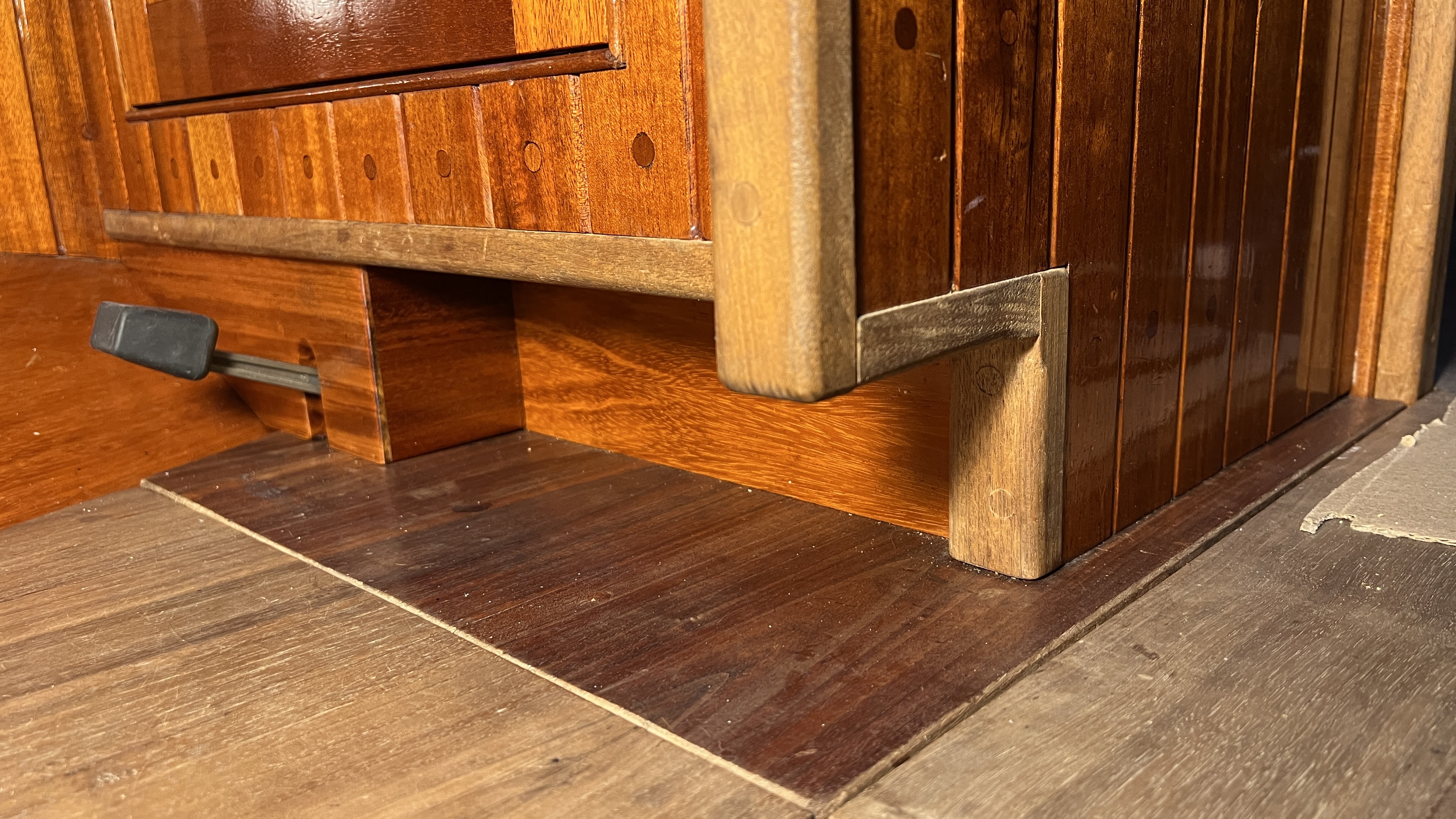

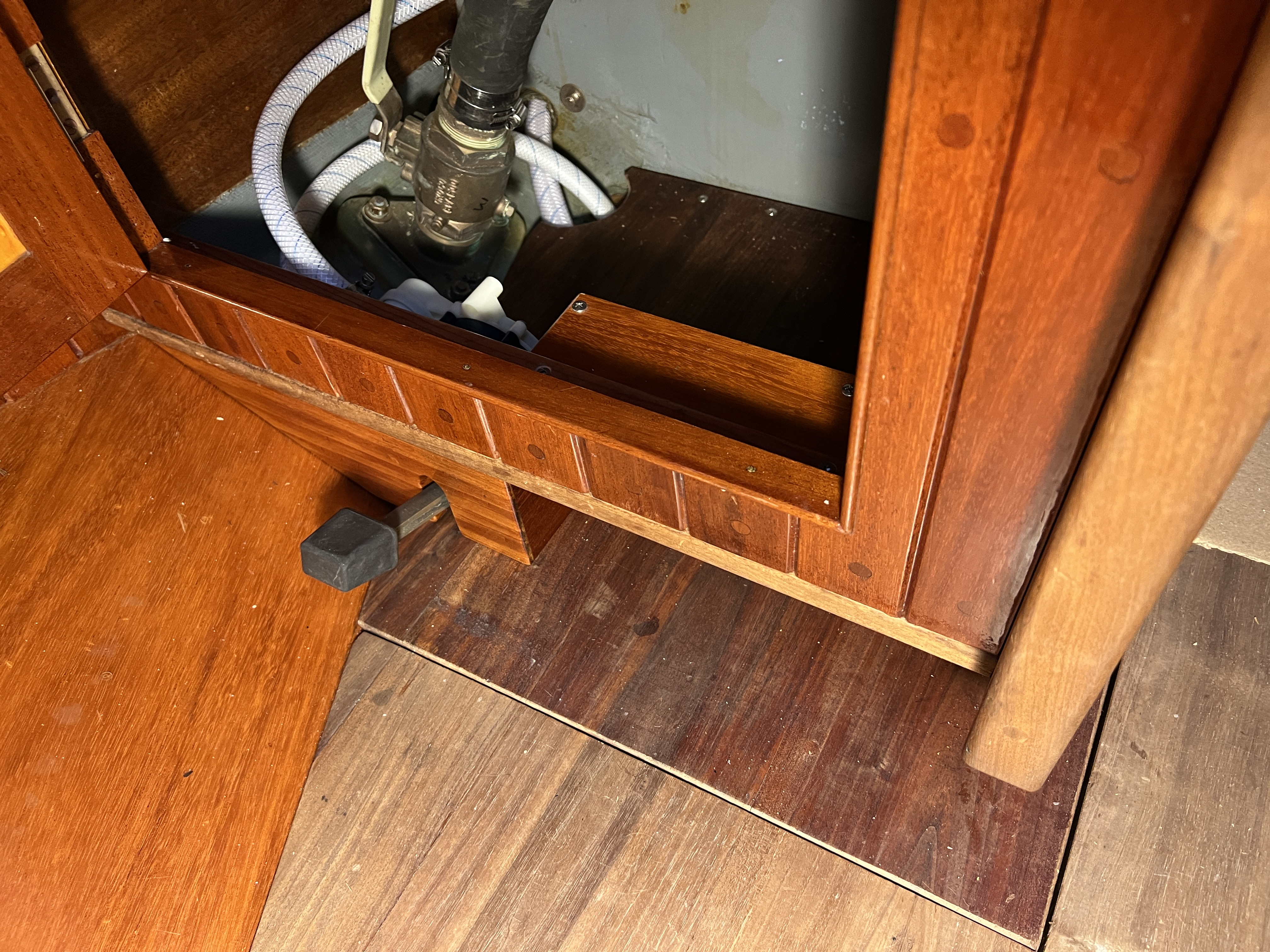

I completed reinstalling everything back into the boat. I think it turned out very nice. I'm pleased and looking forward to trying it out with the boat in the water.
