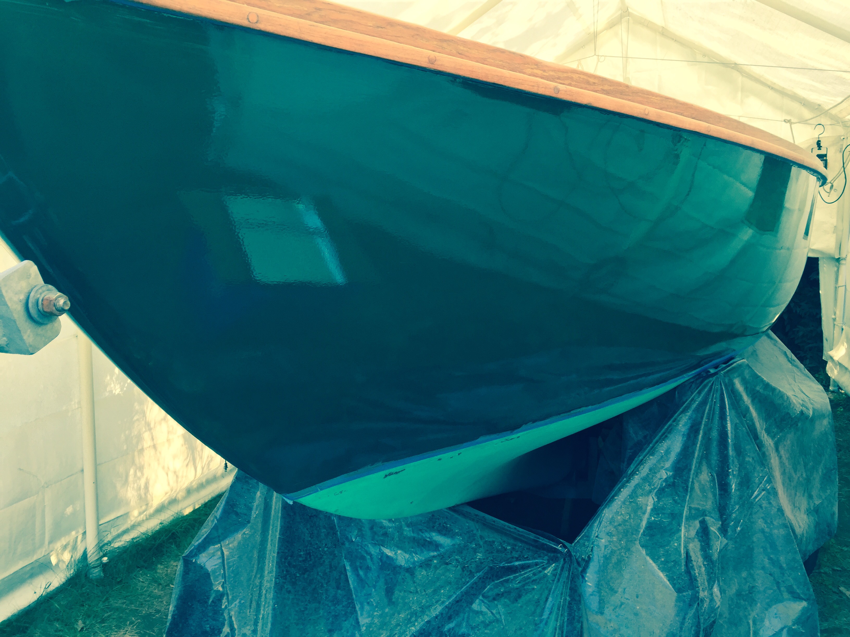

Re: Topsides in primer...
WOW! Way more sanding than I anticipated. 120 grit, then 220. Finally some green!

- Posts: 617
Lookin good RLW can't wait to see more. I like the work-tent!
Skeep
Skeep...The "boat barn," as I call it, is a cheapy by King Canopy (10x20). I used to keep 3 small boats in it for the winter until I bought CARAL. She just fits; the trailer doesn't quite! I like it because it is right next to the garage, so I have tools, power, compressed air, etc. When I had a CD 28 I had a larger, round top RV style version which was fantastic! Made boating a 12 month hobby! It was tall enough that I could stand straight up in the cockpit. A couple of 4' fluorescent shop lights suspended from the ridge and it was like daylight in there!
The first coat of Brightside is not quite as smooth as I was hoping for, but passes the ten foot test. I'll sand between coats as per the instructions, apply the next 2 coats very carefully (and thin), and see if it improves. Overall I am very satisfied so far. Does your TY live in the water or is she trailer sailed? If in the water, how is your paint holding up, especially the stern quarters that are nearly horizontal and often wet? Rich

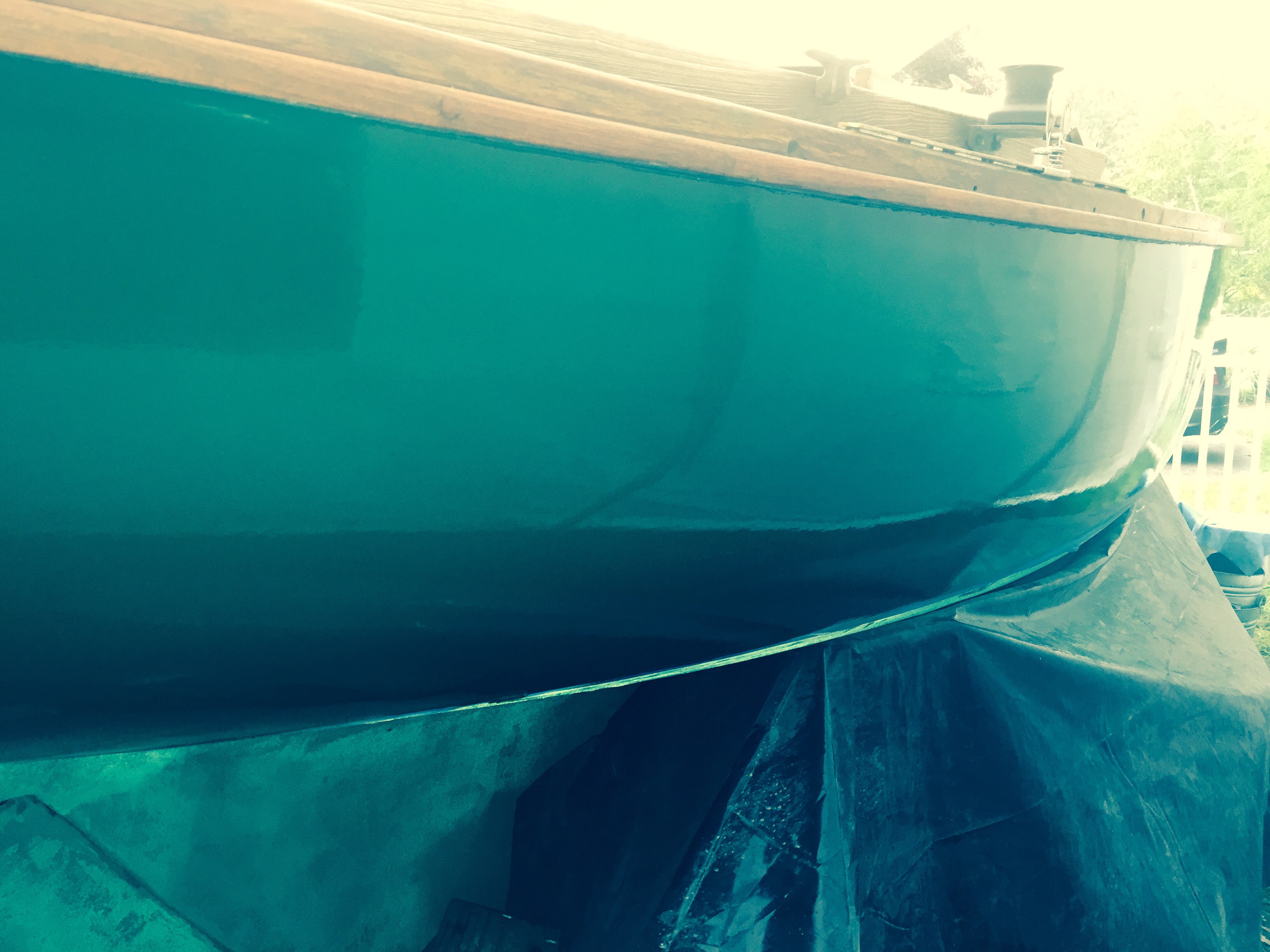

...the second coat is looking better. One more to go.
