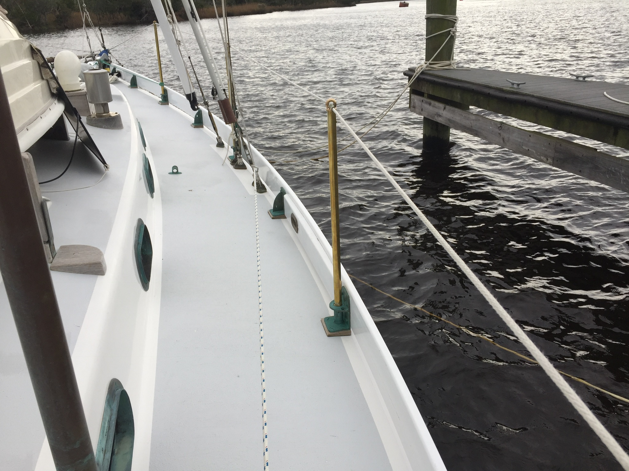

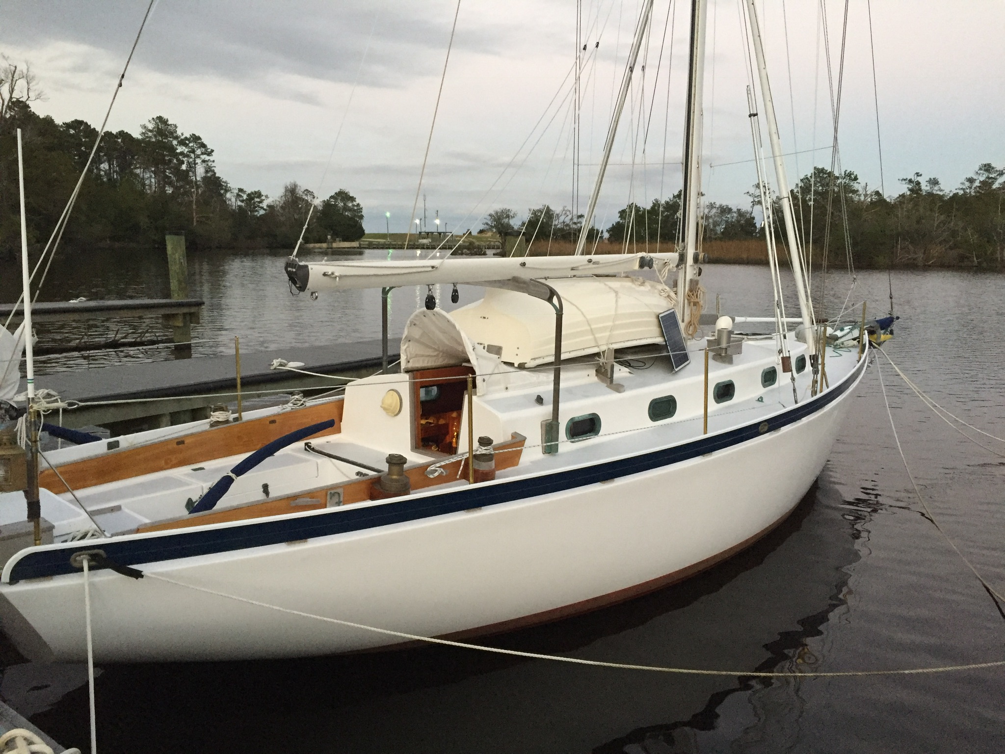

Most boats under 40’ built during the era of our Cape Dories all seem to have 24” tall stanchions. I have always felt 24” is too low for offshore sailing...especially if you find yourself on the lee side. Though I managed with the original stanchions just like everyone else I alswys wanted to upgrade them to 30 inches. I finally tackled the project this past week. I have not sailed with them yet but just being on deck feels much safer. Couple pictures below. Click on the link for the details of the installation. Total cost for the heavy duty brass tubes and solid bronze top fittings from Port Townsend Foundry was $840.
https://wordpress.com/post/farreachvoya ... s.com/1267
The new stanchions have a sidewall twice as thick as the stock stanchion and are 30” tall.
The brass tubes will change color to a burnished bronze brown matching the gallows frame.

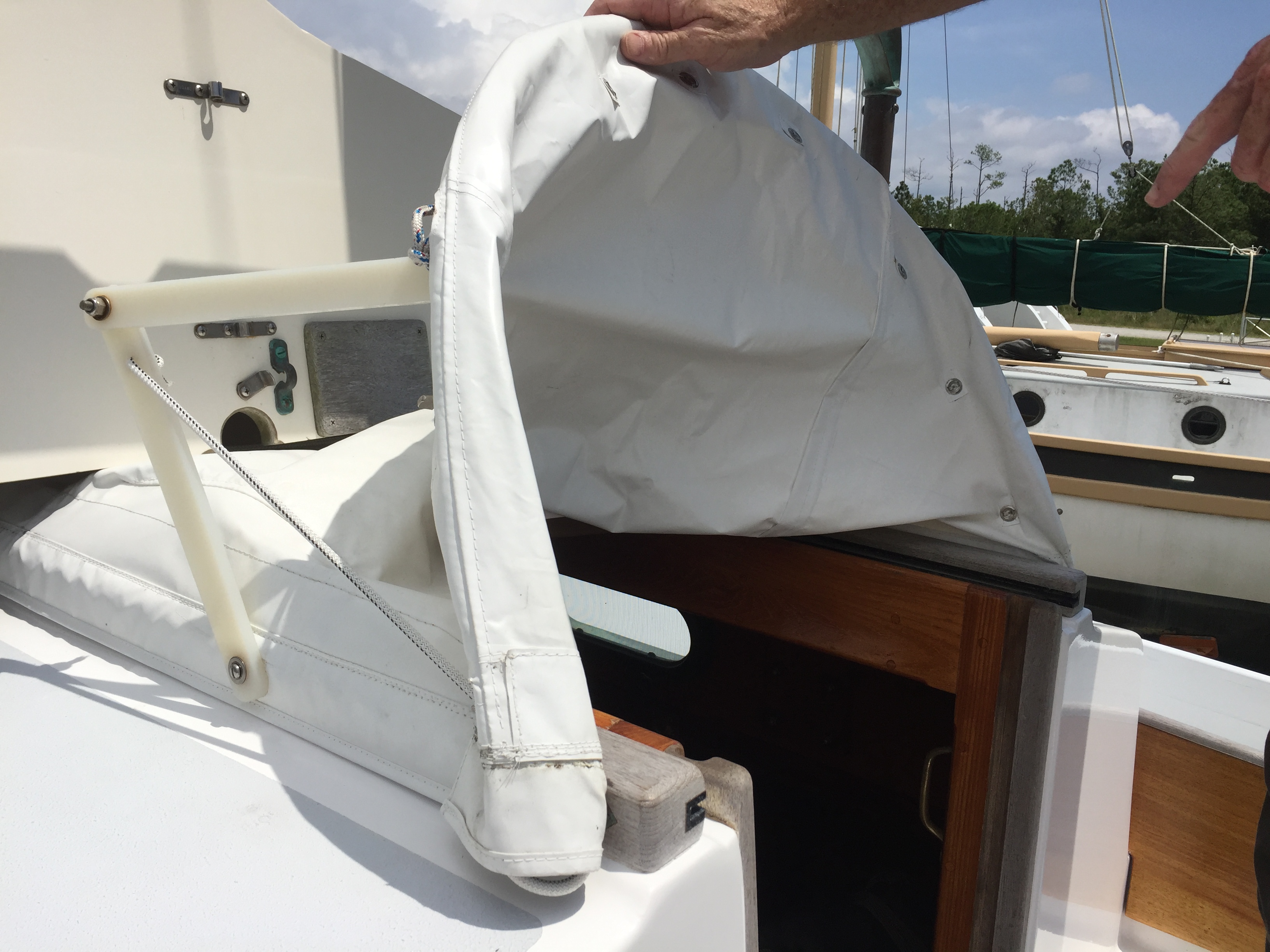

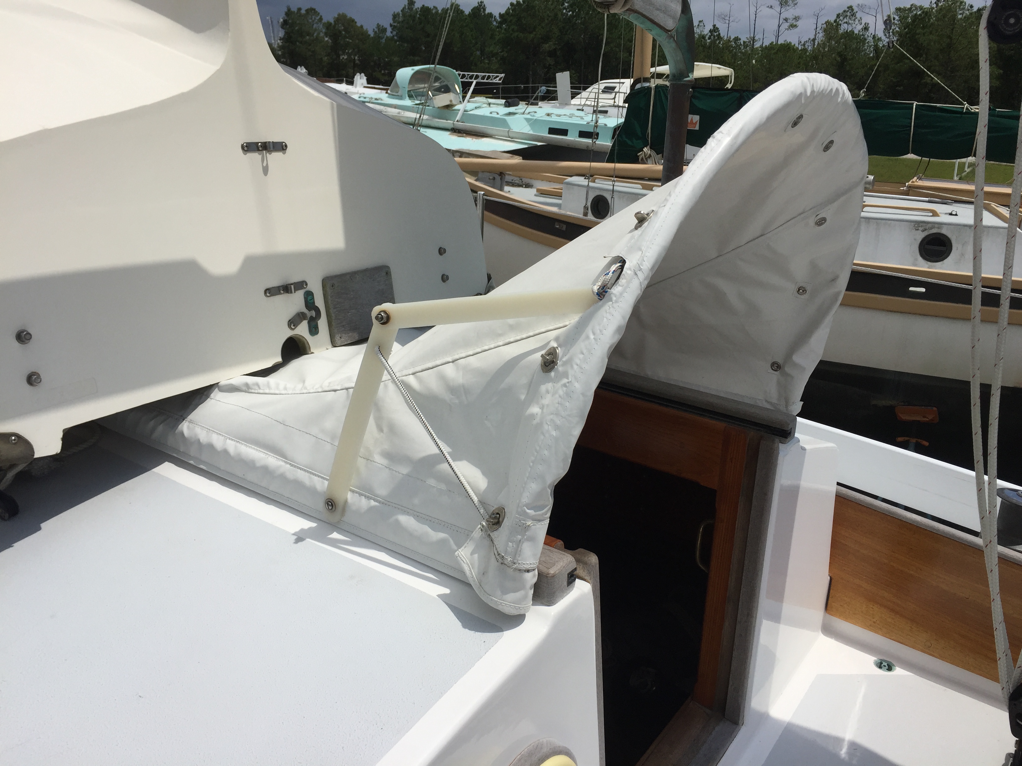

Regarding the dodger installed on S/V Far Reach, do you have instructions on how your made it or where did you buy it??. Would like to install something similar on my CD25D-Juno. Does it has ss tubes?? By the way, stanchions look awesome...
Thanks
Carlos
Posts: 3664
Re: Installing Taller Off-Shore Stanchions
Hi Carlos. Thanks. Glad you like it. Smase it myself. Super simple. Uses black irrigation tube I purchased at Lowe’s. Four pieces of UHMW plastic and some shock cord. The material is stamoid. You simple push it forward to make entering and leaving easier.

Hi again John
Looking at the pictures of the dodger, how do you hold it still on top of the companionway while navigating??? Is it screwed to the wood???
I would appreciate it your response
Carlos
Posts: 3664

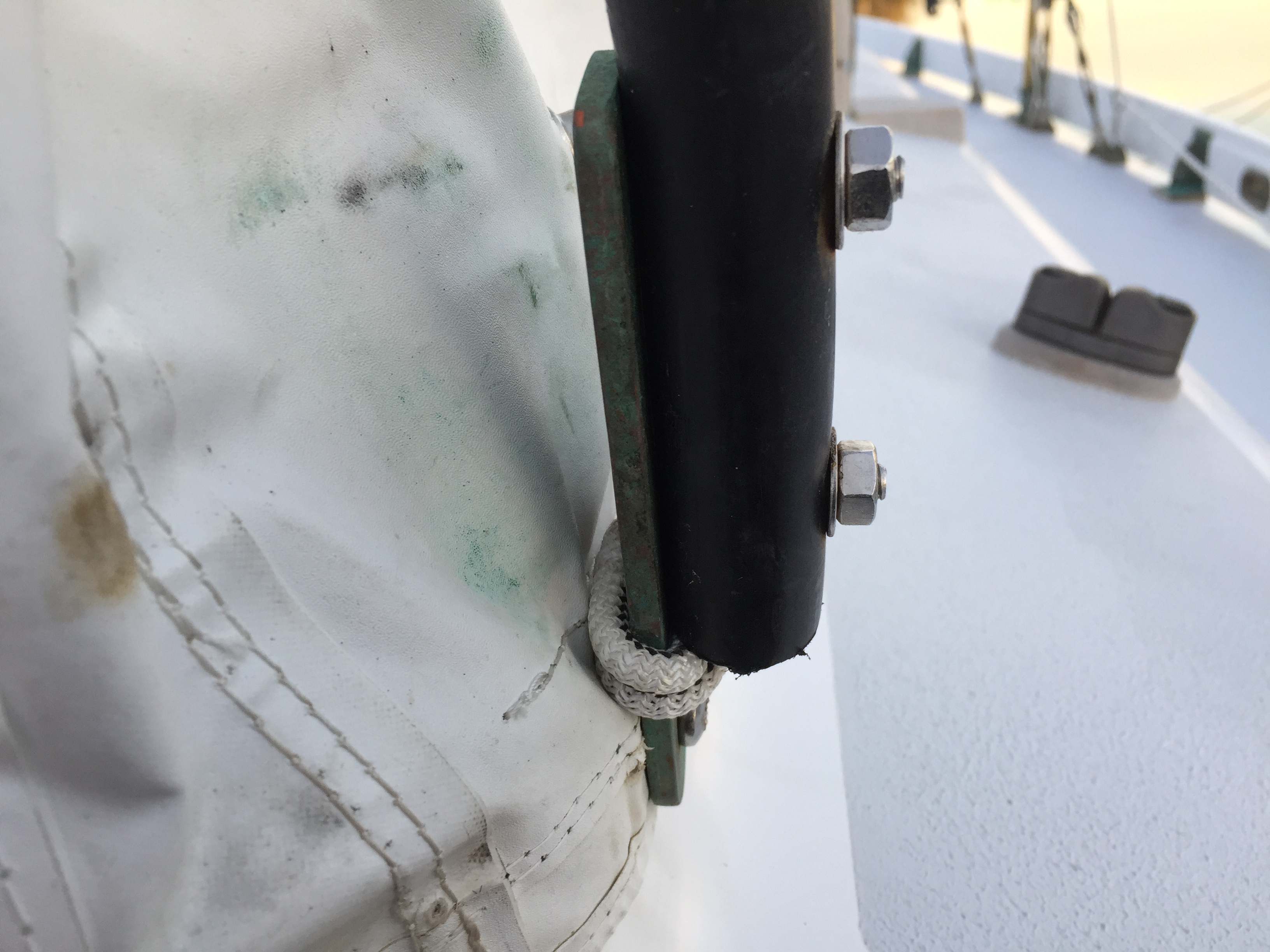

Carlos, I cut a piece bronze about 4” long and 3/4” wide and secured it to the end of the irrigation pipe with a couple 1/4-20 fasteners. Then, I secured the pivot point to the bronze insert I installed into the teak with a 1/4”-20 machine screw. See the link and scroll down to the part of the pram hood.

Two photos below how the ends of the hoop fit into the bronze inserts I set flush in the teak rails. The picture of the insert is in the link I provided above.
