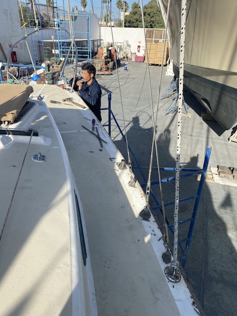

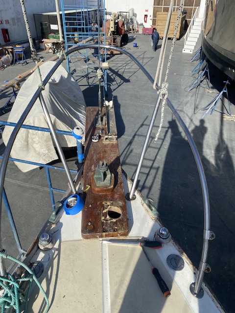

Toe and rub rail are coming off easy. They think the bowsprit doesn’t need to come off and the seam is different there covered with a solids plate. I dont know. It’s not that hard. I should make them remove it. They are not unstepping the masts either they want to glass those places by the chain plates one at a time while securing the stays on cleats. I think that will be ok.

Hi Jim thanks for the response. No need for wedges. After they removed the screws the rails just fell off. Demo is done they are erecting a tent now.

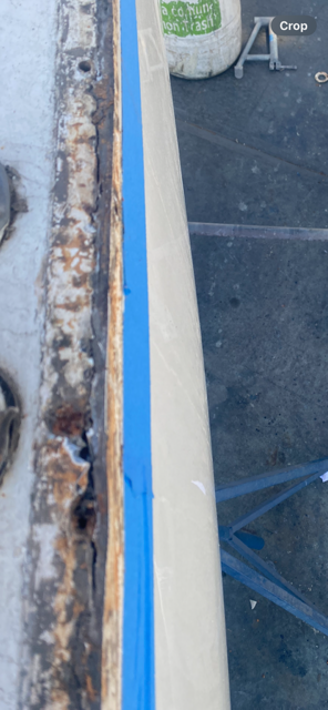

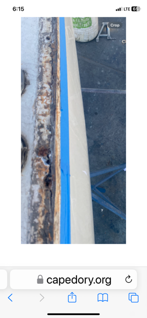

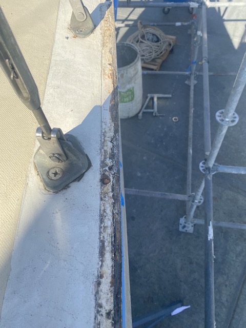

Here are some pics of what is probably a major source of the water intrusion. The hull deck joint is seperated. I need to keep an eye on these guys. They already rebedded one of the backstay plates. They are supposed to remove them and glass under each one and the entire perimeter of the boat. They thought they could cut around them.
Posts: 3388
Re: Leoma hull to deck joint
Wow. When you consider the fact that on most long passages, even with minimal spray flying, that separation would intermittently seep water 24 hours a day. To say nothing if you were heeled over on that side it would be a steady flow. It certainly didn’t help that the bedding compound for your toerail seems to have hardened and lost all usefulness at some point in the past. This project should pay huge dividends going forward. Good luck.
Posts: 3648
This is the best thing anyone can do for their boat. Good job. I would remove the bow sprit if possible. I had major deck hull separation there. Yes keep and eye on them. No short cuts giving all you are doing. If done right you won't believe the difference this project will make in the strength and livability of Leona.

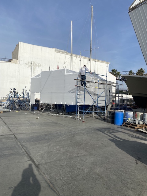

I was a little dissapointed cus it’s taking two weeks putting up the tent. They had the structure up them took it down and started over. They must have psychic abilities. The manager just came up and told me I wasn’t being charged for the tent. Nice.

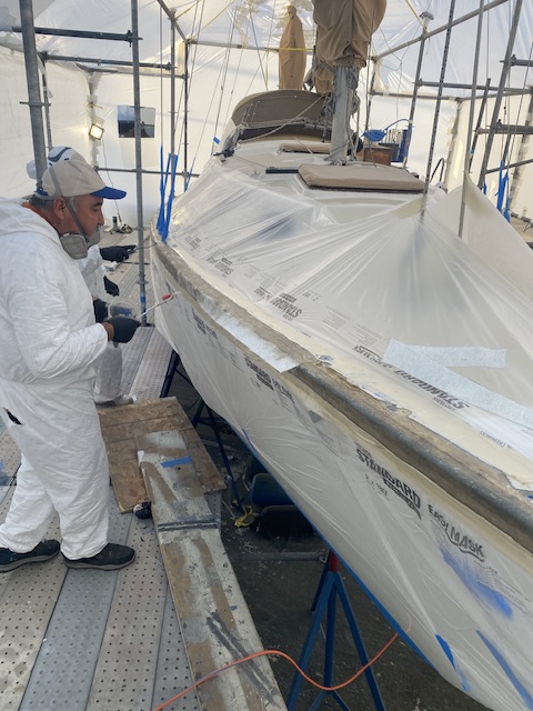

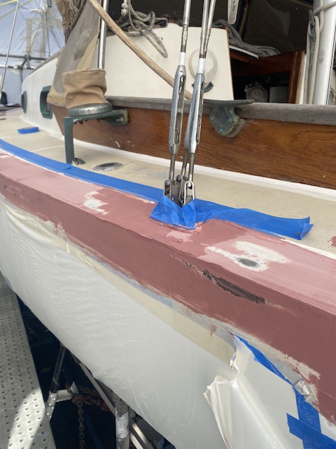

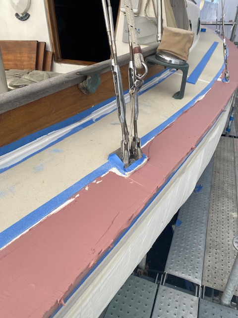

They are fairing it out pretty good. I’m glad to see the plugged all the holes. They aren’t using the biaxial material I provided. They say it requires too much grinding and will cost so much more. I give up. I know they do nice work. I guess I was expecting too much. I think they will start laying glass tomorrow

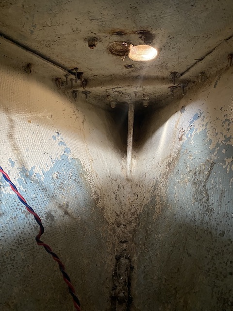

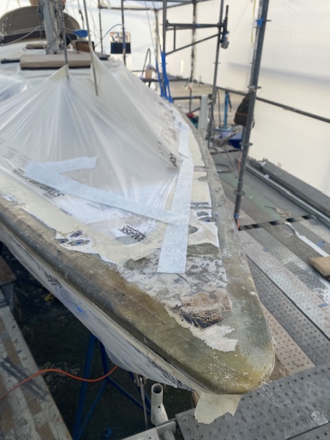

I can’t complain. They are doing good. A 2” strip and a 4” strip. I talked to the boss and he says all I had holding it togeather was a few 50 yr old screws and the old mastic. It should last the rest of my life.
I really glad I removed the bowsprit. This will be much better

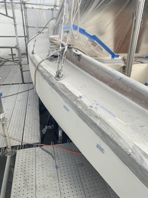

Applying several coats of fairing compound. I really wish they’d unstep the mast and finished it consistent all around. Cutting around the chainplates is almost like they will be recessed a little. Oh Well. I’m not gonna tell anyone. I looked up the cost to R & R the two masts it was $1800 at San Francisco. I think that included rebedding the chainplates padeyes. This yard allready rebeded them probably cost half that
