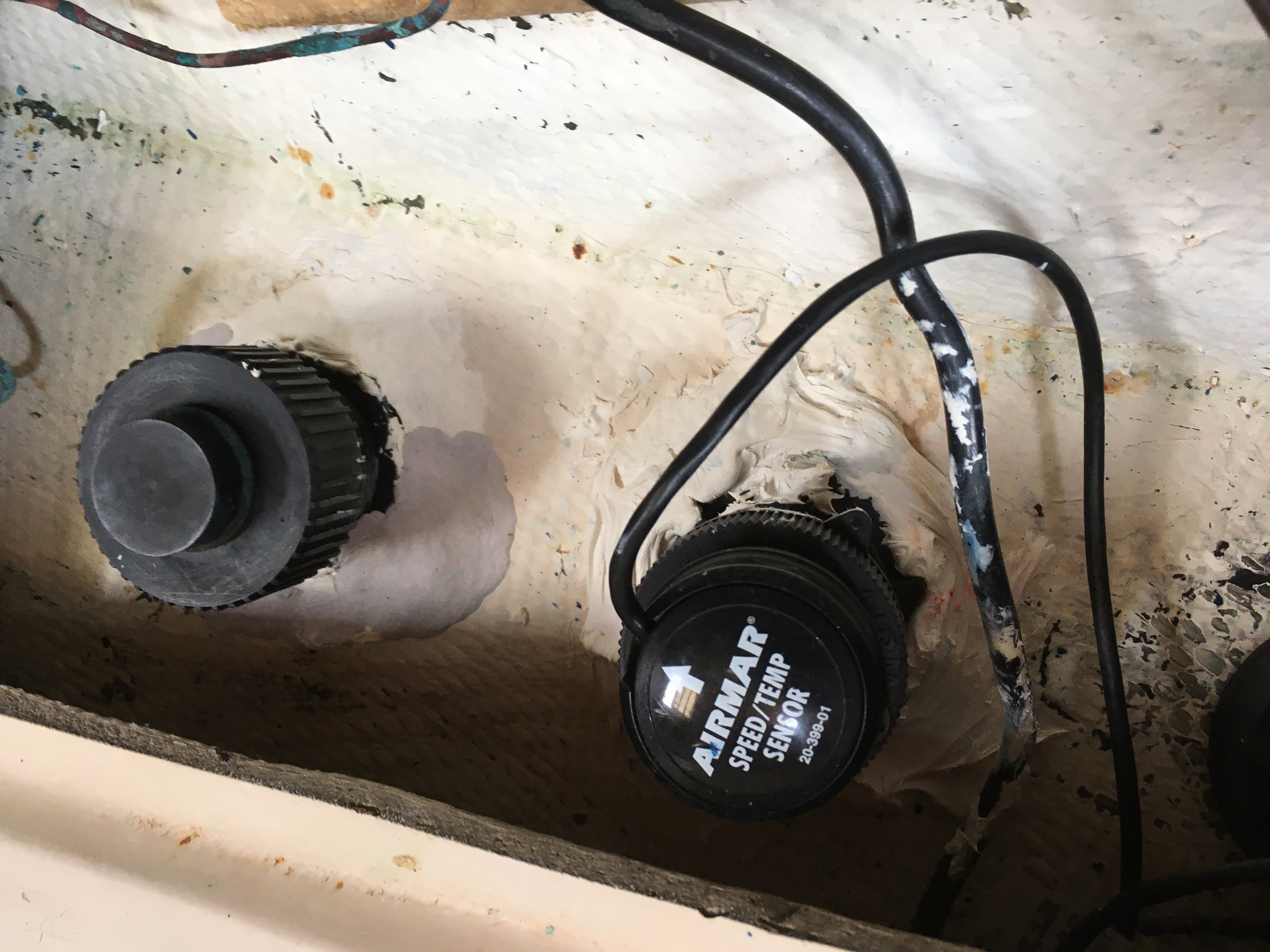

There were actually two transducers that leaked.
Last year they leaked a very small amount after the boat was launched.
I was able to stop the leak completely using Flex-Seal putty.
The stuff advertised on TV.
I just smeared it on from the inside of the boat.
Surprisingly it worked even though the boat was in the water and the leak was active.
But it's in no way a long term repair.
I did go to my local Raymarine dealer and they were not able to order the replacement parts for the thru-hulls (although I was able to find a source online for replacing one of them based on the part number).
So I decided to reuse the existing parts.

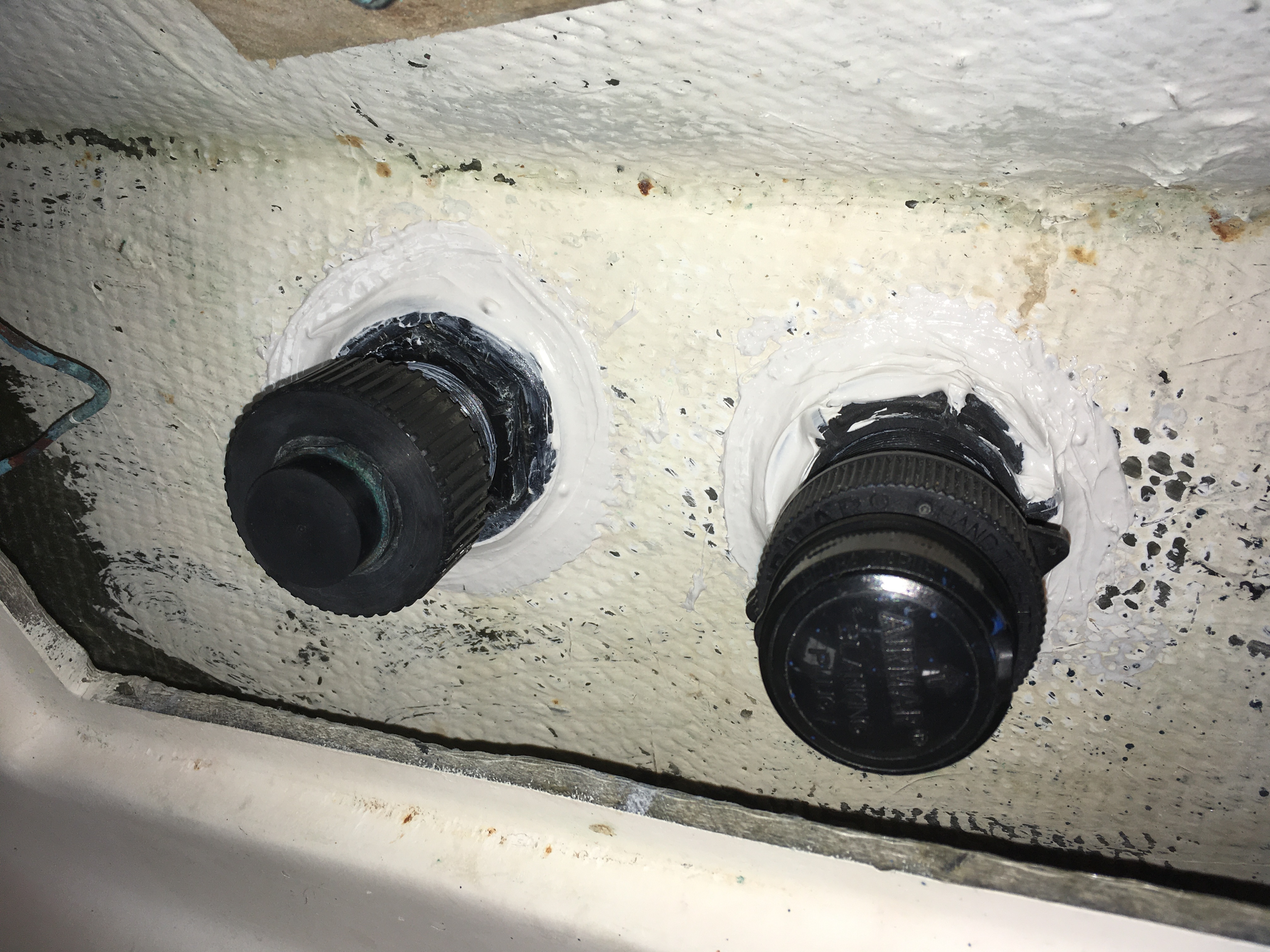

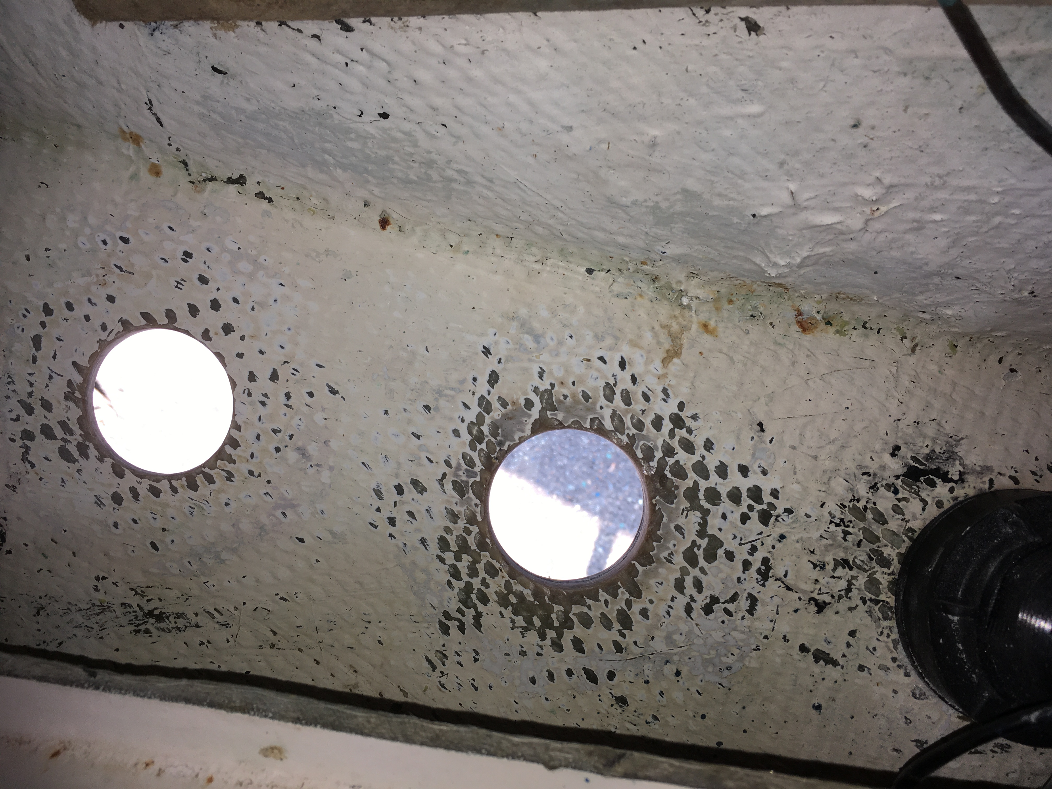

I was able to easily remove the two Transducers.
It seems there was very little sealant used when they were installed.
I thoroughly cleaned up the thru-hulls, the holes and the transducers.
Then re-bedded all with 4200.
The inside view is shown but rest assured that the thru-hulls were properly sealed with 4200.
The bit shown here on the inside is just for the heck of it.
