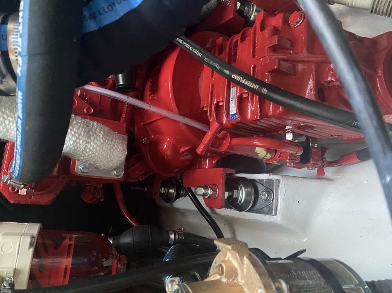

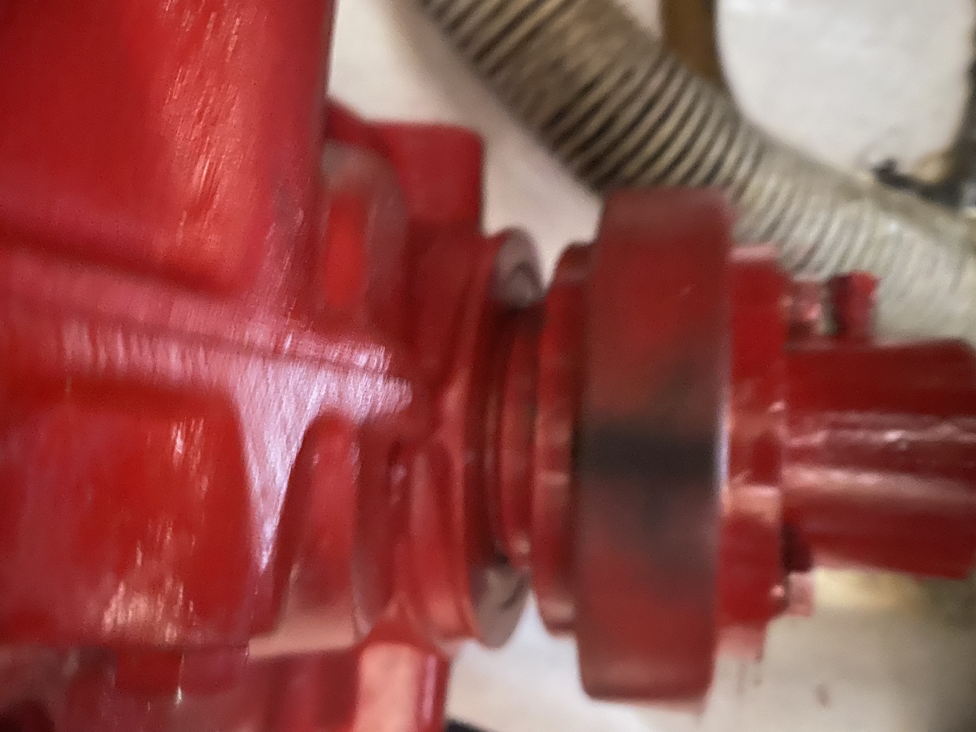

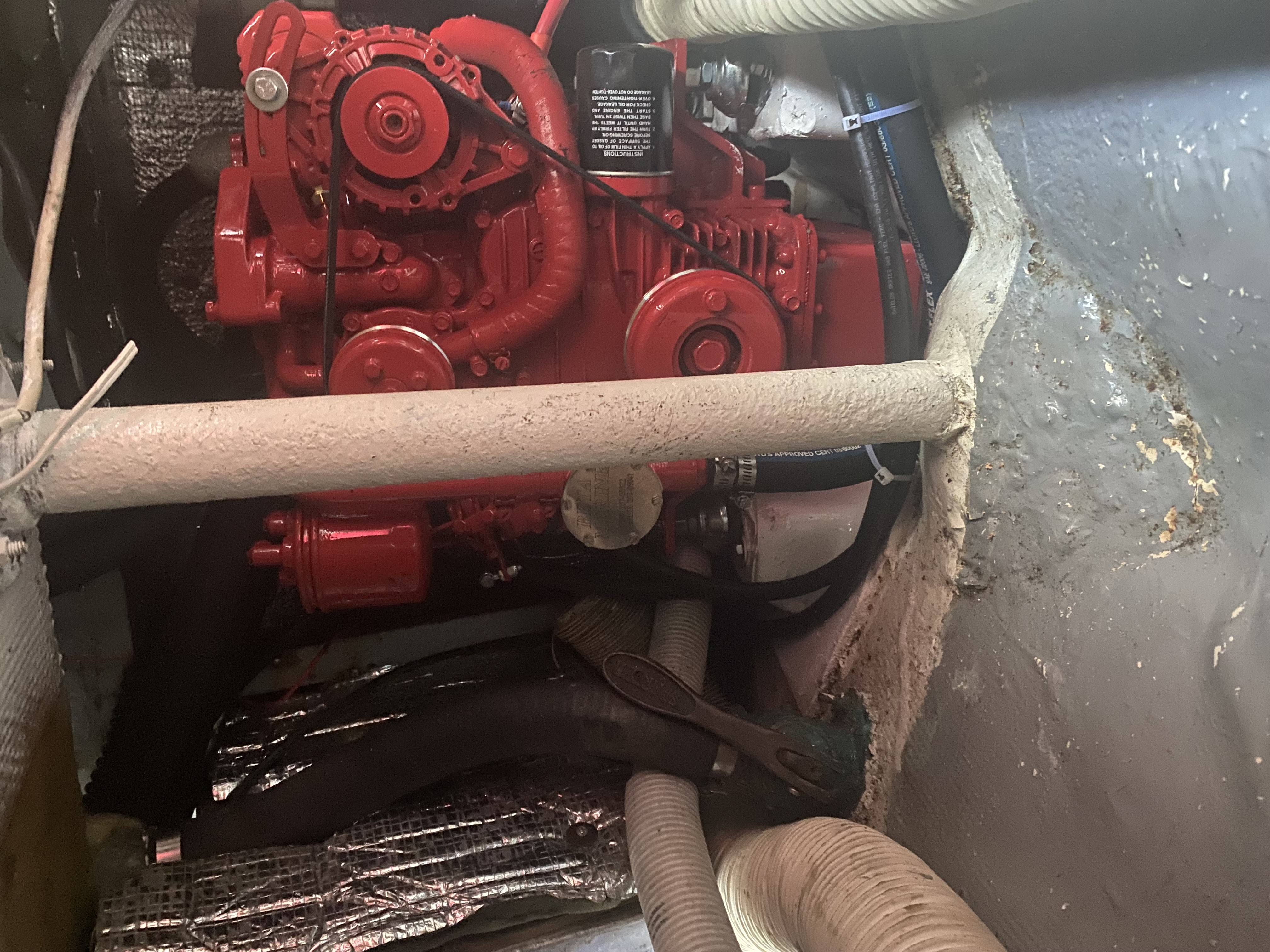

Almost done with the install. Still need to hook up the new racor filter , the instrument panel, and a few other things.. the v-drive is strange It's a ZF M15.. the shaft runs all the way thru and connects with that coupling at the front of the photo. I have to ask the mechanics but I think that is where you use feeler gauges to align the shaft??? Surprisingly We didn't need to modify the shaft at all. We just had to restore the stringers to the original setup . I wasted alot of money fooling with that old Volvo. Oh well at least I got plenty of use out of her.
I hope they can secure all those hoses over away form the oil dipstick and the pump. It looks like it will be difficult to use that pump for changing oil. It on the right side under those hoses

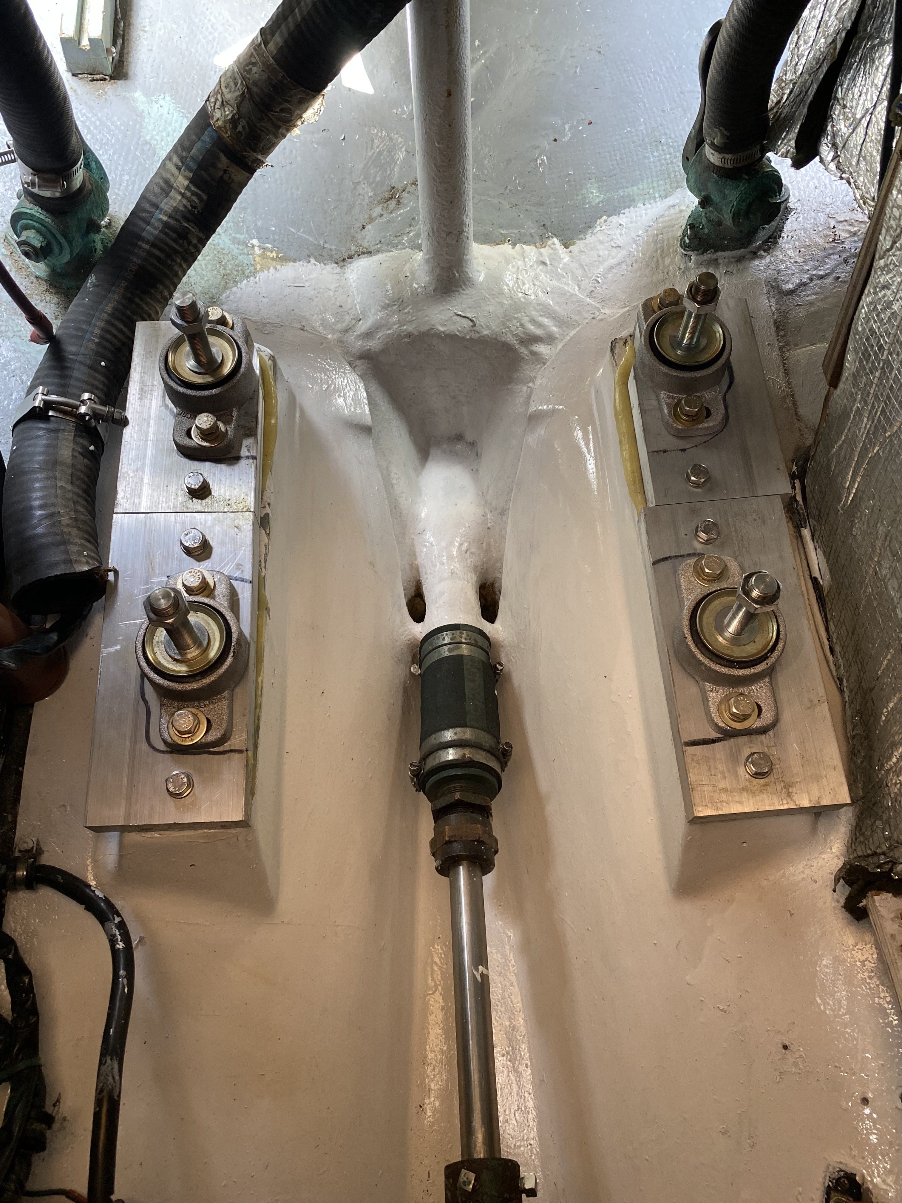

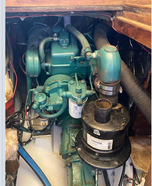

After doing much modifying of the stringers for the old Volvo. This photo is of what we did for the Volvo. We ended up restoring everything back to the original setup ( see previous photo) They just have a 3/8' shim under the forward mounts. I like how the mount adjusting nuts are centered on the studs unlike the first attempt by the previous boatyard. They left them up all the way to the max. The after mount nuts are lower. It seems to me that the motor would be more secure and not sway as much if they were topped out. Here is a photo of what We did for the Volvo last year.. Yea I'm kinda dumb.. I spent a lot of money .. At least I helped some people be employed.
motor mounts after.jpg (2.58 MiB) Viewed 2994 times

JD-MDR wrote:I hope they can secure all those hoses over away form the oil dipstick and the pump. It looks like it will be difficult to use that pump for changing oil. It on the right side under those hoses
It might be possible to move the pump from it's engine mount to a more convenient location.
Re: Leomas new Beta 16
:D He texted me and confirmed I have the upgraded 75 amp alternator and he is working on moving that pump

J.D. - I've always wondered - how do you service the stuffing box with one of those V-drives? I'm thinking
it must be tough as the engine is partly over it.
Frenchy wrote:J.D. - I've always wondered - how do you service the stuffing box with one of those V-drives? I'm thinking
Originally the stuffing box was half buried in the glass .. I extended it about 8". It has been easy to access with a plumbers tool. It seems a little tight now. I check it out tomorrow and find out if i can still get a grip on the it. I was feeling around the other day and it seems like it will not be too bad.
motor mounts after.jpg (2.58 MiB) Viewed 2948 times
Frenchy is right. I cant get under to service the stuffing box. Mechanic managed but said this boat is a prime candidate for a dripless type( maybe next haulout). I was a little disappointed : we tried for a sea trial yesterday but prop was hitting rudder. They took prop in to refinish and made adjustments including a damper between the couplings. That allowed them to push the shaft and prop in a little more . Seatrial went well this morning.
I thought we had this conversation on what order the prop lock nut and jamming nut go on. Both the diver and the mechanic wouldnt hear of it. They wouldnt even look at the link. Jim posted for us. Oh well. Ill reverse it next haulout. ( thin locknut first , right?). Also. I only had a 100 amp fuse on the battery terminal( supposed to be 250). They blew the fuse and told me it was ridiculous to have those. I went out and got what WM had (200 amp).Ill put it on myself after they leave. They moved the manual oil pump. Im happy with them. But not about to argue anything. I can fix those things myself. I may haulout in Mexico.

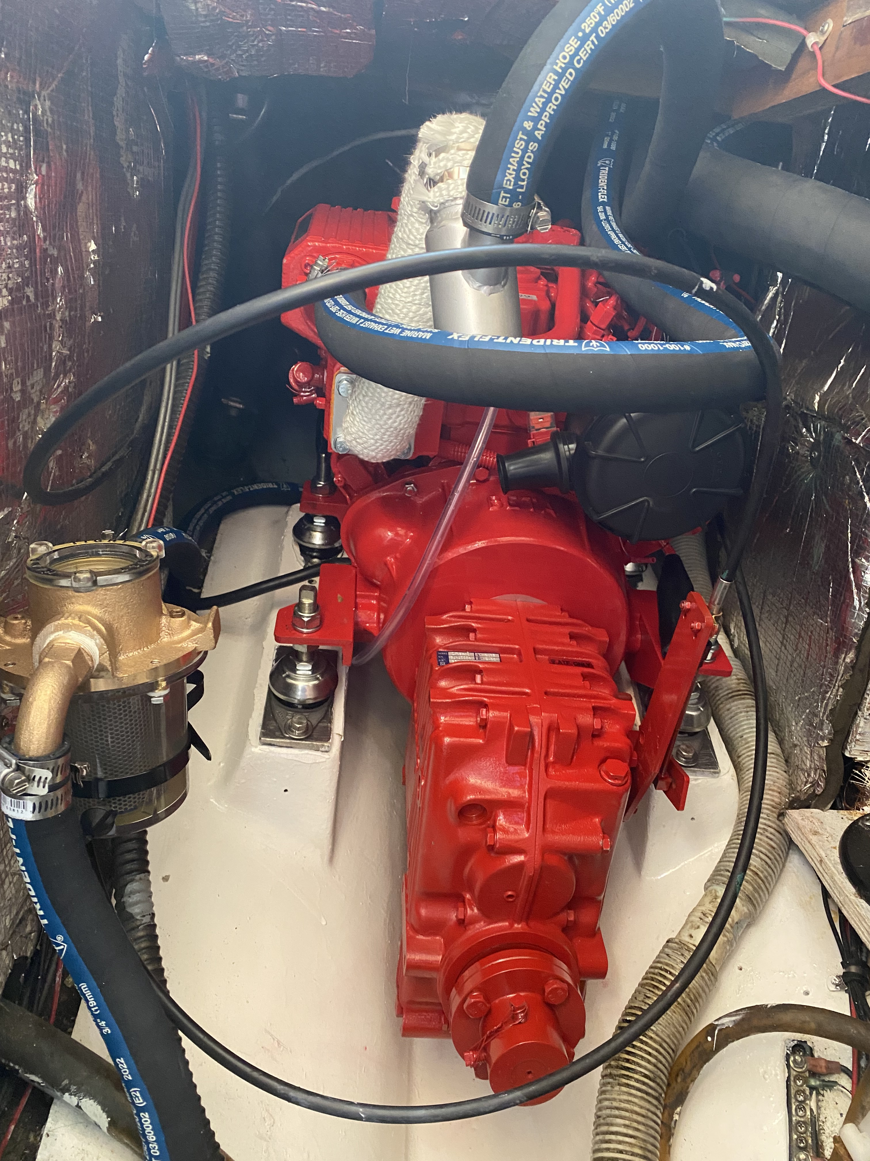

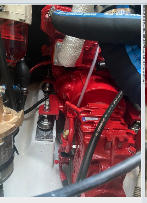

At the request of a member I am posting another view of my new Beta 16 Installed : The front view from inside the cabin and the "other" front view from inside the Lazeret.
Leoma is back at Home (Ventura ) . I had nice NE winds all the way up from San Pedro to Ventura
Screenshot 2022-12-25 at 14-43-21 The Cape Dory Board • View topic - Leomas new Beta 16.png
Screenshot 2022-12-25 at 14-43-21 The Cape Dory Board • View topic - Leomas new Beta 16.png (599.41 KiB) Viewed 2872 times
Beta 16.jpg (2.3 MiB) Viewed 2883 times

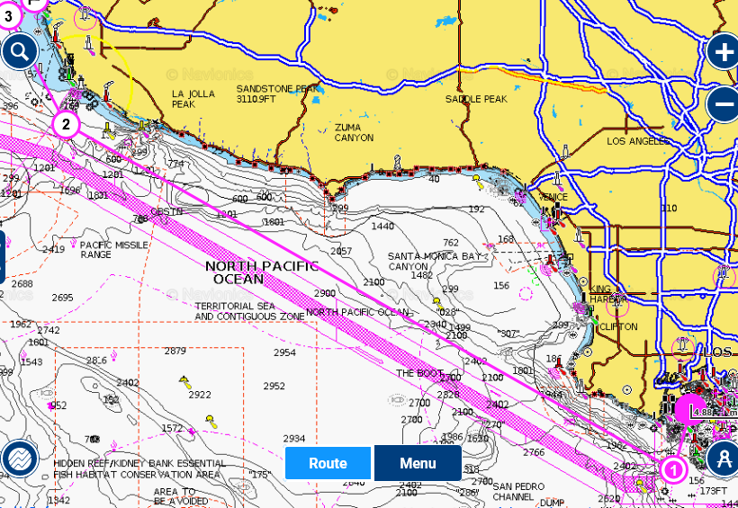

Here is a copy of my route home from Los Angeles harbor.. As you can see Northeast winds was perfect all the way home at 7 kts. Just inside (about 1 mi.) of the shipping lanes
Screenshot 2022-12-25 at 12-38-55 Navionics ChartViewer.png (347.56 KiB) Viewed 2882 times
