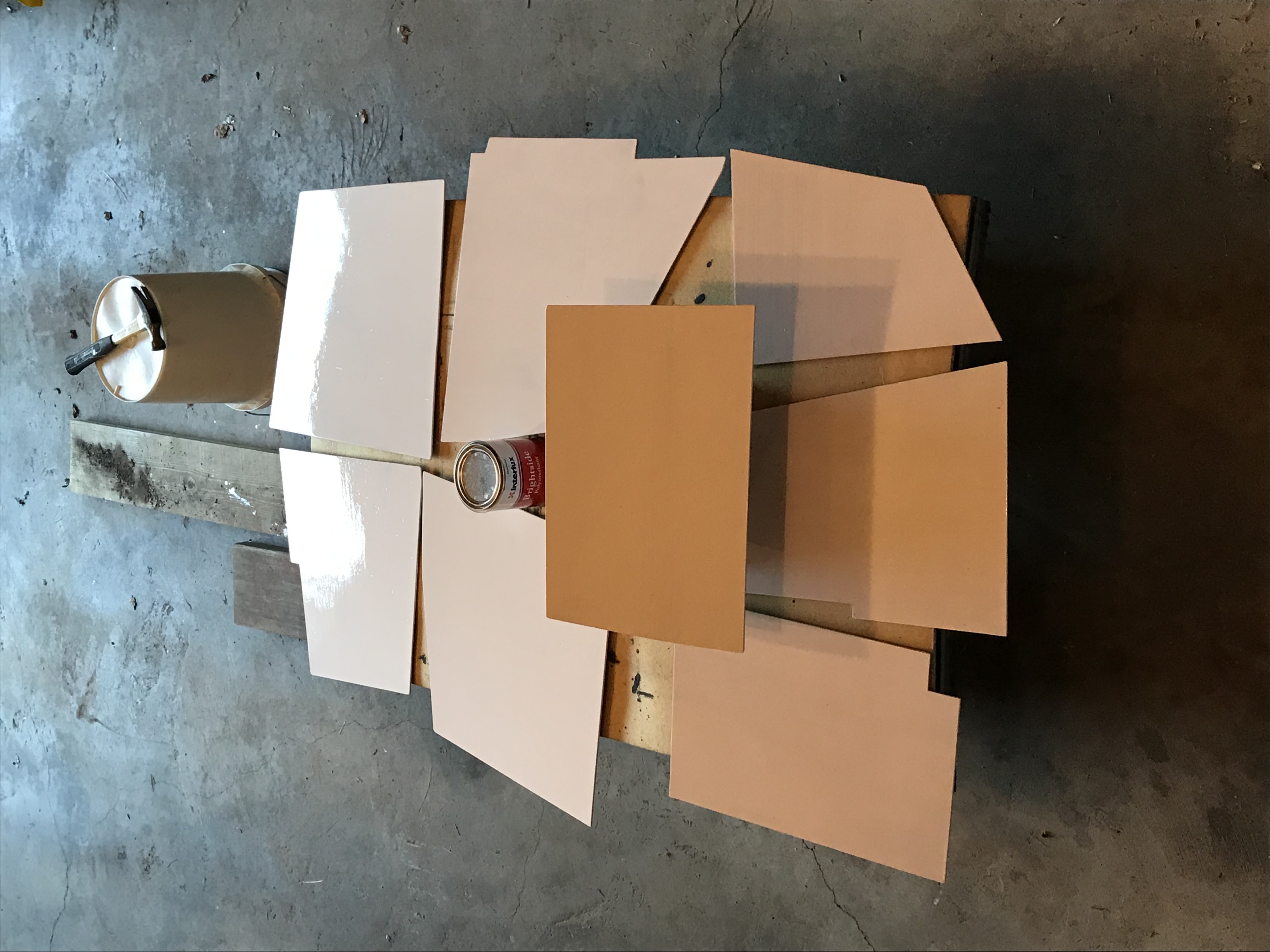

Solid 3/16” GP01.John Stone wrote:Which product did you use? I’m not familiar with LBi. Did you use the solid glass or the cored panel?Jim Walsh wrote:I used a product sold by LBI. Just took a quick look and it appears to be priced quite a bit lower than the McMaster-Carr product. Perhaps comparing apples and oranges?
https://www.lbifiberglass.com/product-c ... -products/
- 23AEE2D3-78AD-46D1-A39C-4273DA508A93.jpeg (1.78 MiB) Viewed 1428 times

I used the Isotherm 2351 kit with the water cooled condensor installed under the galley sink drain.
First, I started on the icebox insulation like Steve Laume suggested, drilling 1/4in holes on a grid and filling with "Window and Door" foam. I found a 4in grid worked OK; a couple spots I didn't get foam coming out the of the adjacent hole and tried 2in and then 1in grid but I found that where 4in didn't work, the insulation was pretty intact so if foam came right back at me I didn't get too aggressive with holes. in the area toward the hull the factory insulation was quite intact. Toward the engine it was less good. It took close to 20 cans of foam to fill everything, including my hair, but I wasn't real patient with letting it expand and I think you could do it with 10 cans. Also, a lot spilled out into the area under the icebox without really filling anything so try to block that off.
Then I cut 1in closed cell foam sheet to fit. Had to make templates and fit it in with each "plank" having a specific location. I added extra pieces to make a lower shelf similar to the factory icebox. I ended up with 3in toward the engine compartment and 2in toward the hull and aft end and 1in on the forward end. The reduced thickness at the ends was dictated by the location of the access opening which I decided not to change and where the evaporator would be located. And that the forward end had a lot of factory/spray foam insulation.
Then I glassed over the foam using biaxial cloth; 2 layers everywhere but 3 layers at the very bottom where I expect to drop stuff. I precut the cloth, labeled them and set them aside since once the epoxy flows, it's a mess! It took 1.5qts of epoxy. I think Steve and Jim's idea on other panels might be a big time saver. Then faired with microbaloons and sanded.
I mounted the compressor under the sink, against the stove bulkhead. There's just enough room for the galley plumbing and the charcoal filter housing although I'll spill into the bilge now when changing the filter. Note this photo is just a test fit; I cleaned it up later and now need to secure all the rewires and refrigerant lines. And I needed to make a plywood plate to attache to the top of the box to attach the evaporator since its holes were not in useful locations for the box.
I added a separate 20A Blue Sea breaker and 10ga wires to power the whole thing. It's really quiet, certainly quieter than 12kt breeze through the shrouds and also quieter than the home fridge. It drew 4A while trying to drive it to 25F.
Thanks for the advice and inspiration!
Jeff
