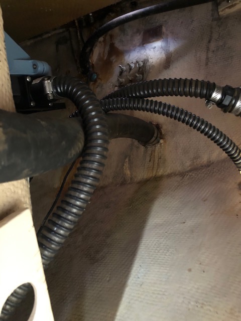

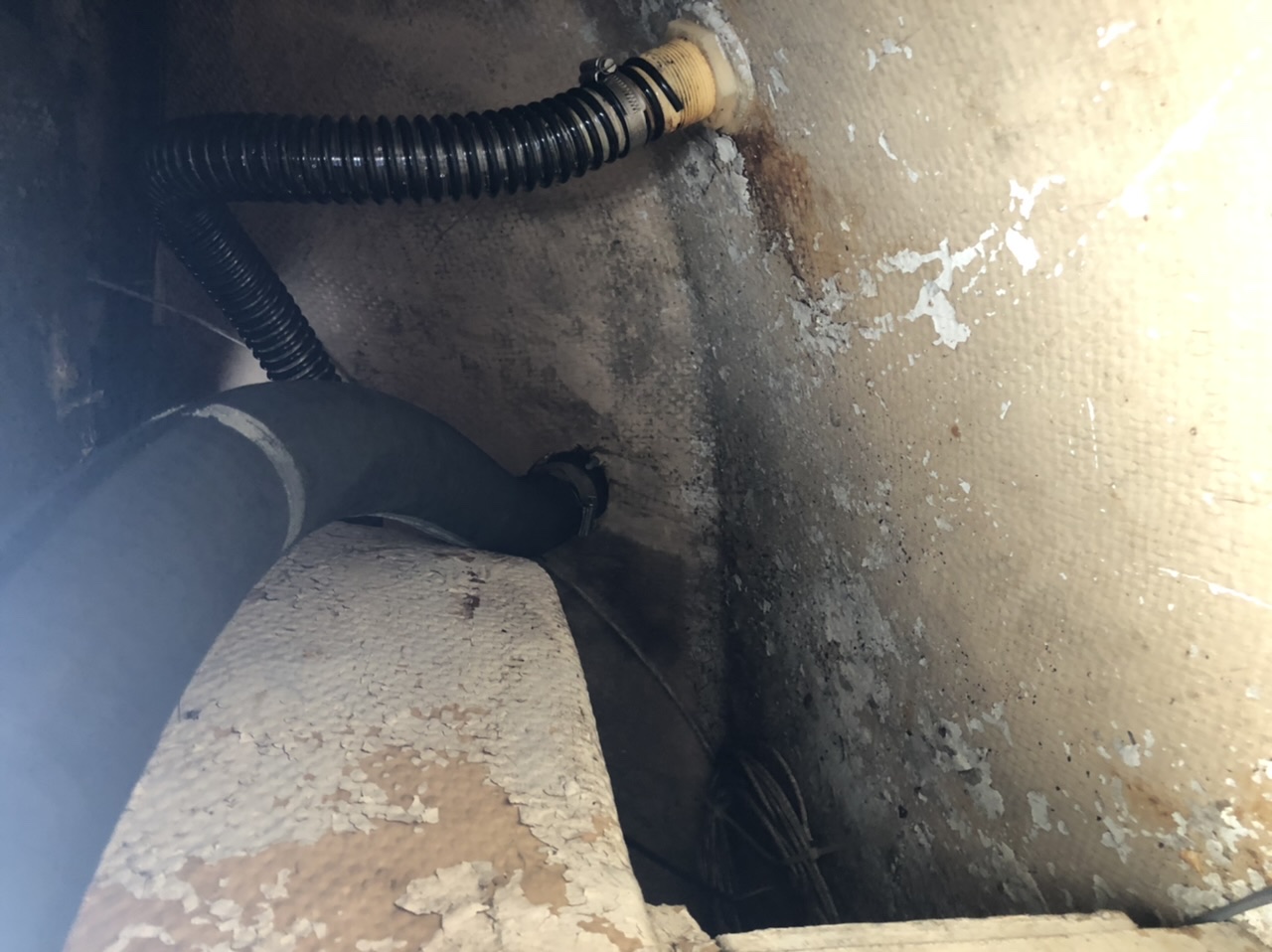

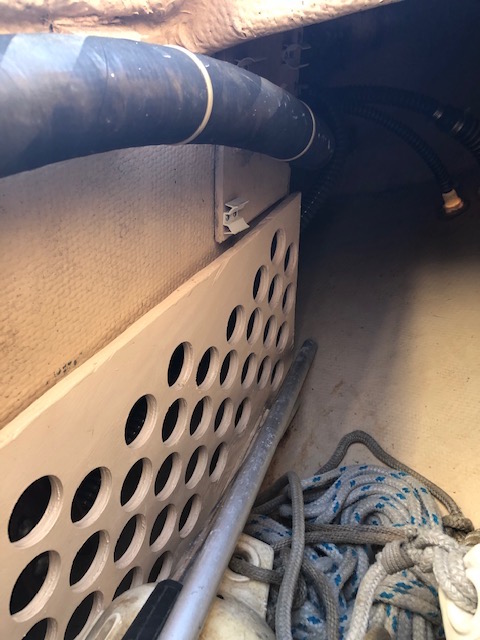

Post by Keith »
Hi David,
Here is how mine is routed.
muffler to port lazerette.jpg (107.16 KiB) Viewed 849 times
front of lazerette.jpg (78.38 KiB) Viewed 849 times
rear of lazerette.jpg (93.82 KiB) Viewed 849 times
one more pic in next post

Keith,
Thanks a million. Those really help.
-David
