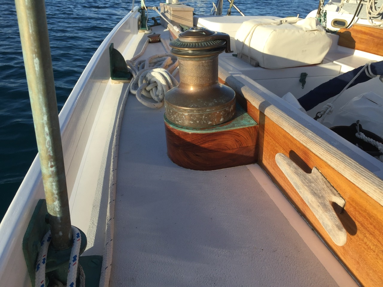

Re: Coats of varnish
Once you begin to slow the learning curve and gain some experience it’s not difficult to maintain a schedule and I have found varnishing to be very rewarding.
I think the key is having just enough wood to varnish that you can manage it with out it feeling like a hassle.
