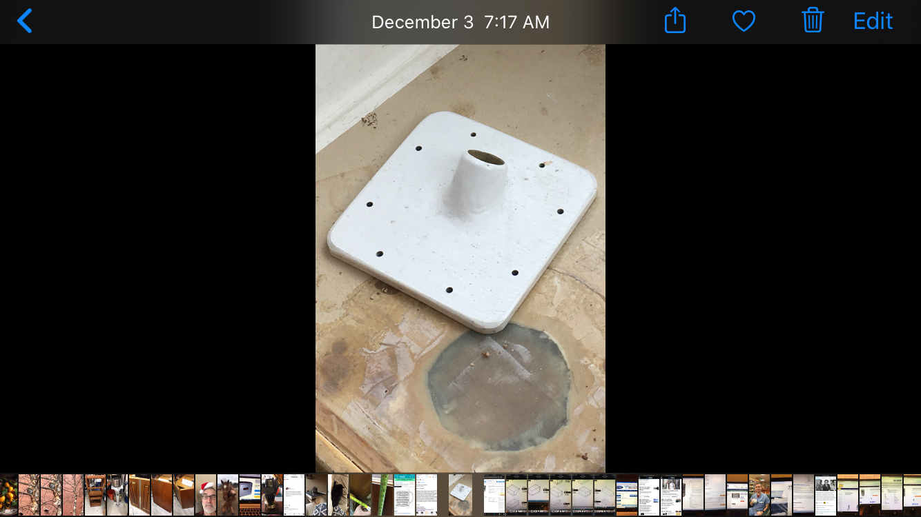

I am looking at your mockup and I am wondering how you plan to plug that big hole where the bronze cover plate goes. I talked with John Stone and did the same thing. I made a plate from G10 and the tube I wrapped 3 inch glass tape. John used a drill press to get the angle, I used a pair of 2x6 angle cut as guides for an electric drill and a hole saw. It seems to be fine on the mockup, I haven’t put it all together permanently. I’ll finish in the spring.

Nice, I'm glad to hear someone else is doing this. Not that I have any doubts about it. I plan to glue together some teak boards to make a similar platform to cover the hole. I haven't drilled the hole yet but I have a drill press which I will probably utilize. I did happen to have a fiberglass tube from another project that will fit right in there. So once you screw done that cover plate the only way to access the coupler is from underneath correct? I am debating making the cover in two pieces so I can take everything out from the top. Not that I should ever have to I guess. Are you using 45 degrees as the angle of the shaft when you cut the hole?
