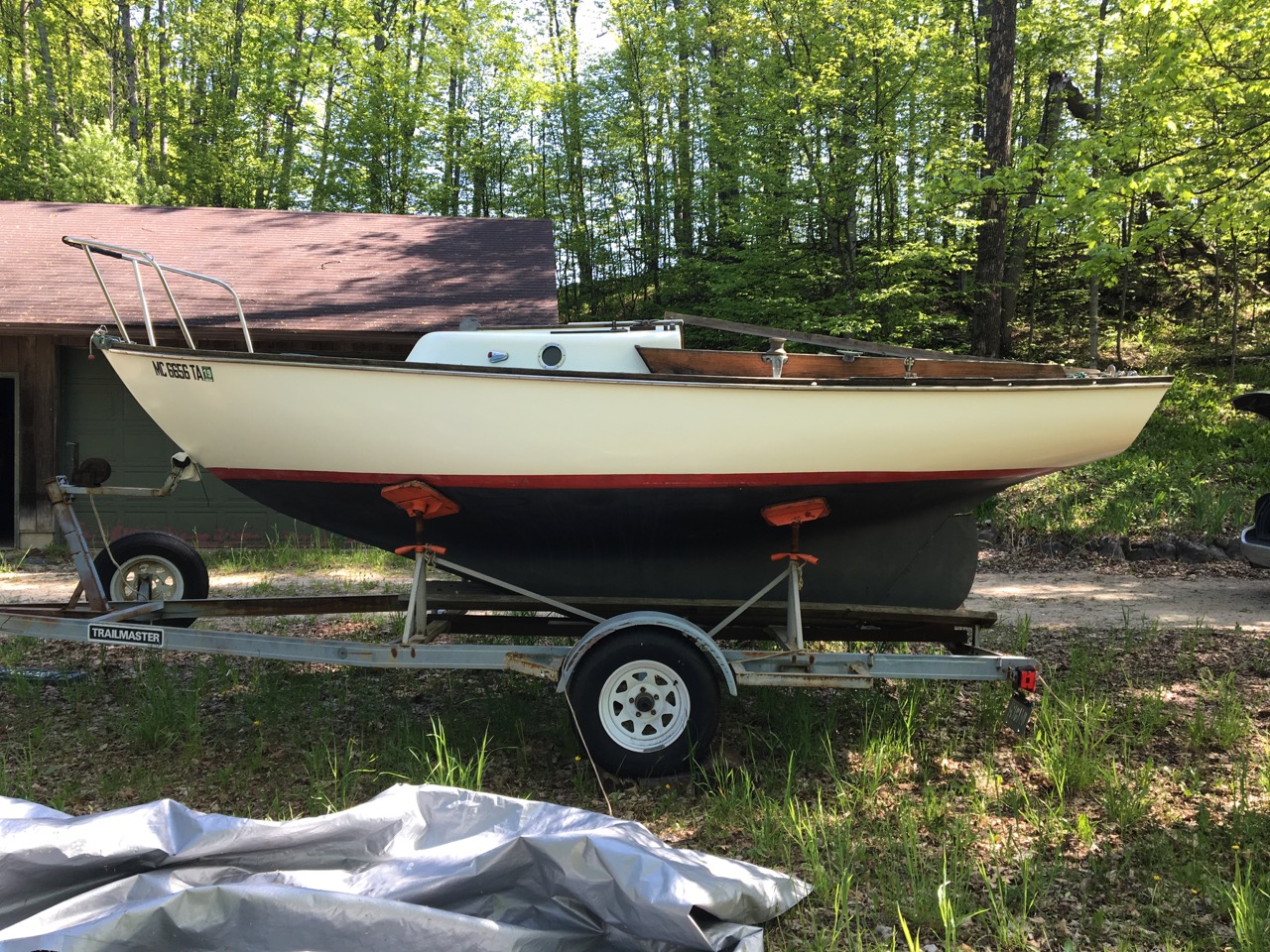

Our toe rails only have 3 holes. Which ones get the water flow depends on how the boat is trimmed. Mostly this matters on the trailer on uneven ground, but could also be an issue in the water with different gear stowage arrangements (especially the outboard) or if you are adventurous enough to sleep in the V-berth.
Sorry, the winches and cleats, which you could use as reference locations, haven't been re-attached in this photo (taken just after finishing varnish work) but you can see where they should be from the darker spots on the teak.
