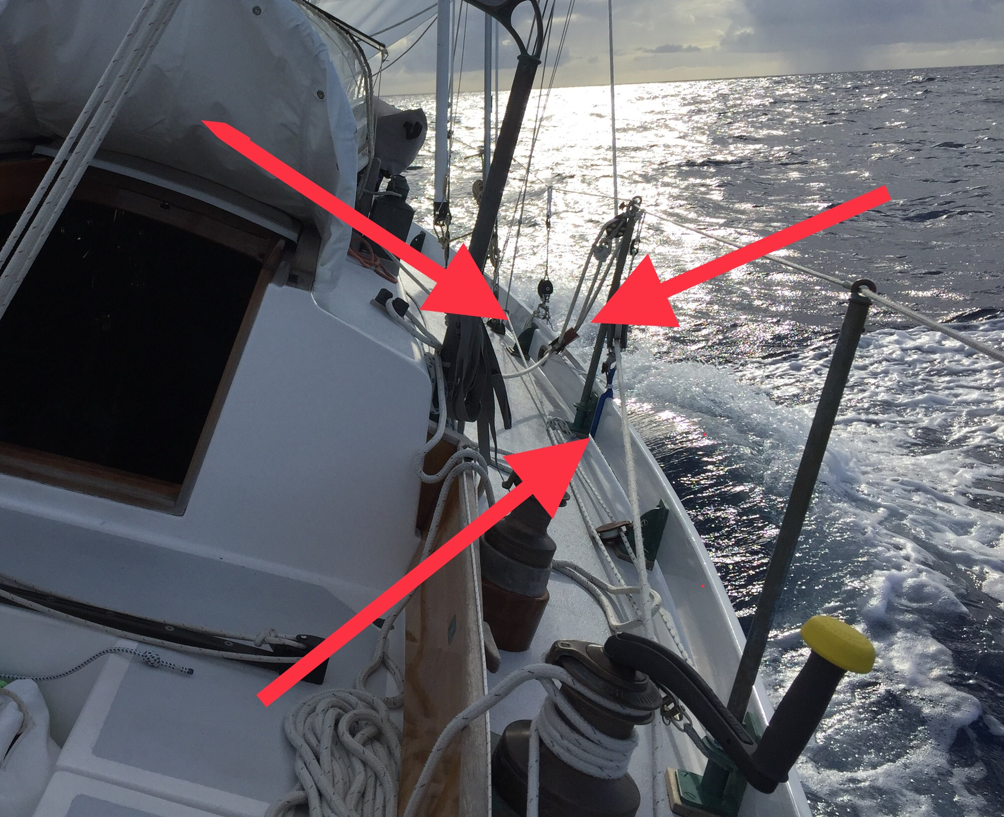

The bulwarks on the FR are one of her best safety features. They get stressed pretty hard. All my snatch blocks are stropped to it. Also, the hawesholes are installed in the bulwarks. So they just can’t be too strong. I took the design from Larry Pardey and Taleisin. I talked to Larry in person about the design. They are 3/4” thick Burmese teak on Taleisin. That much teak was beyond my budget. So, I made them out of African Mahogany. Because it’s not as strong as teak Larry had me make them 7/8” thick to compensate for the difference in strength.

The bulwarks have to be as strong as possible. There are three strops in this photo. They can all be in use at the same time.
