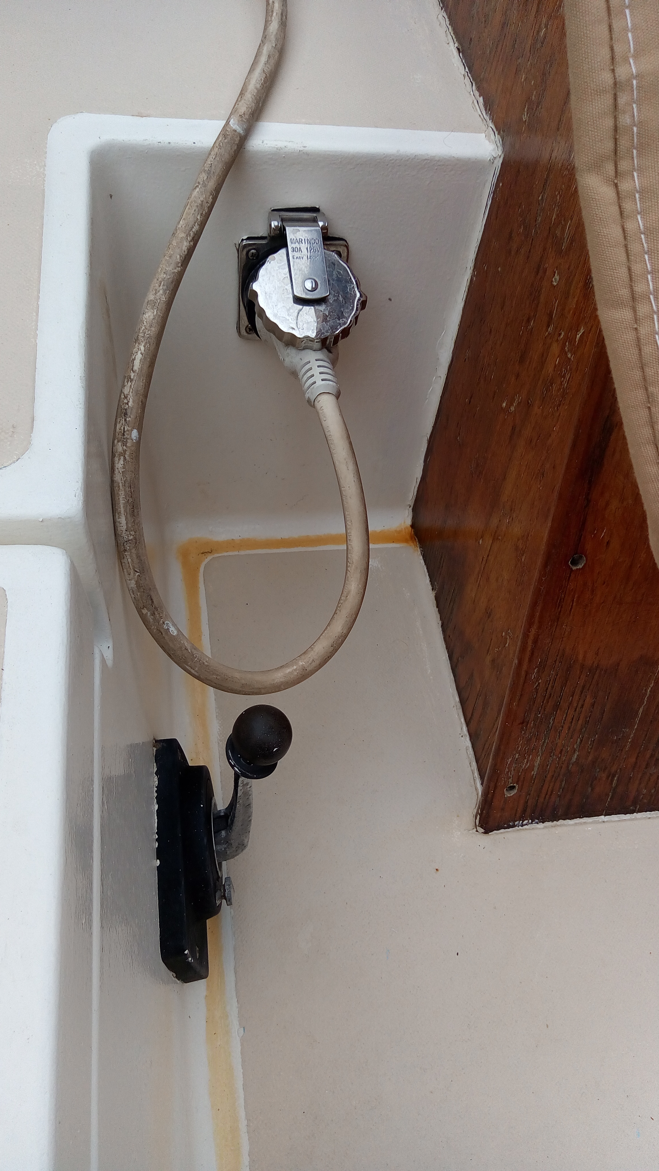

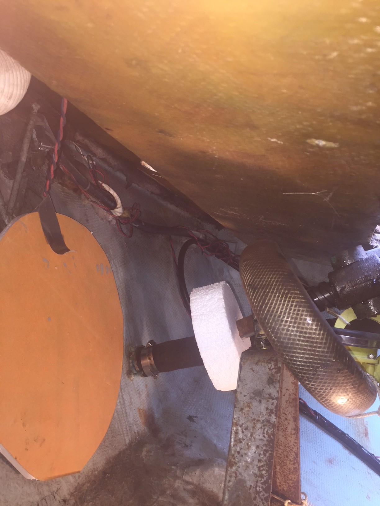

I'm working with Edson Marine and Cape Horn guys and taking in all John Stone's work to come up with a plan for 'Leoma". The easiest thing to do is like in photo of "Morning Star" with lines going across the cockpit. Like John I am determined to keep the control lines concealed in the lazerette. Cape Horn says they spent so much time on it and decided it was not possible for the worm drive steering. Maybe he meant not economically possible which means I may take his advise. But I have attached photos, One showing a mock up of the steering drum (white foam) attached on the aft end of the worm screw shaft and the orange disc represents the radius that the quadrant (attached to the Horizontal shaft through the transom from the vane) would need to rotate 360 degrees. I don't see why I can't attached pads on the hull for the blocks and run lines, like John did, to the drum. I just need to figure out how to disengage the vane steering for manual wheel steering. Another thought , I wonder if I could hook the vane direct to the steering screw with an angled coupling (Edson has it on their catalog called (shaft universal) it changes the angle of the steering shaft up to 30 degrees. Then it would be a bigger problem finding a way to disengage.I hope this is understandable. Your input is appreciated.

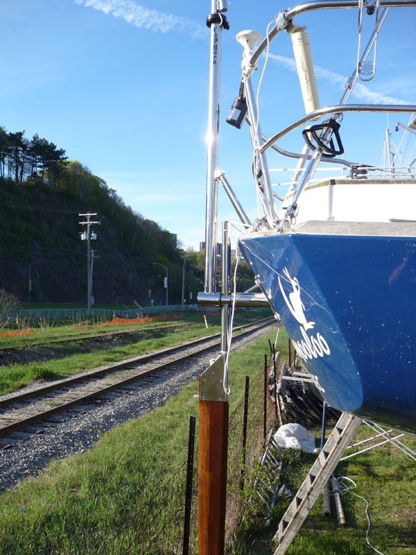

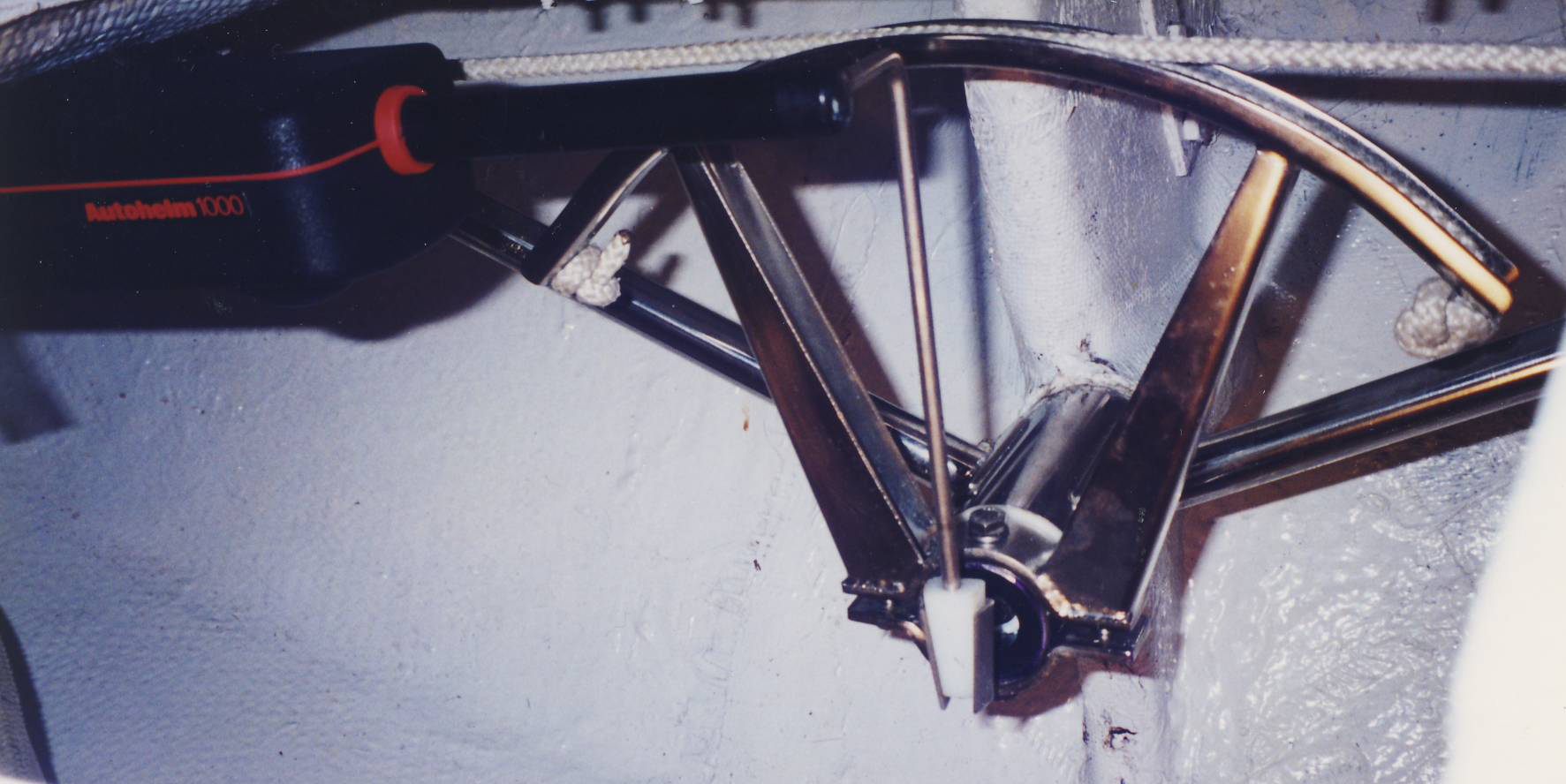

Adding one more photo. It shows the 14" vertical shaft that replaces the quadrant. It can mount on the transom. This way the only reason to bore the 2-1/2" hole in the transom is to hook up the tiller pilot. A shot of the tiller pilot hookup
- Autopilot.jpg (490.13 KiB) Viewed 1463 times
- Alberg 29-1.jpg (136.64 KiB) Viewed 1466 times

A compromise may be to use the standard Cape Horn quadrant inside the lazarette, but install a hub on the wheel like the pictures you posted. You could lead the control lines out the front of the wheel box, down low, and up to the wheel. This would give you access to disengage the control lines at the same time keep them from crossing the cockpit.

That's an idea. Ives from Cape Horn suggested permanently mounting the lines to the drum inside the lazerette and having a way to release the two turning blocks coming off the quadrant. . That's just a first thought. It sounds like it won't be a problem. Just deciding which way is best. I have time to wait for more ideas.

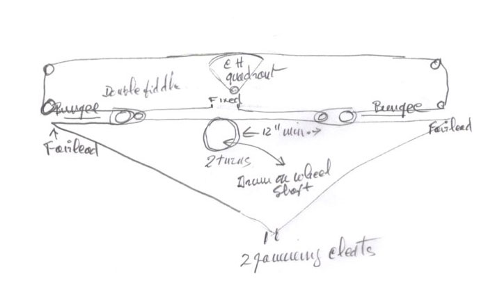

Thanks John, I hope your having a great time. Ives has been so helpful I really want to buy his product and running the lines on one side of the cockpit like "Morning Star" doesn't seem so bad. However. We have some pretty good ideas. and haven't given up on concealed lines. I think I am ready to order,( financially). We haven't decided how to engage/disengage yet. I'm gonna get all my measurements this weekend. and verify some things. He needs to know the ratio of the wheel to rudder angle. I eyeballed it. As I turn the wheel 270 degrees it looks like the rudder post turns 45 degrees . I think that means 6/1. He asked for the angle from " lock to lock" . I think that means from all the way from one side to all the way to the other. I'm gonna try to make some kind of cardboard protractor and put a needle on top of the rudder post. maybe I can get more accurate measurements.

Here is the photo of the how the drum and quadrant will be, again and a drawing of the control lines. I can always reroute the lines and move the drum to the exterior like Chriswell suggested . I sending the deposit ..
- steering mock1.JPG (348.3 KiB) Viewed 1342 times
- Lines-to-drum-on-wheel-shaf.jpg (23.58 KiB) Viewed 1342 times
