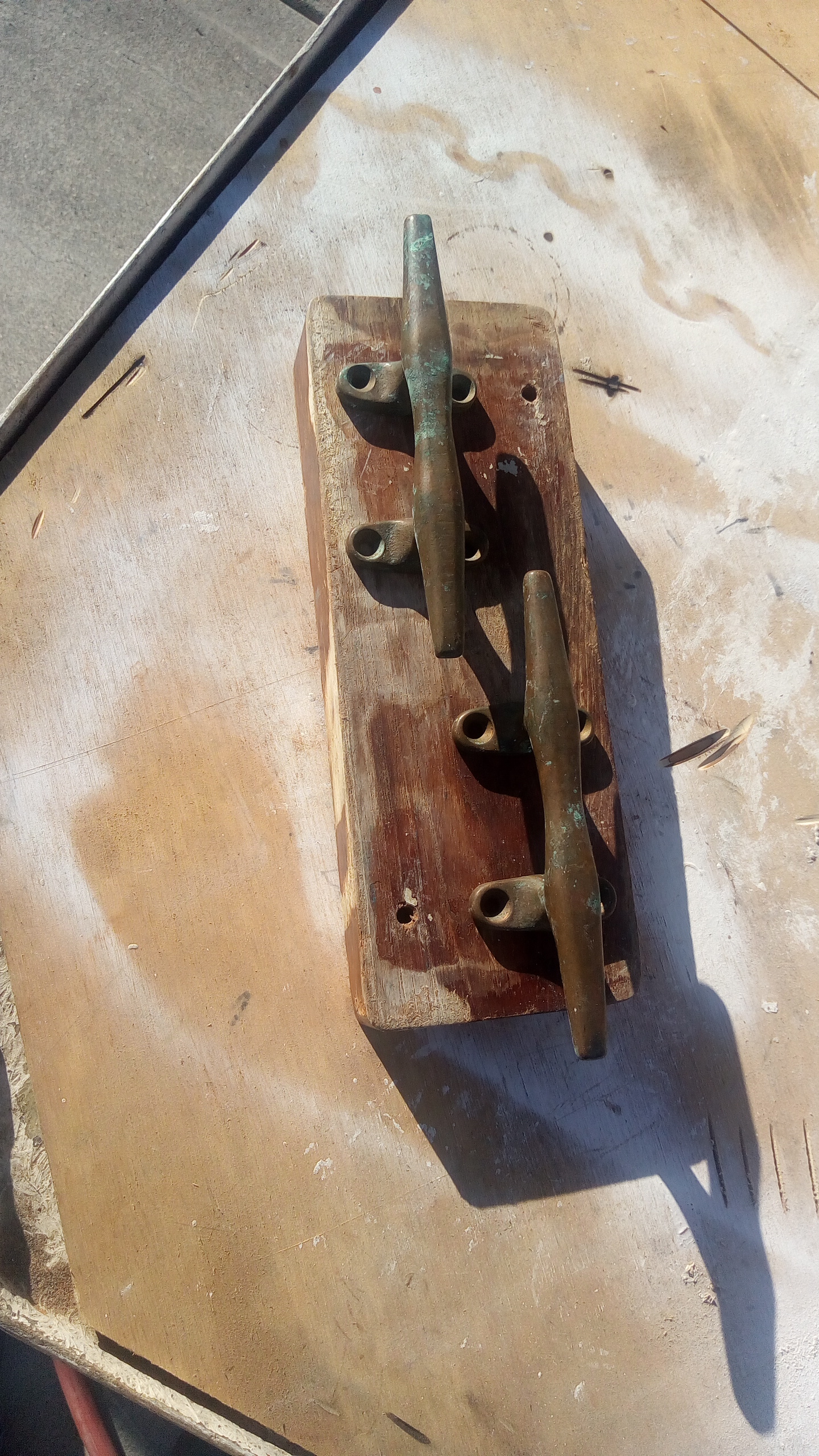

I dug up the cleats I have and I also a piece of g-10. I think I can go ahead and install these without spending any money. Except for bolts. Oh, I guess I will need to get something to raise them on the deck above the rail. Any suggestions other than another $50 piece of g-10. Also I'm wondering where I should place them. I'm thinking close to the main bulkhead. I think that makes it useful if I ever need to use the spring line to maneuver in strong currents when leaving a dock.
Re: Midship Cleats, Suitable For Storm Lines
JD-MDR wrote:I dug up the cleats I have and I also a piece of g-10. I think I can go ahead and install these without spending any money. Except for bolts. Oh, I guess I will need to get something to raise them on the deck above the rail. Any suggestions other than another $50 piece of g-10. Also I'm wondering where I should place them. I'm thinking close to the main bulkhead. I think that makes it useful if I ever need to use the spring line to maneuver in strong currents when leaving a dock.
I don’t know if it has to be near the main bulkheads. They are probably not tabbed to the deck anyway if you have a one piece headliner with molded slots for the top of the bulkhead. I’d get about half way between bow and stern. The important thing is you have to have a good place for the backing-plates with access to them.
You also want to radius the edge of the G10 all the way around — where backing plate makes contact with the deck so there is no hard edge. You can do it with a router round-over bit, a file, a belt sander, a right angle grinder. Does not have to be pretty, just soften the 90° edge.
I’d put the cleat on teak pad of teak, iroko, ipe, or even purpleheart. Maybe 3/4-1” thick.
If you do it right you can use the cleat for all kinds of things.

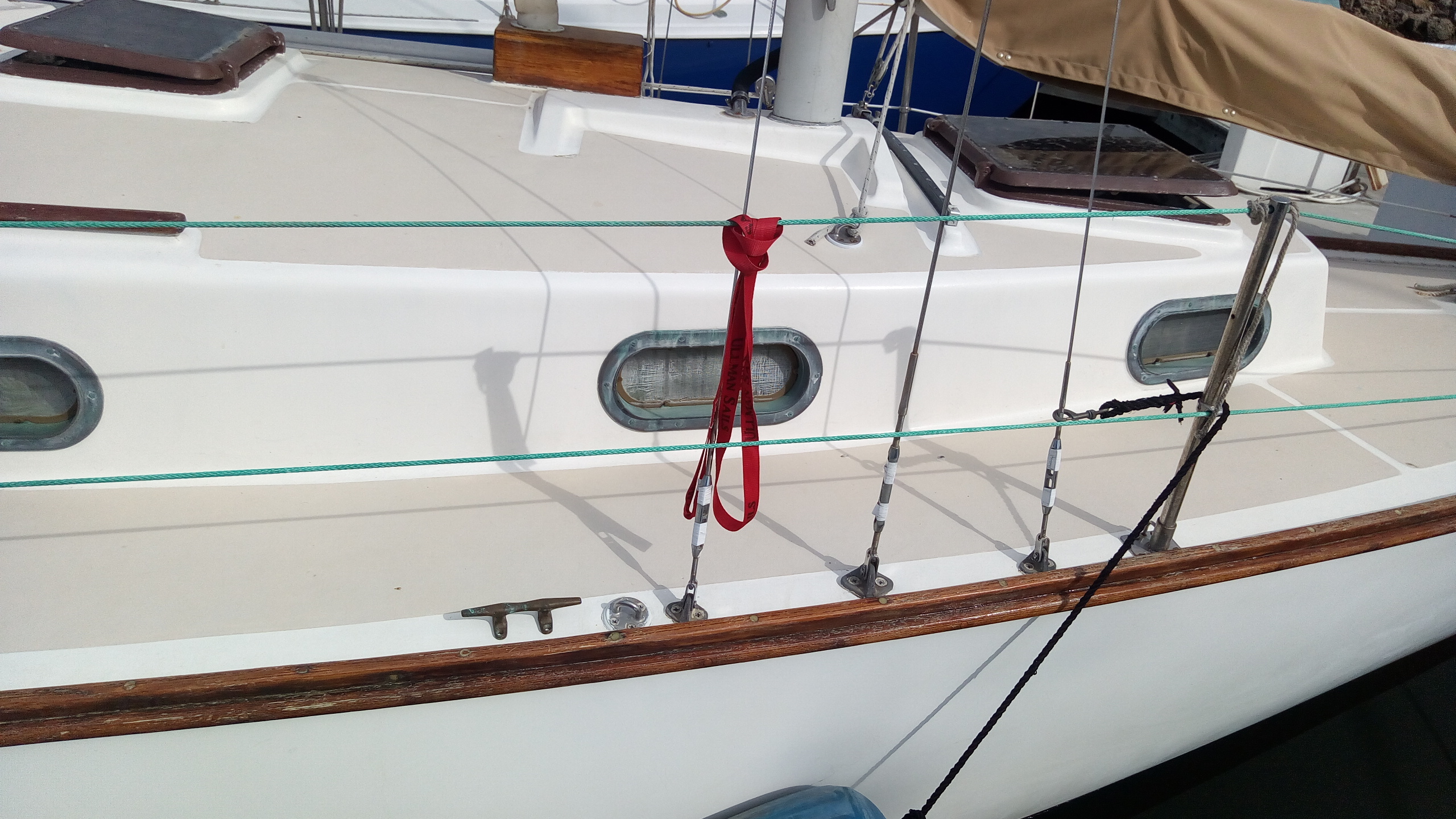

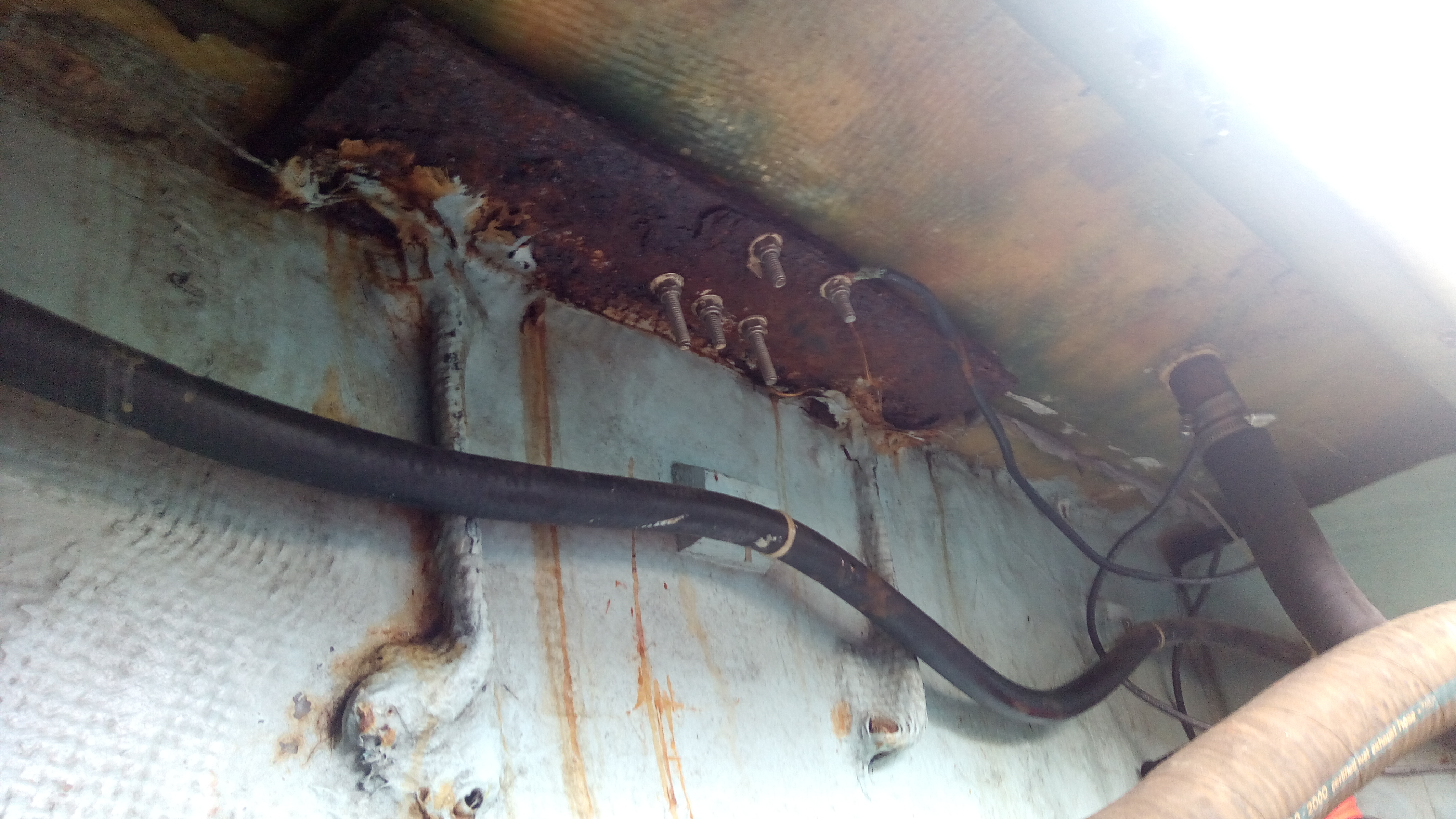

Thanks Jonathon, I know what your talking about with the deck and hull joint . I thought I would do it the same as my chain backing plates and mush them into a pastey mixture of chopped mat and thickened epoxy. I think I want them just behind the main shrouds as shown in the photo but I'll look around at others I won't need to cut any liner and it looks easy to access just aft of the bulkhead. I included a photo of my backstay backing plates. easy to see what we are talking about.
(I'll be changing those next August at haulout). I hear so many comments about not having access in the stern. Mine is completely open, I have some bin boards that come out easily. I keep a couple sails, jibsheet and mooring lines and two buckets back there .

I guess i'll work on these cleats I wanted to place them forward of midship but most of the sailboats have them midway ( like some of you suggested) I hope the teak block is big enough for both. On the underside it seems too much to fill with epoxy, for a even surface for the backing plate but another 6" piece of g-10 cost about $50.
