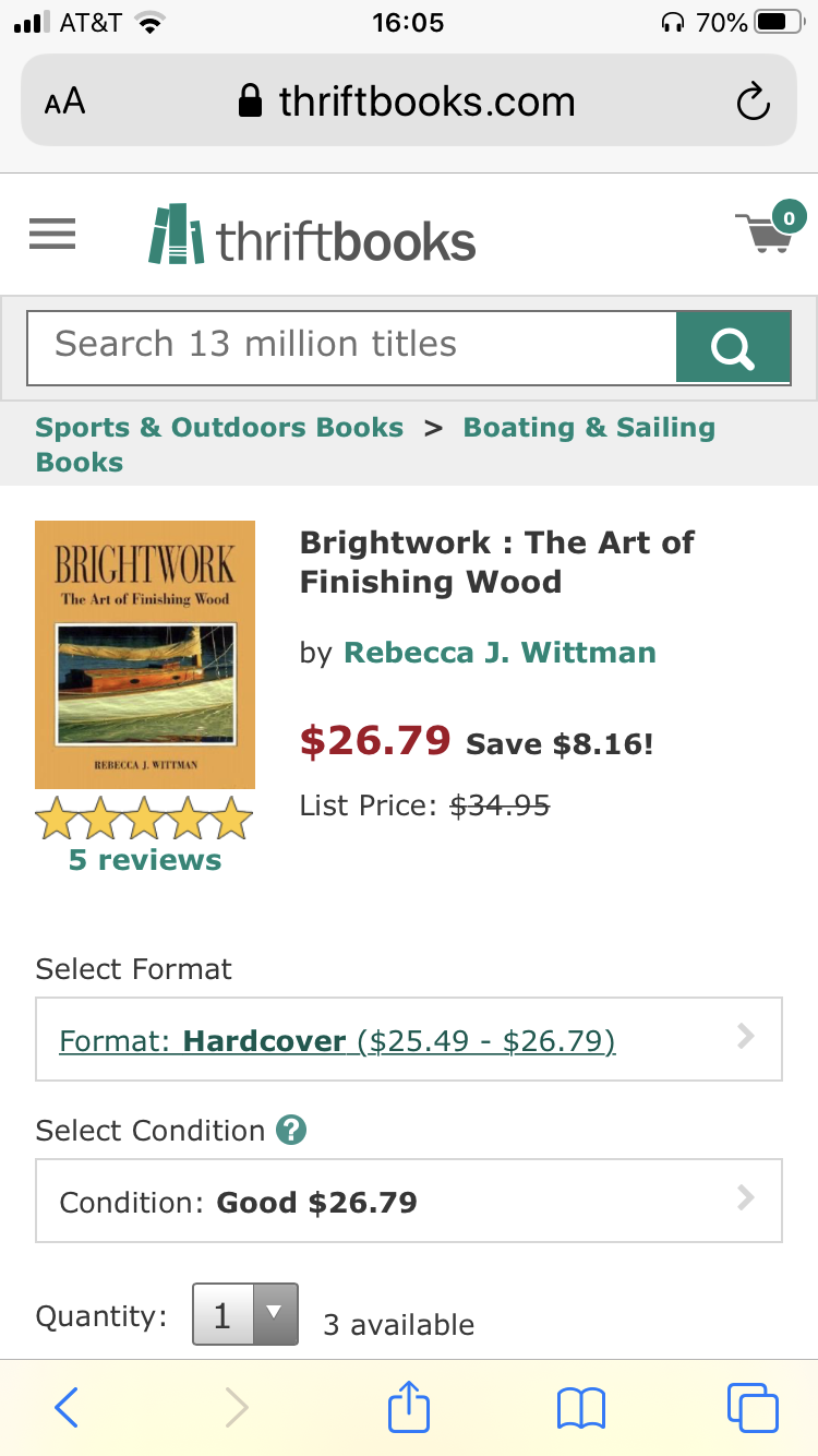

I just looked up the refinishing book and it sells for somewhere between $50 + up to $300 +/-!
If anyone wants to sell a used copy (at a reasonable price) let me know.

Here ya go. $27. About half the cost of a quart of good varnish.
- B35D620B-2FC8-4D17-B309-871C13468E94.png (476.17 KiB) Viewed 1592 times
