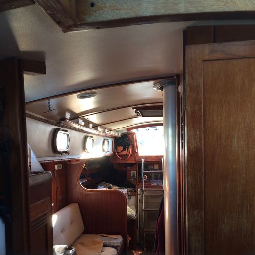

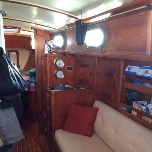

Big Improvement!
- Why did Cape Dory bother with the plywood paneling in the first place?

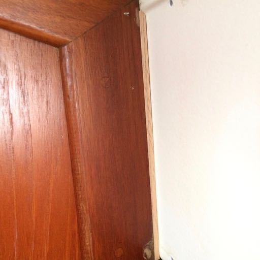

- Filling in the gap left by removing the plywood.
- Export - 16.jpg (26.39 KiB) Viewed 1449 times
- Used some red oak strips from Home Depot.
- Export - 17.jpg (26.97 KiB) Viewed 1449 times
- Most of trim fits reasonably well w/o the plywood.
- Export - 18.jpg (30.68 KiB) Viewed 1449 times
