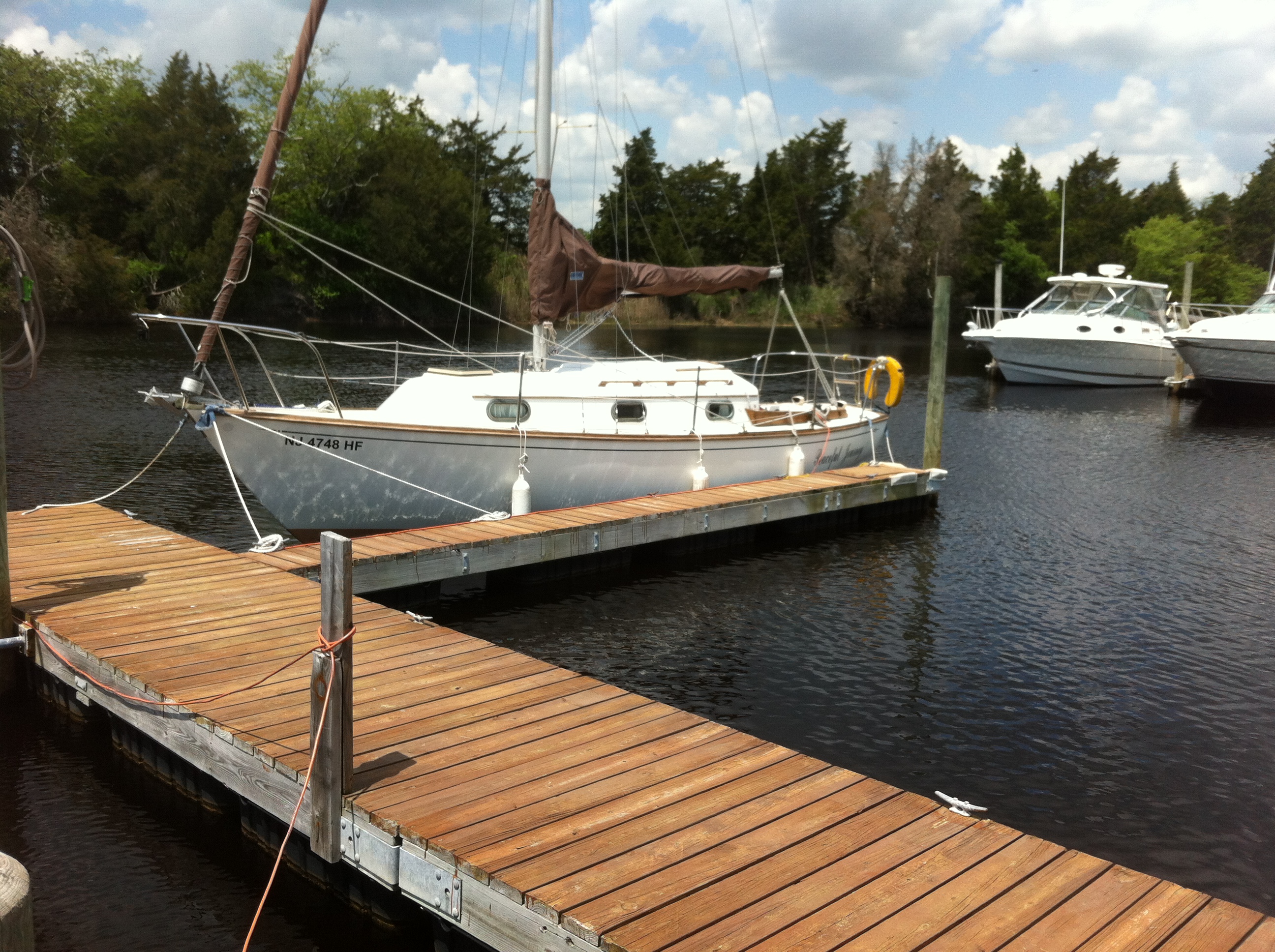

I acquired a not so well maintained CD 26 back in December in the middle of the first big snow storm of the year. I believe the PO just did not have the skills, time or money (boat was chained to the dock by the marina) to keep her up; so she was a real mess (the price was right).
My son (really glad dad's project is done for the year) and I spent most every weekend all winter working on her. This year's efforts were focused on getting her back to a seaworthy state and livable down below for some overnighting. She has some mosit core issues which I have "scabbed" over and made repairs as needed to stop further water intrusion (hoping to do fiberglass work next winter).
Here's a list of the repairs/improvements and some photos:

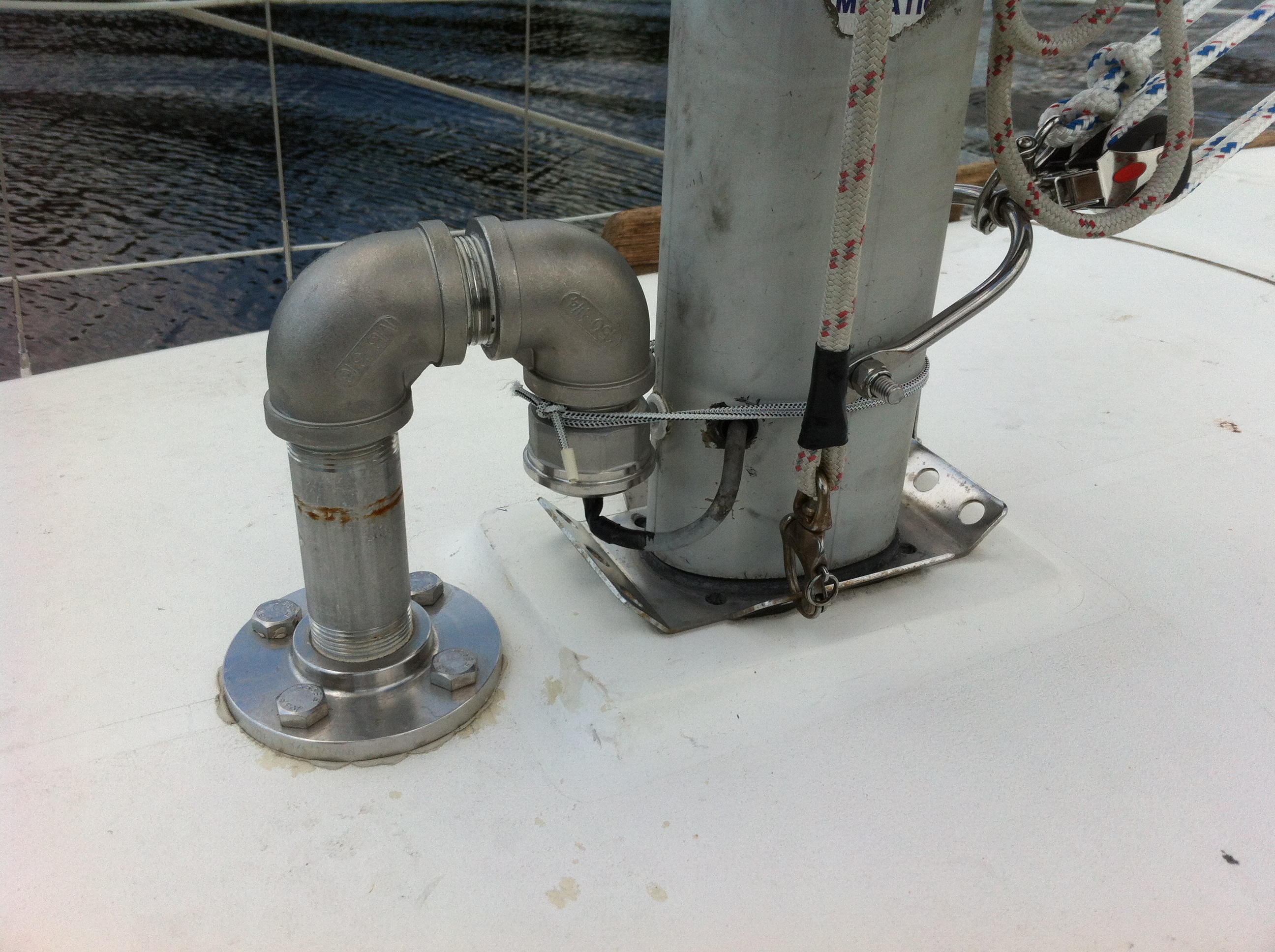

Removed leaking deck glands (mast wiring), gouged out wet balsa and epoxied void, fabricated/ installed a stainless steel gooseneck for wiring

CD 26 Brought Back to Life
- IMG_0749.JPG (1.57 MiB) Viewed 1180 times
- IMG_0746.JPG (1.77 MiB) Viewed 1180 times
- IMG_0760.JPG (1.94 MiB) Viewed 1180 times

- A slight rust spot showed up on the SS mast wire gooseneck. I think it was probably from a chain clamp mark when they (McMaster-Carr) cut the threads in the SS nipple. I'm going to try and sand/polish to see if it goes away (iron left over from chain clamp maybe?).

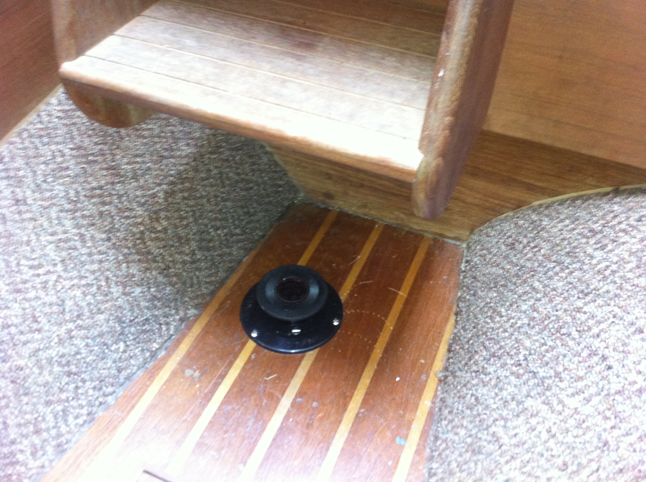

Biggest upgrade since last posting was restoration of the fresh water system. I replaced all the hose (sticky and smelly on exterior) and installed a toe operated pump in floor (The original hand pump in the faucet was shot). The pump is under the ladder to the main hatch so it is out of the way. I retained the original faucet and simply replaced the push/pull rod of the pump with a gasketed stainless steel screw and nut.
Only problem I had during pump installation was the hole saw jumped and left a few marks on floor (they show up more in photo than by eye). I'll try to deal with these over the winter.
I troubleshot the mast lights from on deck and below deck and believe there is a short up top where the wires exit the mast or in the block separating the two fixtures. I've decided to leave this be as we do not really cruise at night (had a portable light set up just in case) and will rewire mast this winter.
