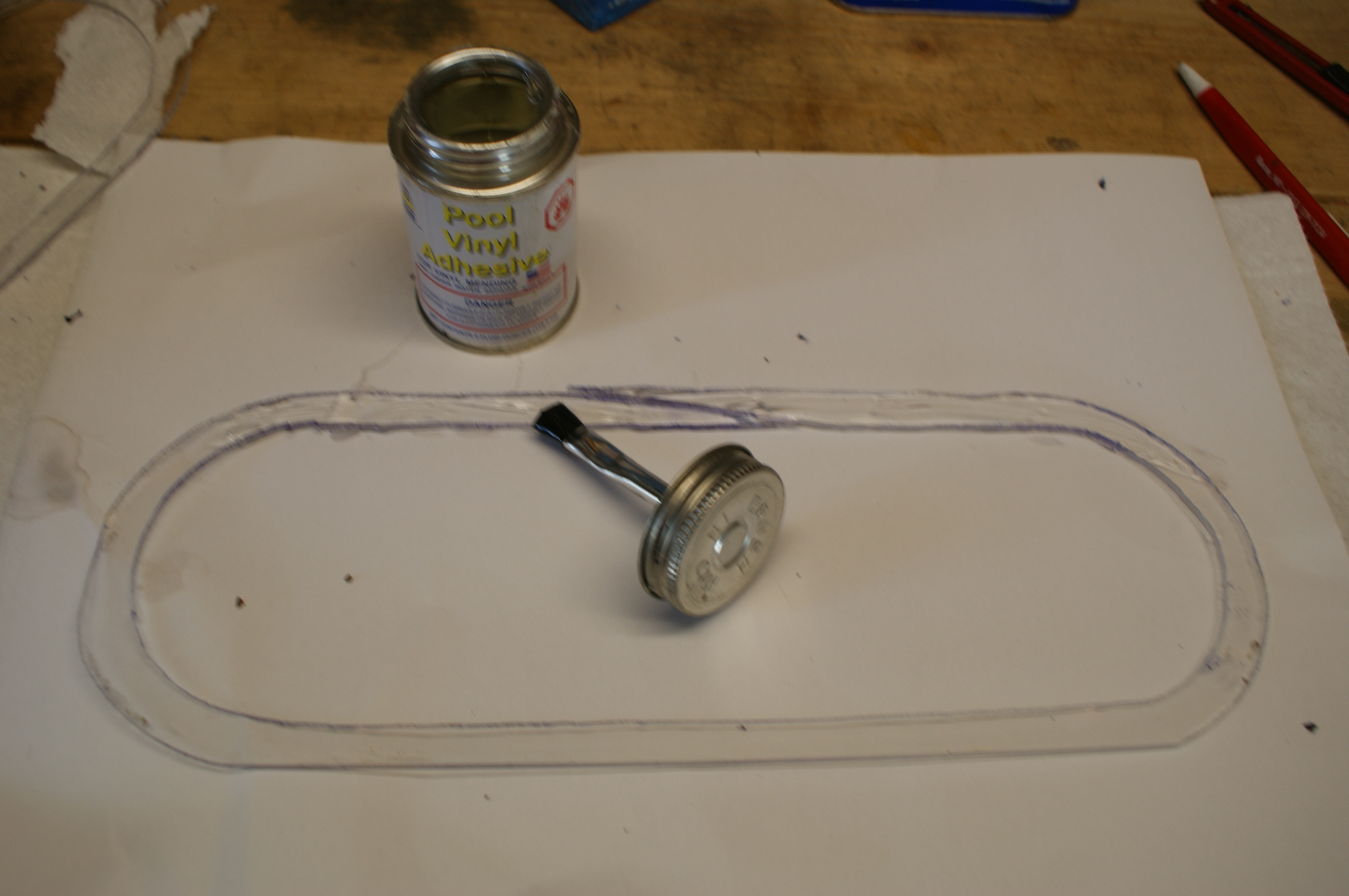

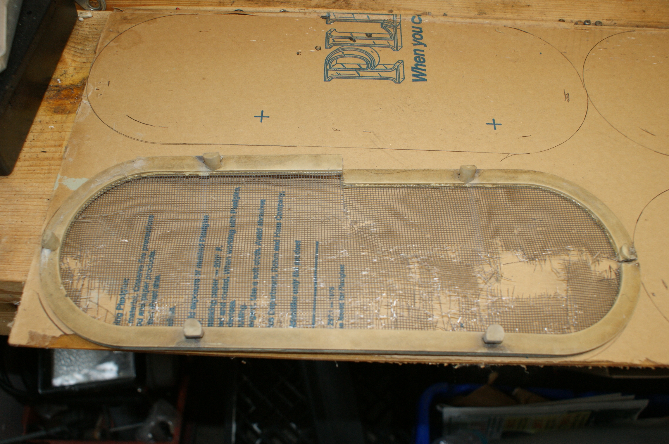

Photo #1 -I used what was left of one of the factory screens as a template.
This was laid out on a sheet of plexi glass but you could use teak plywood or other
material.

Photo #3 - A piece of fiberglass window screen is then glued to the frame. Since I made a cut
through the edge I used two frames and placed the diagonal cut on the opposite sides.
I have also made a few with just one piece of plexi glass and it seems to work OK. If
you opted to use teak or other material and used a saber or coping saw then one frame with
the screen glued to it should be suitable.

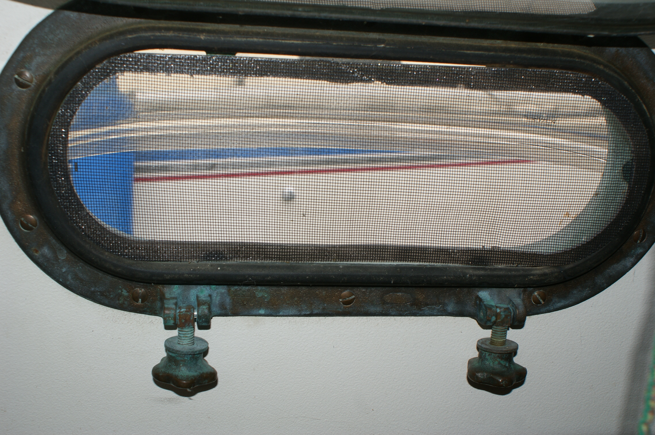

Photo #5 - Screen installed.

- Photo 3
- DSC01273.JPG (1.02 MiB) Viewed 500 times

- Photo 1
- DSC01271.JPG (2.02 MiB) Viewed 500 times

- Photo 5
- DSC01279.JPG (2.39 MiB) Viewed 499 times
