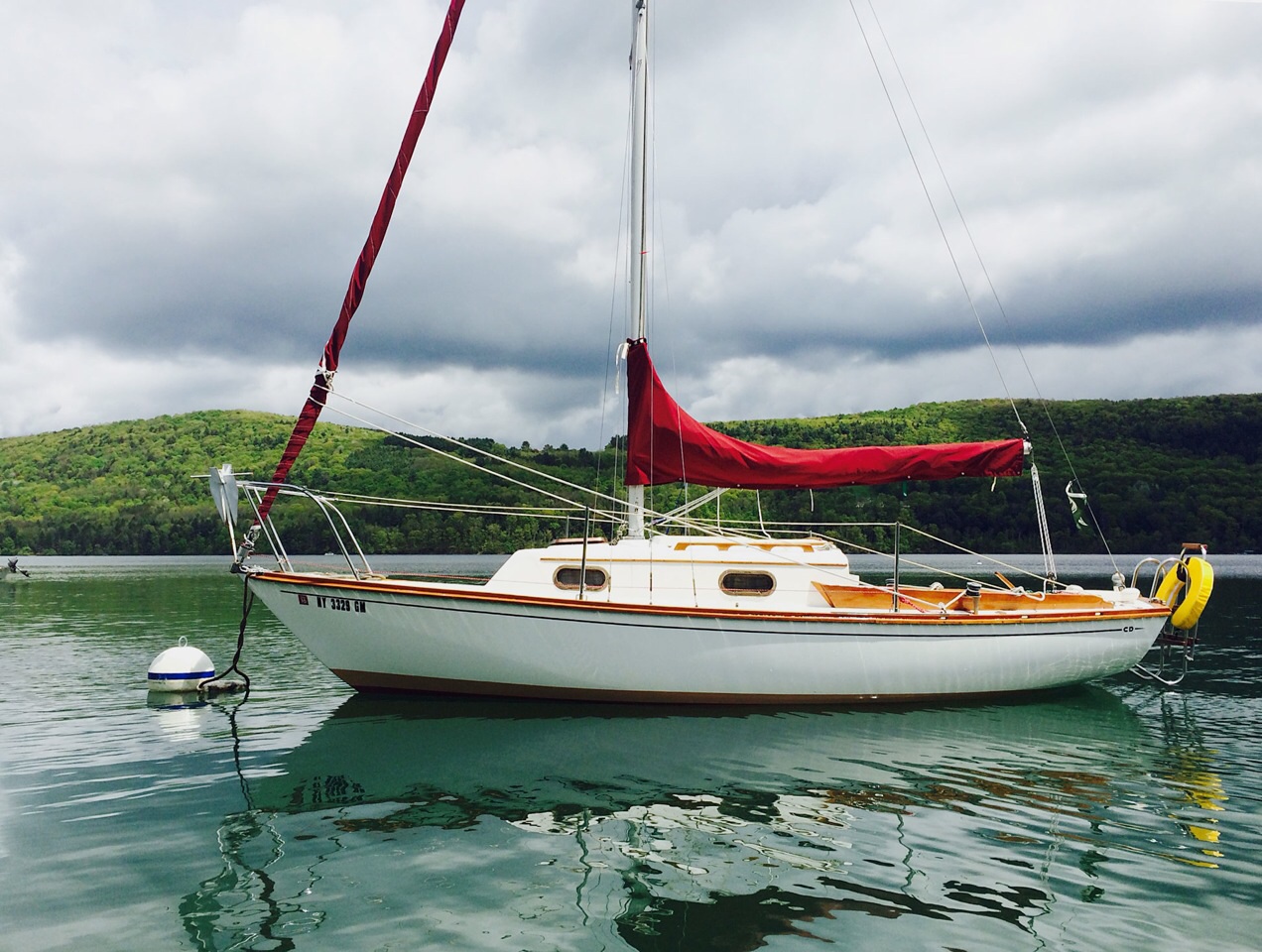

I have owned a Ty and now sail a CD22D. With both boats, the sterns sat low in the water. On the 22D, I figure it is due to the boat not having been originally designed to hold a Diesel engine and fuel tank. With Typhoons, I have noticed significant variation from boat to boat on how they sit. On both boats, I raised the bootstripe so that the top of the stripe touched the bottom of the transom. Even then, they sat too low.

Too low in the stern seems common for the smaller CDs. Our 27 squats unless the mate and I sit very far forward in the cockpit. Our 27 does not have an anchor locker forward, but we do have a water tank under the V berth. Keeping that tank full helps - a little. I prefer that the waterline looks right when I am looking at the boat at rest rather than the waterline being correct with everyone on board. The boat should be heeling when we are aboard, right?

Your photos help immensely. Plus, I note you took the advantage SAIL magazine advises on extending the top of the boot-stripe's width as the lines enter below the stern area so as to follow the water rather than reason. ( Now that's an interesting discussion! ) For those who haven't viewed it see this link: https://www.youtube.com/watch?v=-pw3VOs3wLg
Both you and Tim have good input on this. As I relook the photo of Baggy Wrinkles, I see at once the beginning of the bottom paint area would suggest the boot stripe could certainly rise up the 4 inches I think I propose. I think 4 might be the right width while also using the method of following the water line under the stern.
Could it be that the correct measurement for the stripe originates at that place under the stern? For if you bring that line to the beam, as you have done on Fandango, when it gets to the beam, it is about 3 to 4 inches I believe, from observing the photo, and that beam point is exactly correct to the naked eye. What do you think of that logic on waterline?
