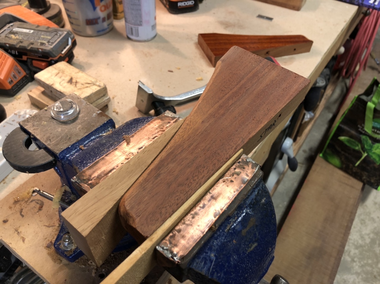

I brought the removable center section of the bottom step riser home. I removed the gusset supports. Readers may recall I made them from the off cuts of chopping down the companionway ladder. Satisfied I have them right I used a head gun and pull scraper to remove the old varnish. Took only a few minutes followed by a a light sanding with 220 abrasive paper. Then I applied a 50:50 mix of varnish. I waited an hour and hot coated a second coat cut 15 percent. Tomorrow I will apply the third of seven coats.
- 029A669C-F33C-4ACA-82EC-C26595AD5FEB.jpeg (251.09 KiB) Viewed 1178 times
- 548F48D7-E3A4-449E-B3FB-77146ECD3EA8.jpeg (349.78 KiB) Viewed 1178 times
- 91EB1A39-9A1B-4D65-9232-84F1BF968C4D.jpeg (323.66 KiB) Viewed 1178 times

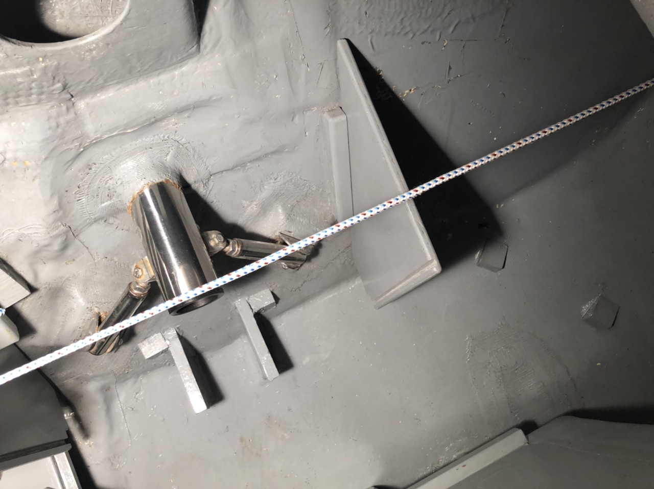

Today I spent time crawling through the boat and measuring and imagining and visualizing the different options for running the exhaust. I took a break for a bit snd completed bolting in the waterlock muffler and reassembling the flex coupling one last time. I was laying in the space behind the engine looking at the muffler when it occurred to me I had overlooked a third option. I forgot the exit nozzle can be rotated. If I rotated it 90° level to the LWL I could run the exhaust just into the port side locker going aft and under the floor/shelf I had built into the locker following the upward slopping hull and then rising up against the longitudinal bulkhead that separates the space behind the engine from the port cockpit locker. Then skirt the stern rope locker and follow the path same as Plan A and B into the lazarette and to the exhaust flange.
So, looks like Plan C, depicted in green, is the way forward. Throughout the entire six year rebuild of the Far Reach I learned time and again if something didn’t seem quite right if I just slowed down and kept thinking the right solution would eventually reveal itself.
I’ll measure the hose length I need tomorrow—which I think is going to be about 10-12’. I’ll have to order it. I have decided on using Vetus Slang50, 2” ID, smooth wall, flexible wet exhaust hose.

Took the Vetus Slang 50 hose to the boat. It’s amazingly flexible. Various options for exit from the boat being considered. All options have drawbacks. If I use the original bronze Spartan exhaust flange in the original location the hose ends up looped forward and then storage accessibility to the port side of the lazarette gets clobbered. What’s not in the photo is the removable floor/shelves that run throughout the lockers making them far more useful for storage. The loop also interferes with the self steering control lines. What I need is a way to route it as shown below. It would require a tight 90° through hullhull but in bronze. I need to keep the hose close to the transom. I have scoured the internet without luck. The only ones I have found are plastic and that’s a non starter. I found one with a bronze 90° threaded hose barb but it marries to a special mushroom head only available in SS—made by groco. Also, I don’t think it comes in 2” ID.
It may be I need to exit vertically down through the stern counter but very close to the transom. Whatever I come up with I want to be able to remove the shelving and have complete physical access to the locker so I can clean it and perform maintenance in there. I also plan to install a bronze 2” in-line ball valve in the hose as it rises vertically along the transom before the tight 180° down to the flange. I can close it off when sailing offshore. I’ll have to hang the key on the ball valve though so i don’t forget it’s closed. Starting the engine with the ball valve close would not turn out well.

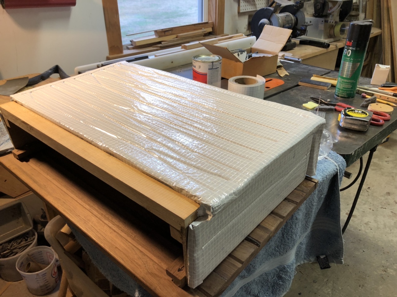

Applied Soundown insulation to the underside of the workbench that sits above the engine. Still need to install the mechanical fasteners.

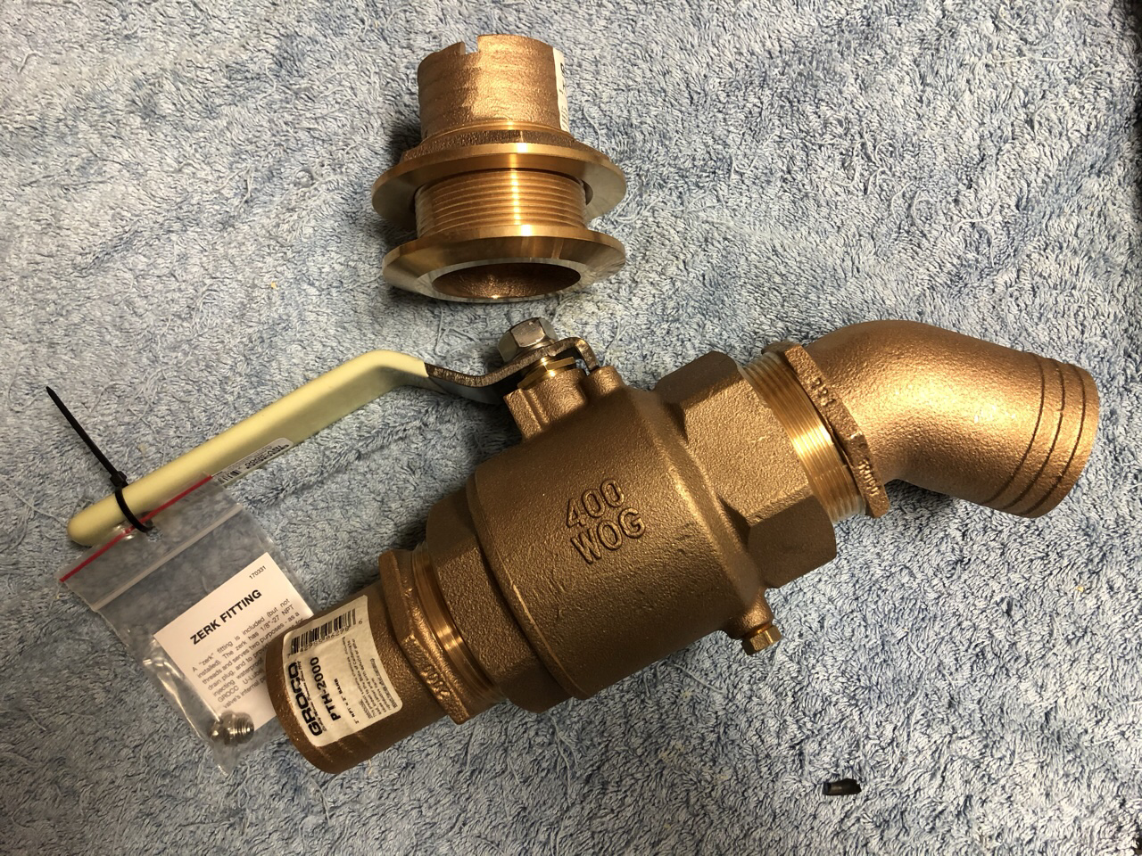

Thanks Jim. I found a solution...fiberglass 45° tube for exhaust systems. I purchased it today. I ordered the 2” ID Groco ball valve tail pieces etc. I wanted to use Marelon for weight but they have a bad rep for the handles snapping off so I passed. Plus, I couldn’t find them in 2” ID. Anyway, as soon as the part arrives I’ll install them.Jim Walsh wrote:I was just at Defenders to look at the 90° full flow bronze pipe to thread adapters. They stock them up to 1 1/2” but I was told they can obtain them up to 3”. It might be advisable to call Groco directly to see what they have to suit your requirements. They have both NPP and BSPP available in their full flow FFC series.

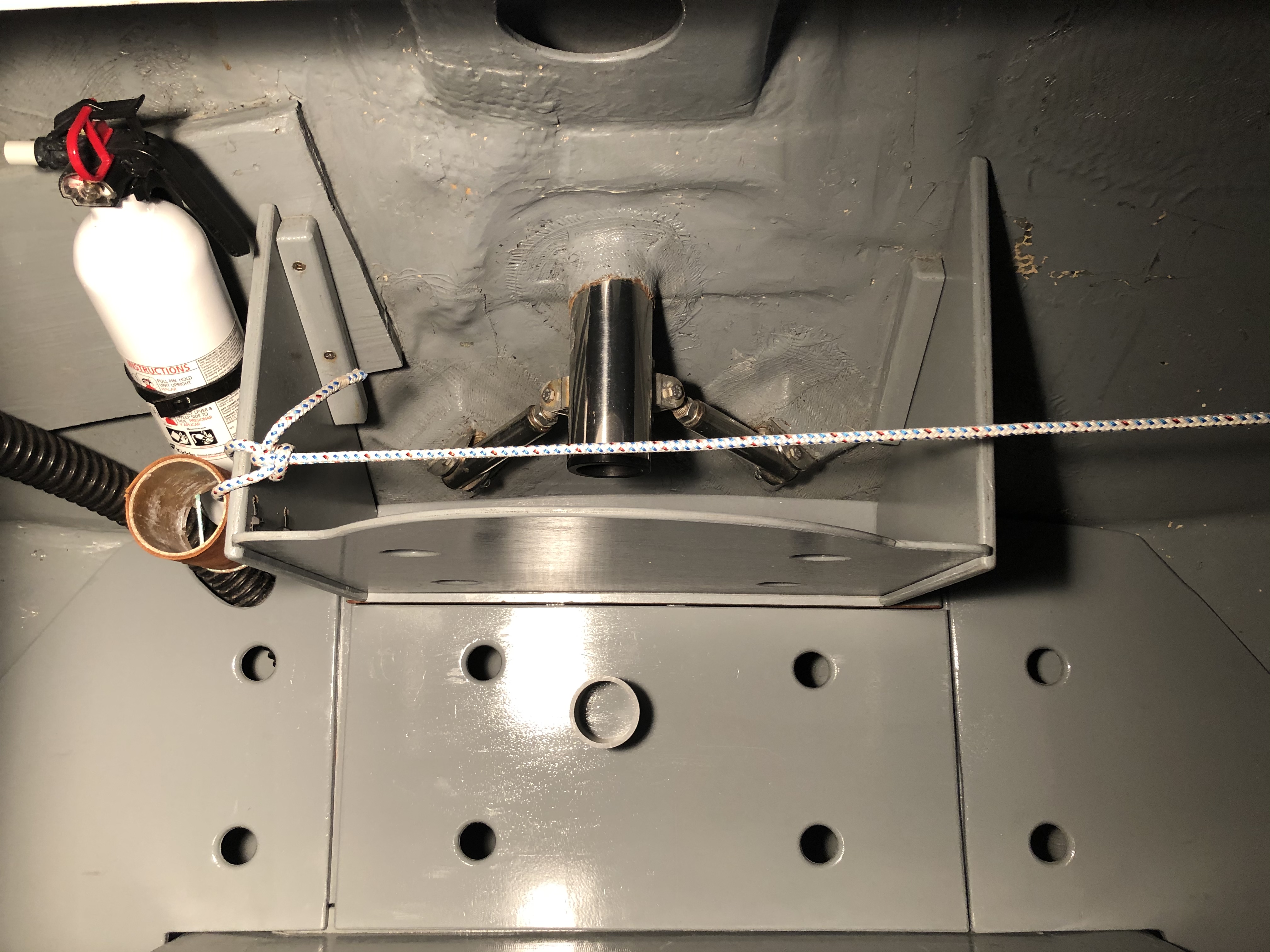

On another topic, I have had some folks interested in the lazarette locker shelves I built during the rebuild. Turned out to be a very valuable modifications. Everything is quickly removable. Good ventilation. Much easier stowage. I made the same style mods for port and starboard lockers as well. Highly recommended.
- Looking down into lazarette. Box in center encompass Cape Horn windvane quadrant—not installed at the moment. All the shelves lift out.

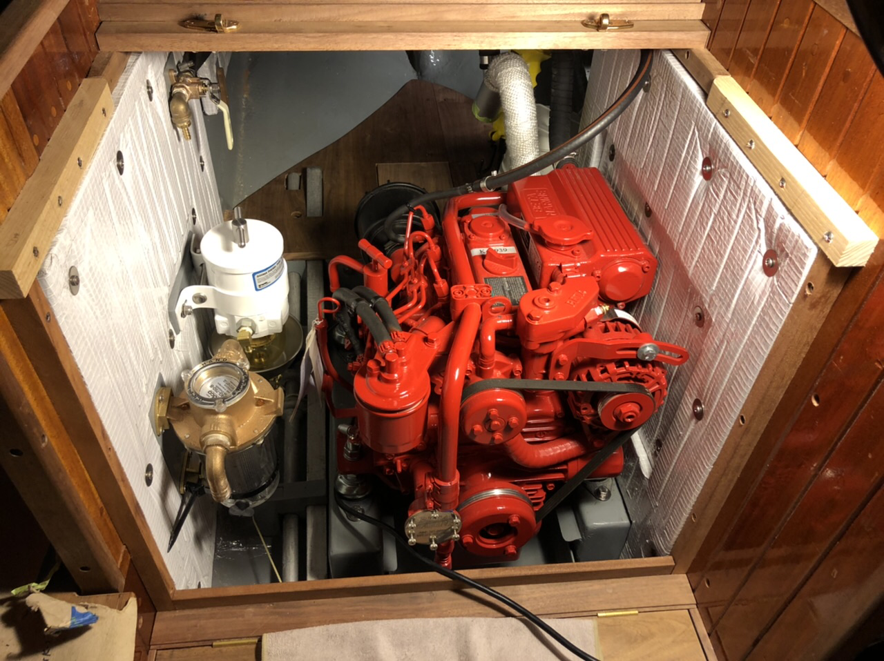

Lousy weather. Cold and rainy day after day. On the boat every day. Slow steady work. In and out of lockers. Developed a plan for installing a cut off ball valve near the tank but reachable in the port cockpit locker. Near the head of the windvane servo blade in its horizontal stowed position in the port locker. Also installed ball valve upstream of the Racor, in engine space. Drilled 3” hole in port transverse bulkhead between aft end of port locker and lazarette. Installed chafing guard. Also enlarged existing hole in same bulkhead just under deck for windvane control line. Installed chafing guard there as well. Applied thinned epoxy to the exposed grain of the plywood bulkhead where i cut the hole. Reconfigured starboard engine room access panel to accommodate Soundown insulation. This panel is inboard of starboard Q berth. I will install addition insulation there as well.
Next, I’ll complete installation of fuel lines and raw water hose. Probably run tank vent line. Waiting for 2” bronze ball valve to arrive in mail to complete engine exhaust hose install.

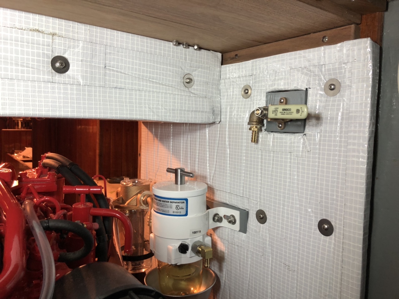

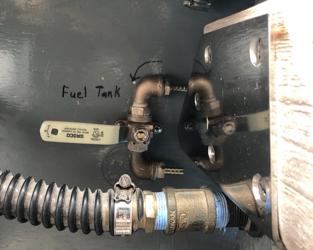

- Ball valve for fuel shut off upstream of Racor fuel filter water separator.

- Temp mounting of diesel emergency shut off. That’s the windvane blade to the right

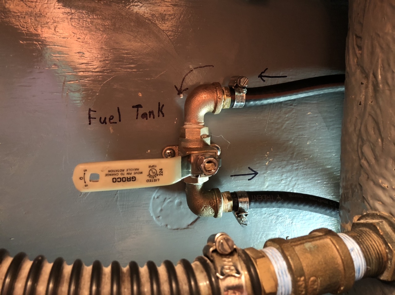

Installed and connected the fuel lines from the tank to the ball valve next to the Racor. Also installed the diesel return line from the injectors back to the tank. I need to zip tie 12v wire bundle.

- Fuel line running from ball valve in locker (left) to the ball valve next to the Racor (right) which I had just removed to install hose barbs before taking the photo.

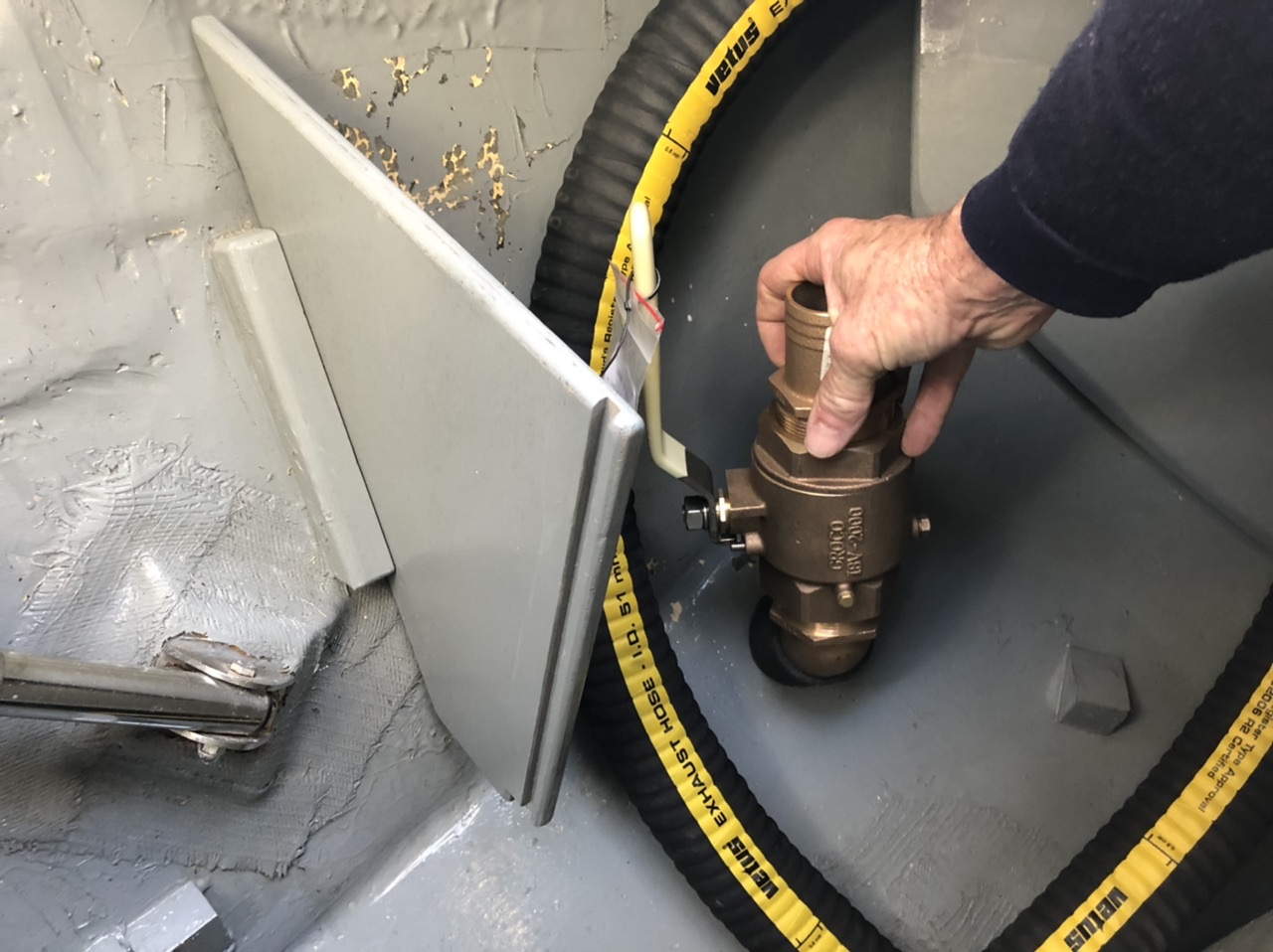

The behemoth 2” bronze Groco in-line ball valve arrived along with the through-hull hose barb combo. The through hull will served as the exhaust flange just under the stern counter. The big ball valve will be in the exhaust hose in the lazarette. It’s purpose is to keep water out of the exhaust hose when sailing offshore. If water gets forced up into the hose it can overload the muffler and back water into the engine.
Today, I installed the right angle hose barbs in the Racor filter and mounted it. With the work bench and drawer removed there is pretty good access to the engine. I’m pleased about that.

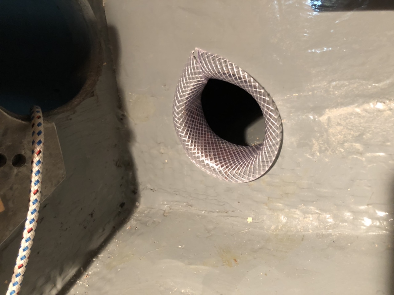

I drilled a 3.25” hole through the longitudinal bulkhead next to the waterlock muffler. I angled the hole-saw about 45° aft. But, even though I allowed for some slop the hole was not big enough due to the angle. So it wouldn’t accommodate the chafing guard. The hole needs to be oblong and I didn’t understand that until after I cut it. Easy to drill a bigger hole right...but I drove the Jeep today and not the truck (which is loaded with all my tools and extra “just in case stuff”) so I didn’t have my jig saw. Note to self: No matter how much you think you planned for all contingencies you are going to need the tool you didn’t bring.

- The exhaust shut off valve.

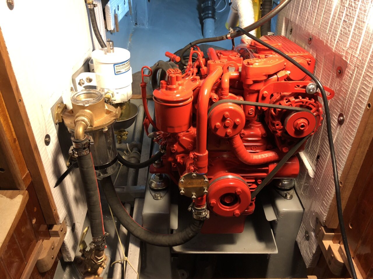

- With the work bench top removed there is pretty good access to the engine.
- AC815130-524E-42EA-BE05-CA7617EC72B4.jpeg (508.02 KiB) Viewed 1020 times

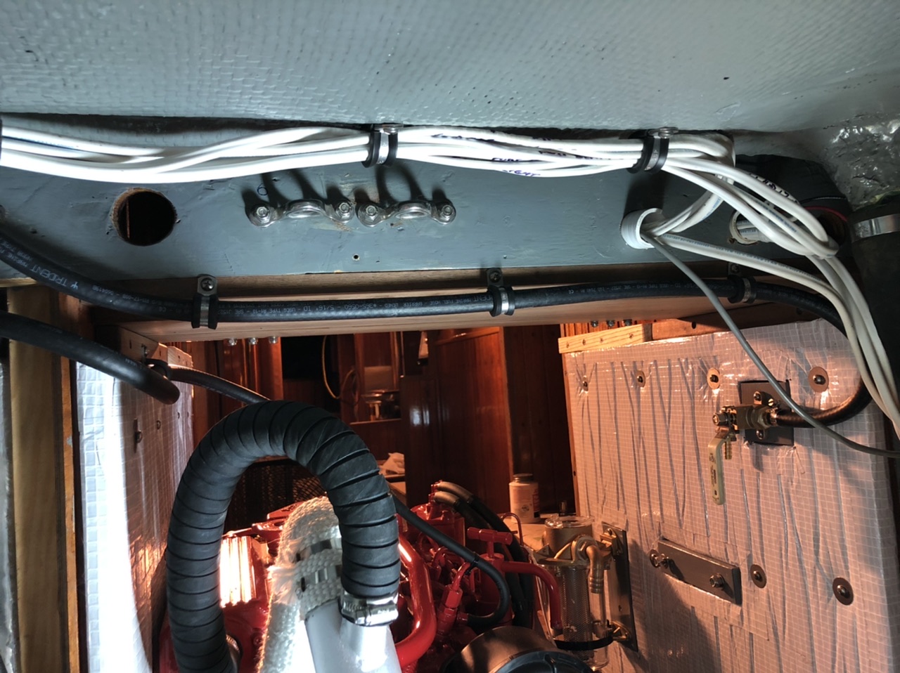

I cut a wider hole in the longitudinal bulkhead and temporarily installed a chafing guard. The exhaust hose fits well curves aft in mostly empty space beneath a floor/shelf system installed i the locker. I have a few more small epoxy projects related to the exhaust hose install which will include applying epoxy to the edge grain in the cut hole.
