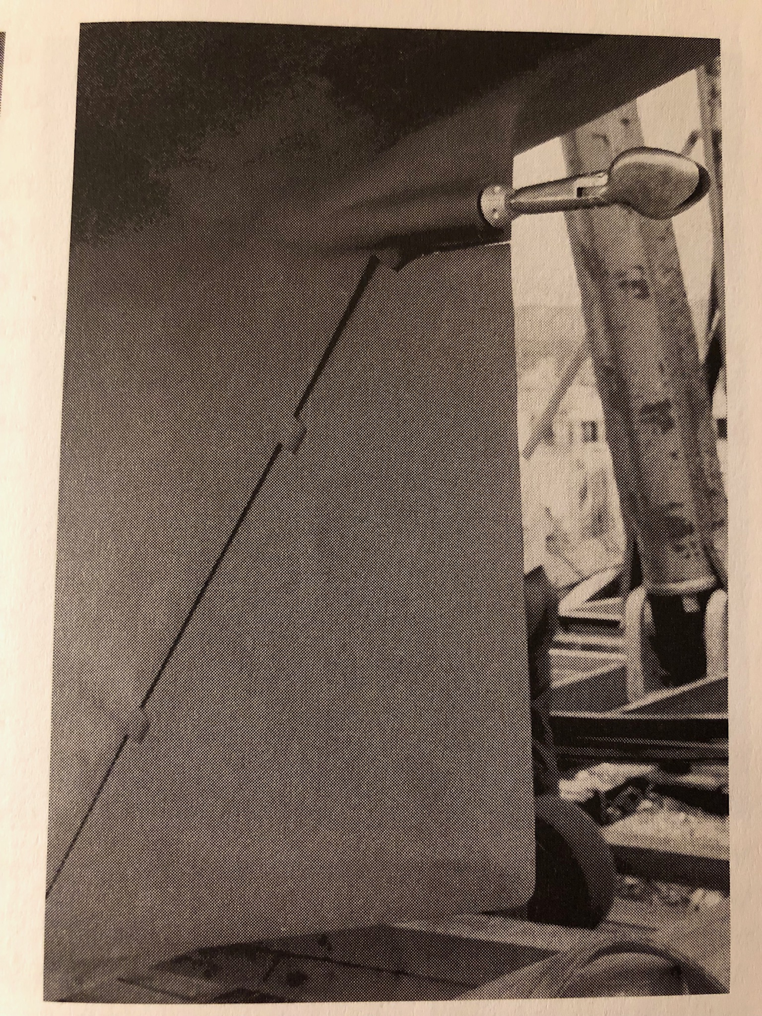

Initial plan is to cut a few inches off top of rudder to allow offset shaft to be faired in to hull above rudder. Small Beta Diesel would turn a flex O Fold two blade folding prop. Major issue to resolve is how deep does the propeller have to be to avoid ventilating.

- Modification designed and built by Hal Roth on his Spencer 35 Whisper.
- B8F5A8D9-568C-4F11-ACB2-DE7916BECB33.jpeg (1.48 MiB) Viewed 9455 times
- Initial plan requires cutting a few inches off the top of the rudder to provide room for off set propeller shaft.
- A2DA01B7-AEE7-4BE2-B5D8-DC944299A626.jpeg (774.2 KiB) Viewed 9455 times

I would think that you have already explored this, but what about a propeller shaft offset to one side of the rudder? Sail drives seem to have few problems being offset from the centerline. I would love to follow this topic and watch your methods.

Hi Tim. I did look into it. For the prop to clear the rudder the engine has to move further forward than I have space available. Not saying it can’t work...I am sure it could. But there is also more drag due to the required P strut and it is more likely to get fouled on lobster/crab pots and sargasso than Roth’s design.tjr818 wrote:I would think that you have already explored this, but what about a propeller shaft offset to one side of the rudder? Sail drives seem to have few problems being offset from the centerline. I would love to follow this topic and watch your methods.

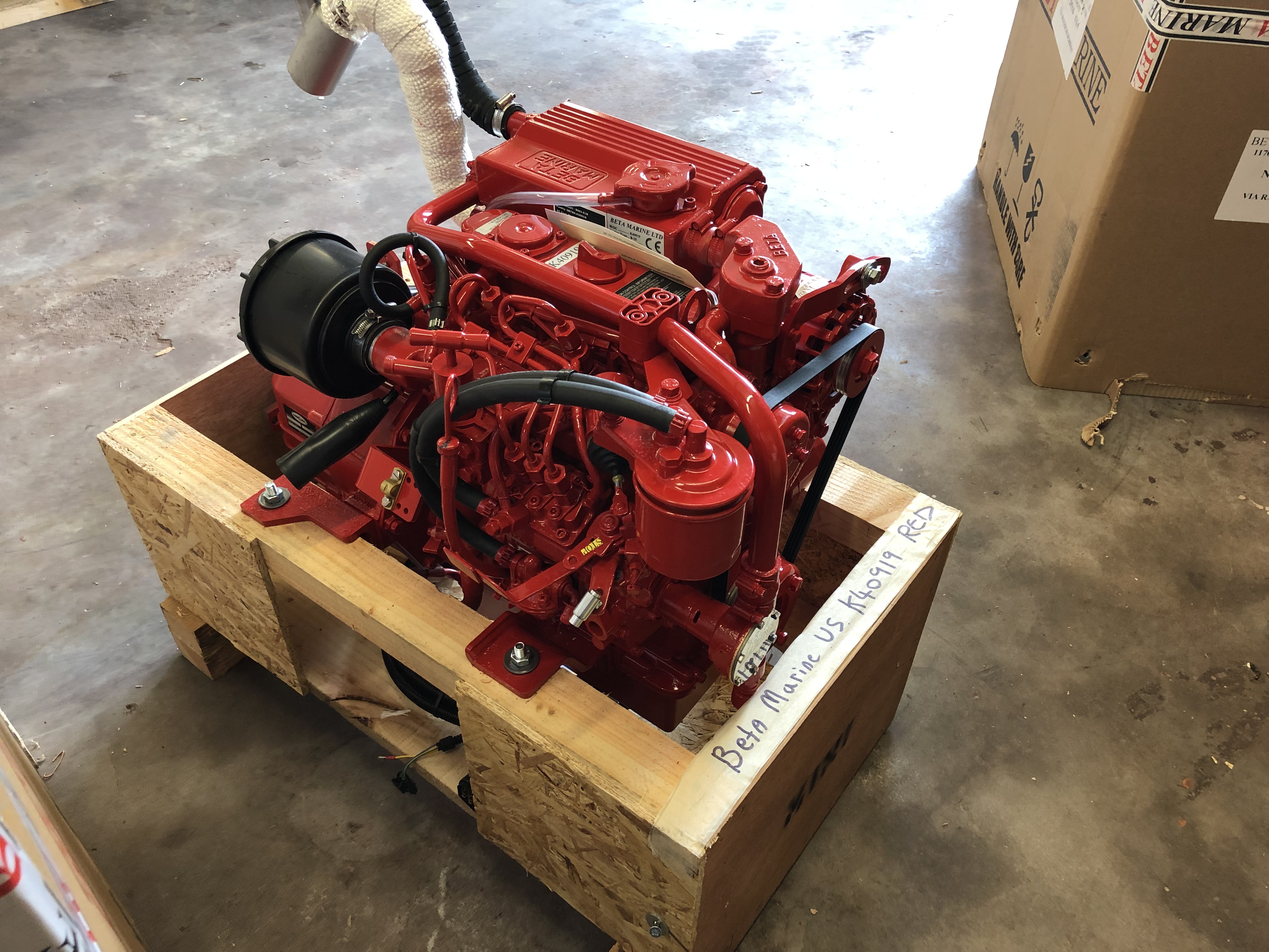

Went by Beta Marina again today. Looked at the 20HP and 25 hp. Different block but almost the same size dimensionally. 25 has a little longer stroke and a tiny bit bigger bore. Wights 30 more lbs. both 3 cylinder.
Building a template this week to see what kind of space will be required and what the impact will be on remaining under cockpit storage and my very convenient anchor storage locker.
Both will easily push the boat at my desired 5 kts (1900-2200 RPM depending on which engine) and burn about a liter an hour. Either engine with 2.6:1 reduction.

- 20HP Beta.
- E3BDBAE6-61F0-4E9F-B829-EB4362212E87.jpeg (3.11 MiB) Viewed 9338 times
- 25HP Beta.
- 530A1AEC-7276-4140-8D33-53E9909974A9.jpeg (2.92 MiB) Viewed 9338 times
All things being equal (30 lbs. is negligible) I would go for the 25 hp unit. I’m still waiting for the day someone says they wish they had gone for the lower horsepower auxiliary when they have gone through the anguish and expense of a replacement.
