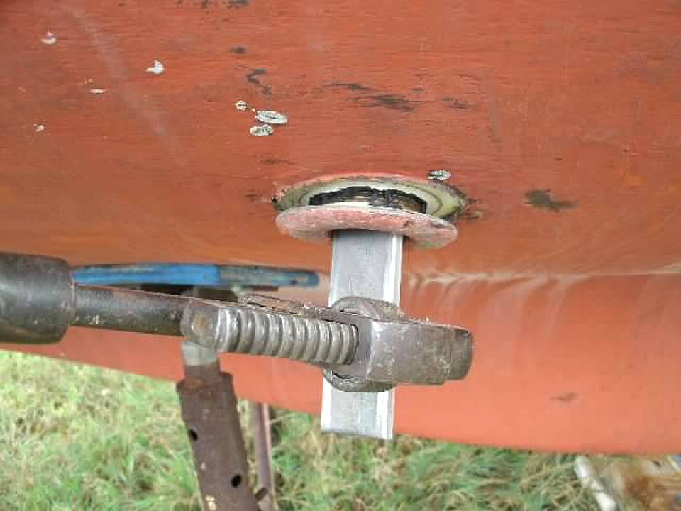

I seem to recall in my case that I could not remove the seacock until the thru-hull was removed because the mushroom head partially obscured the heads of the bolts, but I could be mistaken. In any case if I recall correctly I removed the thru-hulls first. I don't have a step wrench so I used a small piece of rectangular scrap metal inserted into the thru-hull to engage the dogs inside. A bit of heat and a pvc pipe on my wrench for more leverage and I was able to unscrew them surprisingly easily. Maybe some penetrating oil wouldn't hurt.

Unscrew the thru-hull from the seacock, remove the bolts and then lift off the seacock.
I was able to remove all the thru-hulls using a flat metal bar, pipe wrench and a length of pipe for leverage.
Applying a heat gun to the thru hull will help to break it lose, but you probably will not need it.
After scrapping off the heads of the screws, most will unscrew enough to pull out. If not, they can be punched out from inside the boat.

First I removed the hose from each seacock after heating them with a heat gun.
I unscrewed the thru-hull using an old chisel for the larger ones and an old tire iron for the smaller ones.
From outside the boat I pounded the chisel or tire iron up into the thru-hull and then put an adjustable wrench on it with a 2 foot PVC pipe as a breaker-bar.
I didn't use the heat gun and they all unscrewed pretty readily with just some initial heft required.
After that I cleaned off the bolt heads from outside and then lifted off the seacocks and pounded out the bolts from inside the boat.
All in all maybe 3 hours work.
