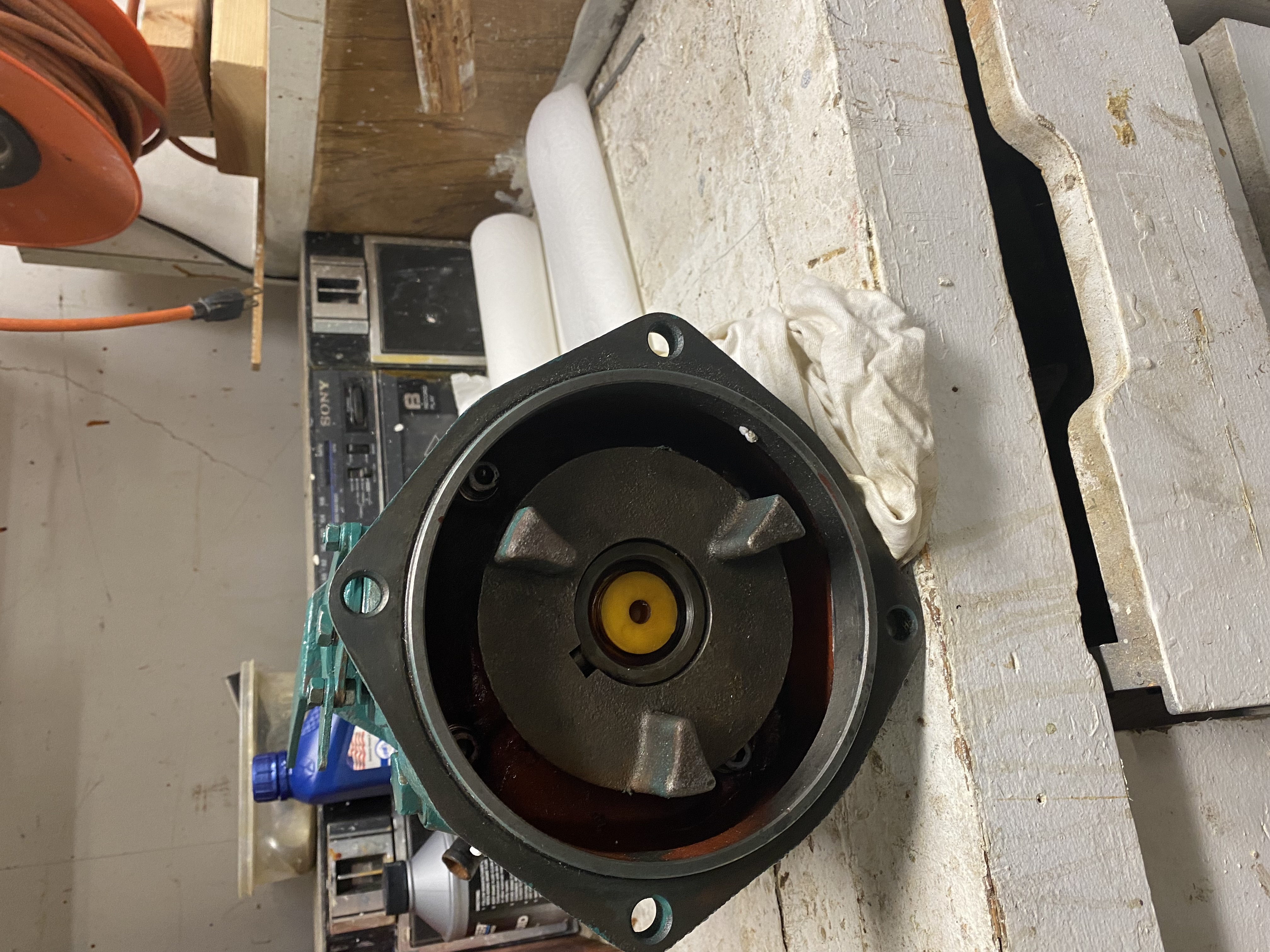

Got complete shoulder replacement last week. So I'll be disable for a while. I ordered a re-manufactured reverse gear off ebay. It arrived safely. I need to hire a mechanic to install it. I think I got the right one. There are different type MS gears for the MD7A . I got one from a guy in WA. who just sold another with attached Walter v-drive. I know that would've been the correct one. He assured me this is correct with the centric flange.(2nd

photo) However the other supplier in EU says I need the eccentric flange..>??? (ABOVE PHOTO) I had my gear out last year and I dont remember having the eccentric flange.. I hope I go it right . I think so. Ebay says I can return it up to 30 days but when I mentioned it to the guy he implied that He hopes I have more stuff to buy. I got the feeling he only intends to give credit.Anyway Im not worried about it.. I am posting a notice on the Marina board for crew to help me run the boat for local cruises. I hope I meet some nice people maybe evan some to accompany me south again next October

The EU supplier was wrong (See previous post). They told me I needed the eccentric gear. The guy on Ebay in Kent WA was right and I got the correct Gearbox (centric ). Yay. Installed it yesterday . I will button things up today and go for a sea trial Saturday. I need to take the mechanic with me .I am really disabled from the shoulder surgery. I hope after a couple weeks therapy I can take her out for a few days. I ll work this gear enough to be sure it will be ok for another trip down to Mexico. Supposedly it is a remanufactured unit. I definately paid for one.

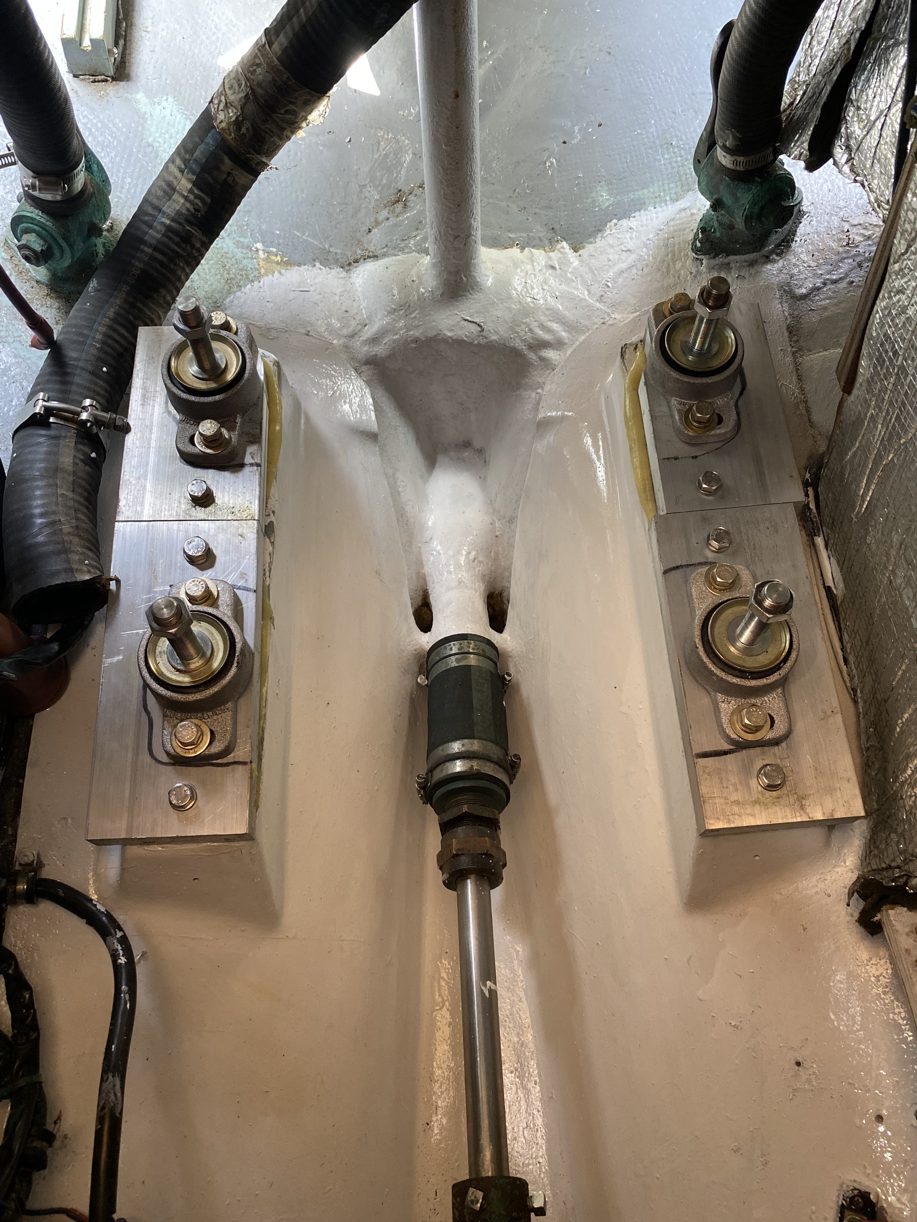

Here is a photo of my engine bed.. I'm not sure what will have to be modified but I want to encapsulate the aluminum plates with fiberglass so it is nice and clean like "Far Reach". Maybe thats not feasable.
Dang My nice rechargeable mag lite went down the hole by the shaft log.. I knew I should have put screen or something over those. I can't get it out.

Can you get the mag light out with one of the long skinny pinchers? Or some two sided tape on a stick? If it went in, there has to be a way to get it out. And why are those slots there behind the stuffing box? Do they lead some where so water can be got out. Must be a sump lower down and forward I can't can't see in the photo?
Seems like you have done everything humanly possible to get that engine and transmission running right. You deserve a medal for perseverance alone. If you can swing a new engine/tranny you will praise God every time you hit the start button and it leaps into action. A new Beta is a great piece of machinery.
Re: Leoma Update 6/10/22
the flashlight isn't visible. Someone suggested I try the shop vac. Maybe I can flush it out with a water hose..
I guess those drain holes are so deck leaks etc. go to the bilge instead of the engine tray
