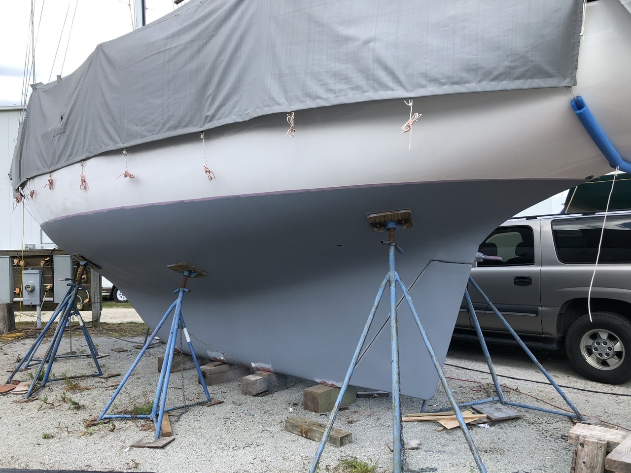

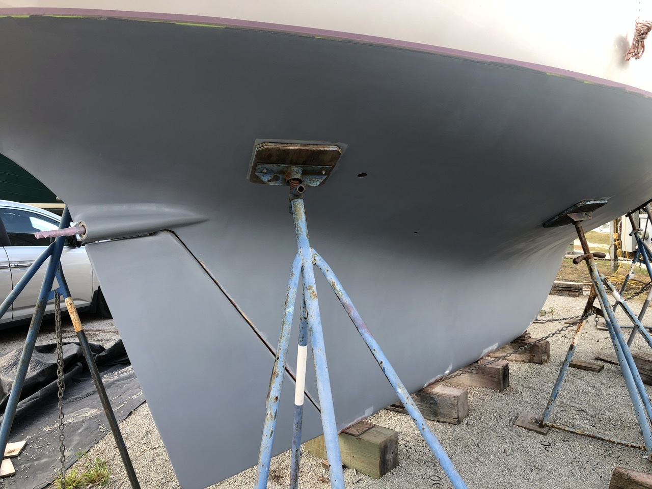

Applied one gallon of barrier coat which gave me 1.5 coats of coverage. I have a total of three gallons so we should get four coats out of it.
The new shaft log and recessed flush mount through hulls look good.
After we complete the barrier coat and bottom paint we will reblock and apply barrier coat and paint to the areas sitting on the keel blocks.
Just keep moving forward Mister.
Three barrier coats complete. One more plus anti-fouling paint.
