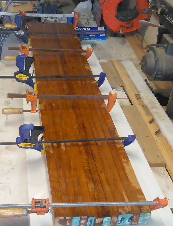

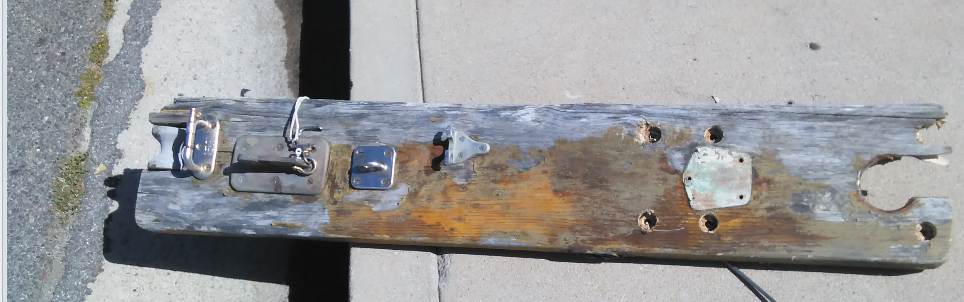

Here is my original and the makings of a new teak laminate one

Your original looks like mine. It is defiantly not teak.

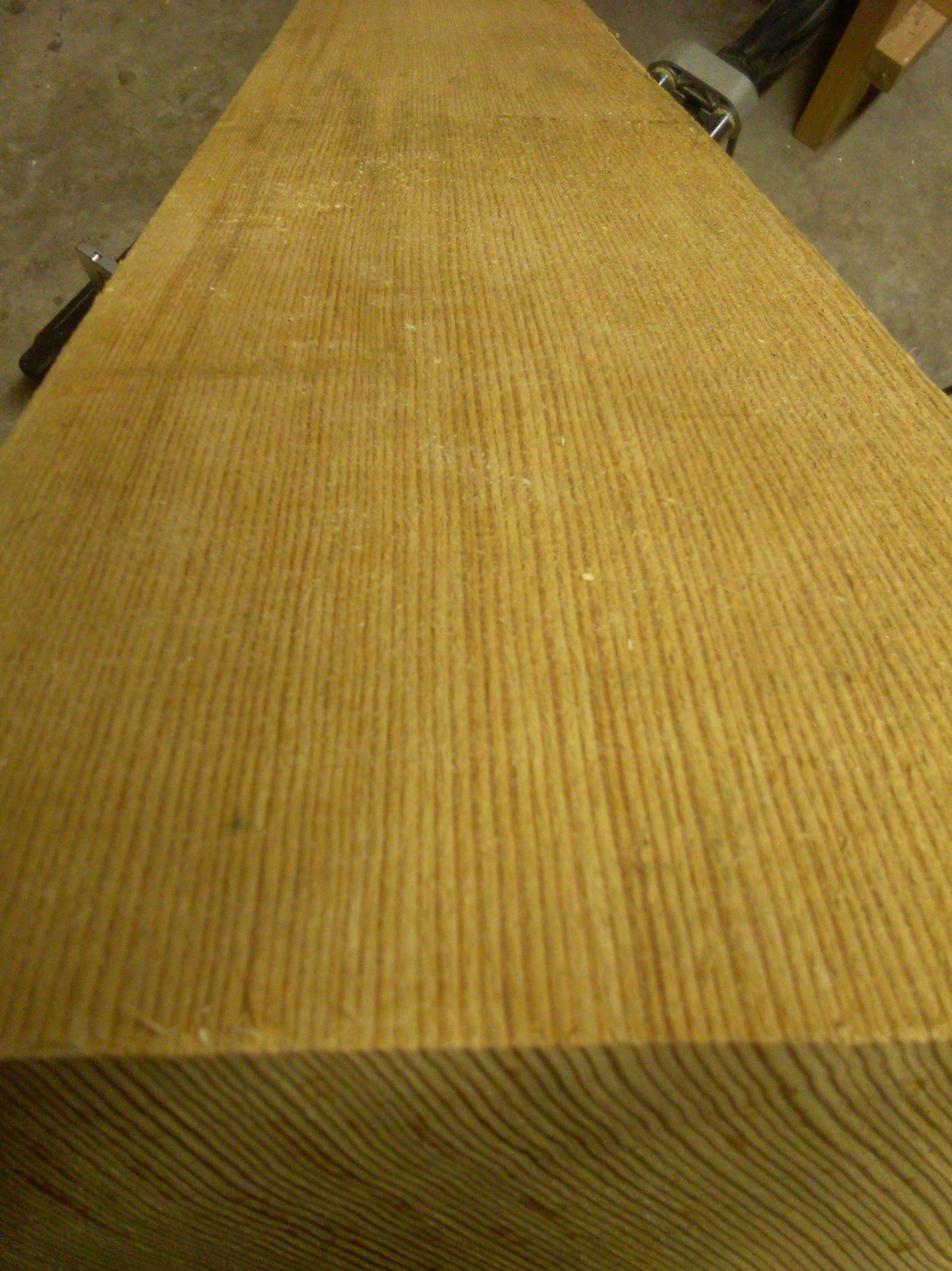

After much searching I found, I think some suitable fir for my bow sprit. They had 4, 2 by 6 by 10 and about 5 other assorted 2 inch rough boards. I bought the two best 2 by 6, one would have done it but when you look a long time for something it doesn't hurt to add a little to your stash. Both boards are about the same.

That’s some nice looking grain. Can’t see the rest of the wood but if it looks as good as that picture you should be good to go! Doug fir smells great when you work it. My friend Kaj Jacobson built the interior of his 34’ Lyle Hess cutter with vertical V groove staving and it’s spectacular. Douglas fir is vastly under related for boat building.

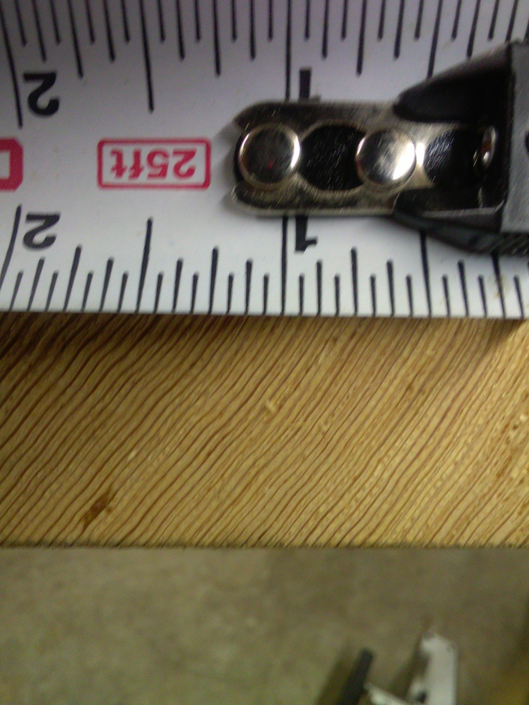

The fewest rings I have counted are 25 per inch, I can't count the ones very close. Both are straight as arrows and there is not a single knot. I may get it ripped today or tomorrow while I'm still out on Covid pay. dee
