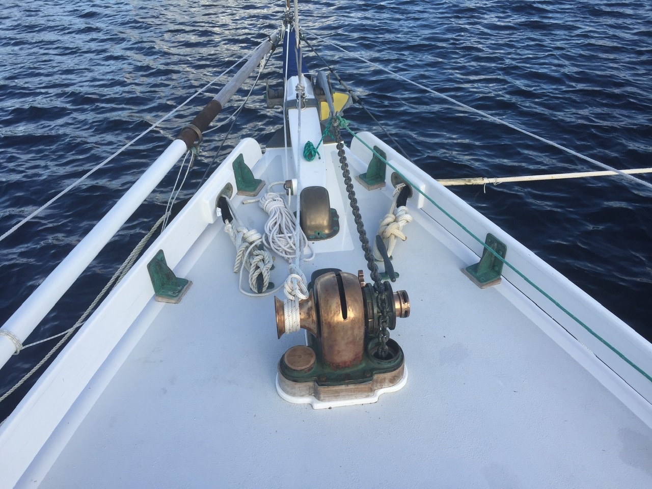

Here is a post from a while ago. He has the rollers off the sprit like you mentioned. PM him, (Jim/ Wikakaru) and ask how its working out and I think he has a manual windlass.. I have the same setup as Bernie with the Lewmar windlass. I keep a canvass cover on it and don't have any problem with water getting in the locker.
- Screenshot_2020-12-22 The Cape Dory Board • View topic - Leoma update 8 20.png (1.44 MiB) Viewed 723 times

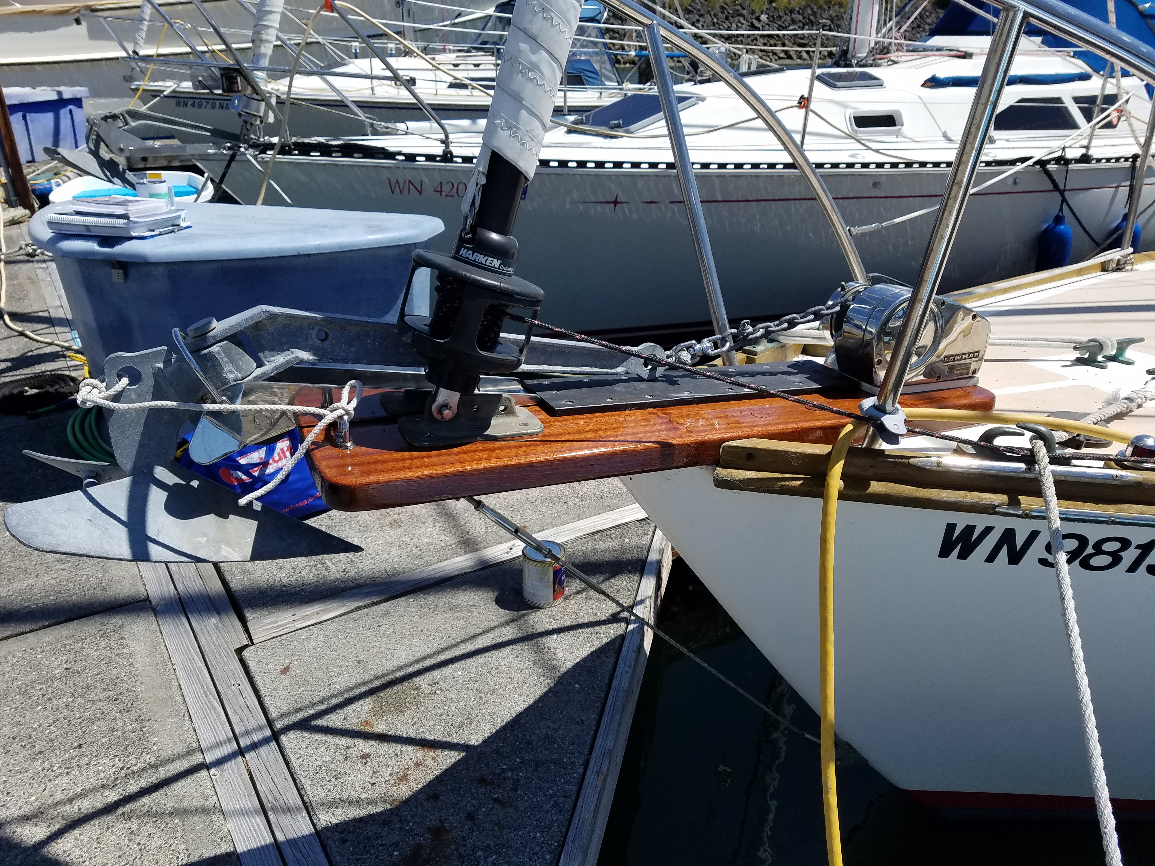

Re: Locating anchor rollers and windlass on new bowsprit
I have a different set up than a stock boat. But the attached picture gives an idea about alignment. It’s is critical to making the system work effortlessly.
Your going to use a Nylon snubber once your anchor is set. If you can lead it over the end of the sprit, or offset to a block under the kranze iron like I do, then you won’t have to worry about chafe of the snubber on the bobstay.
I have a sunbrella cover I keep over the windlass. That’s all I use except when I am offshore. Then I detach the chain and seal the chain pipe (spurling pipe as Todd Mills has taught us) with a bronze cover.
Never had any water ingress.
