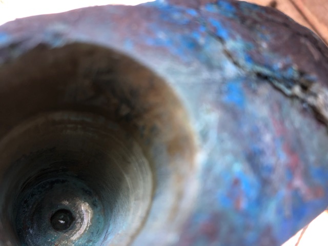

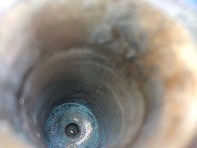

Here's my latest update on the loose rudder issue. On Saturday I was able to get a good look up inside the hole in the bottom of the rudder and sure enough there is a cup up inside there (see pics below). The cup on mine is definitely bronze. I scraped the top and sides to confirm. Not sure if the pics will show it on this site. The depth to the top of the cup is about 3" and the pintle is about 3 3/4 " so that confirms that the top of the cup rides on the top of the pintle to support the weight of the rudder which is easily confirmed by simply pushing the pintle/shoe assembly up into the hole and sure enough it bottoms out with about 3/4" space between the bottom of the rudder and the top of the shoe. The cup does not come all the way down to the bottom of the rudder hole so there is about 1" of fiberglass as you look up the hole then you can see the bronze cup for the next 2" to the top of the cup. The curious thing to me is that the hole diameter is 1 1/8" in the bronze cup and even about 1 1/4" in the fiberglass lead in portion. Now 1/8"-1/4" doesn't sound like a lot of play but when you side load the bottom of the rudder port to starboard the amount of play is surprising and makes quite a bangs which I described earlier in this thread.
So now that I know exactly what I'm dealing with I have decided to go with Johns method of the delrin bushing. I have designed what I need and ordered the material then will get it turned to my dimensions. I received the bronze sleeves from McMaster but the are designed for a 1" precision ground shaft which would be to the minus side of 1" our pintles are not precision ground. I would have to take the pintle diameter down at least a few thousands and quite frankly I think it would be to tight of a fit SS to bronze. I had a similar issue on a boat years ago where salt crystals bound up a SS shaft to a bronze bushing and it was hell to free it up. It turns out the solution was lots and lots of hot water to dissolve the salt crystals. But I digress. Bottom line now that I know the bronze cup is taking all of the axial load the delrin bushing will be perfect to take up the lateral load and eliminate the banging.

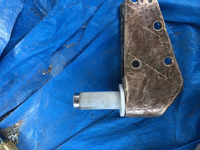

I got the delrin bushing machined to my design and with a little bit of sanding got what I deemed to be a perfect fit on the pintle and into the bronze rudder bushing.
delrin bushing on pintle.jpg (141.18 KiB) Viewed 1415 times

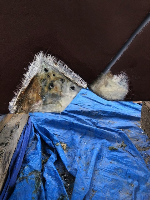

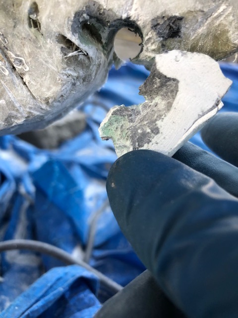

The next issue to deal with was the extremely porous glass buildup at the back of the keel where the shoe attaches. As you can see from the pics there were large worm like holes and chunks that fell off.
worm holes and loose chunks.jpg (86.54 KiB) Viewed 1415 times
I painstakingly built it back up with epoxy and glass. Lots of iterations of glassing and sanding to get it right. But alas I was victorious.

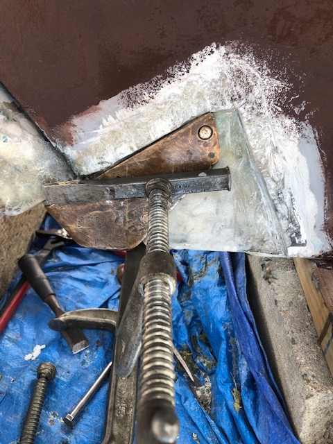

The next challenge was peening over the four bronze pins with out a helper on the other side. I got inventive with a c-clamp and chisel.
backer for peening bronze pins.jpg (137.29 KiB) Viewed 1415 times

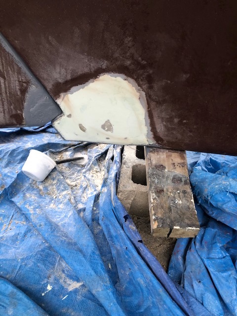

Next I glassed over the shoe, barrier coated and applied bottom paint.
glassed over, faired and ready for barrier coat and bottom paint.jpg (113.39 KiB) Viewed 1415 times
Then launch!
