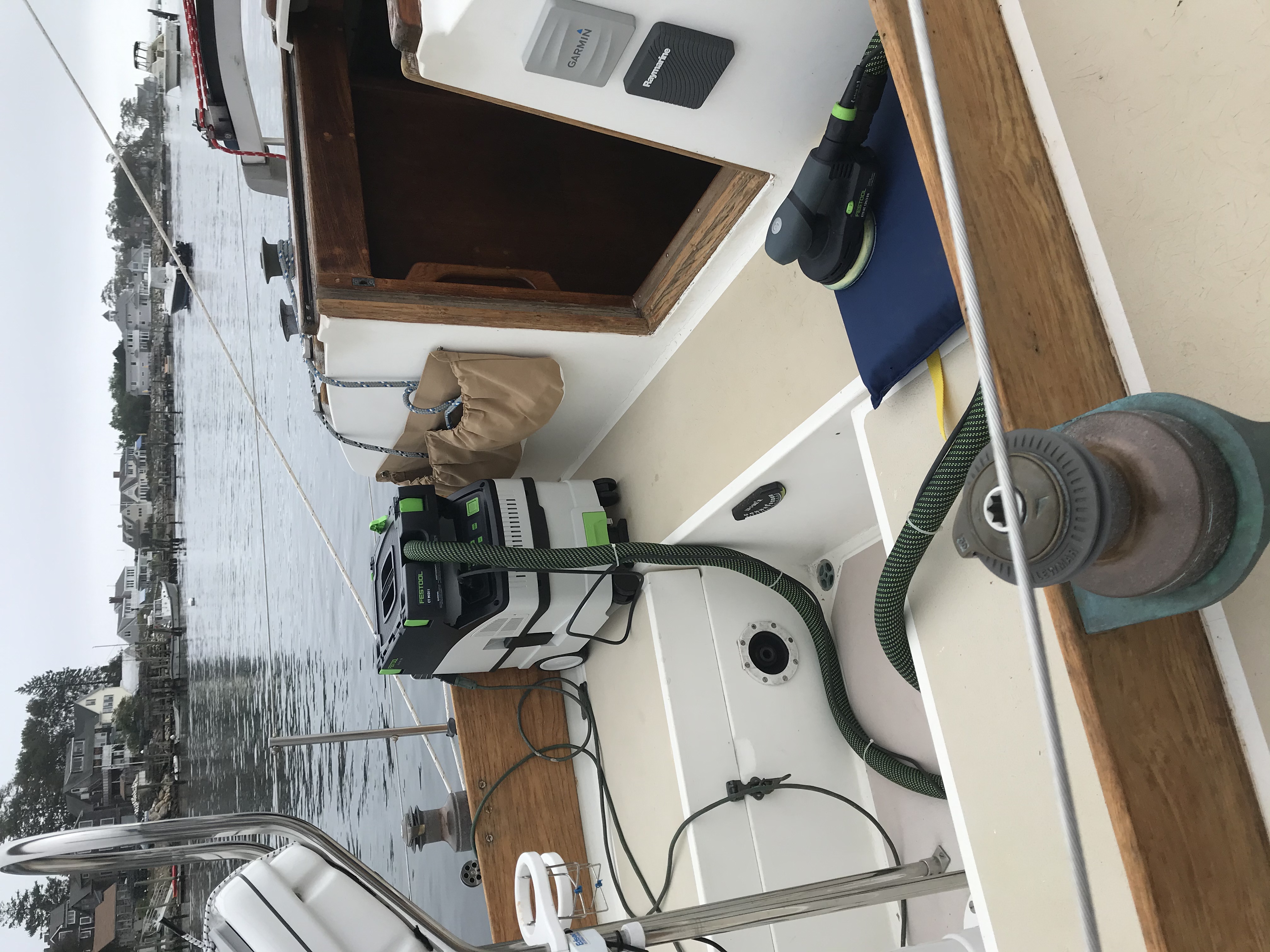

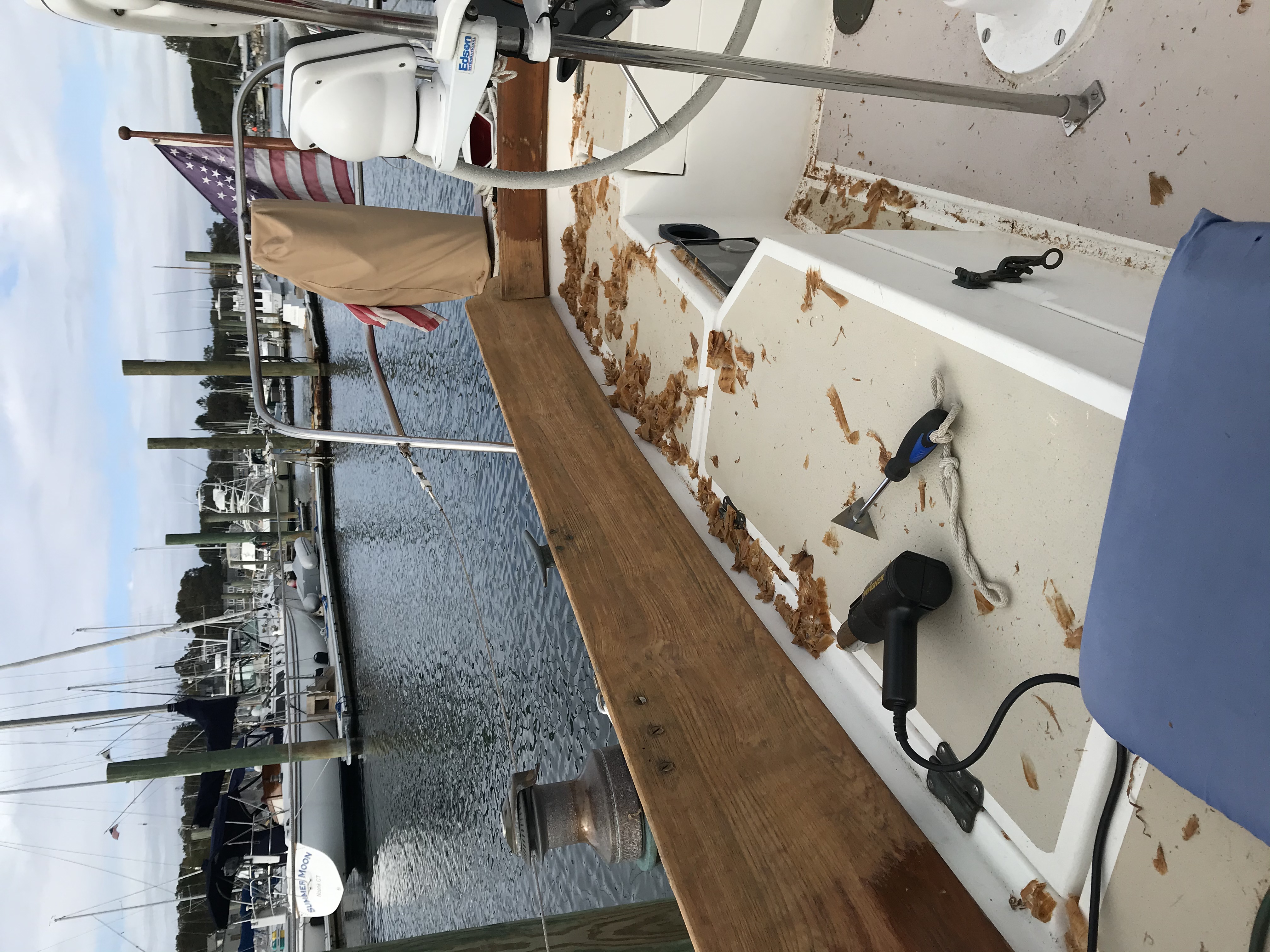

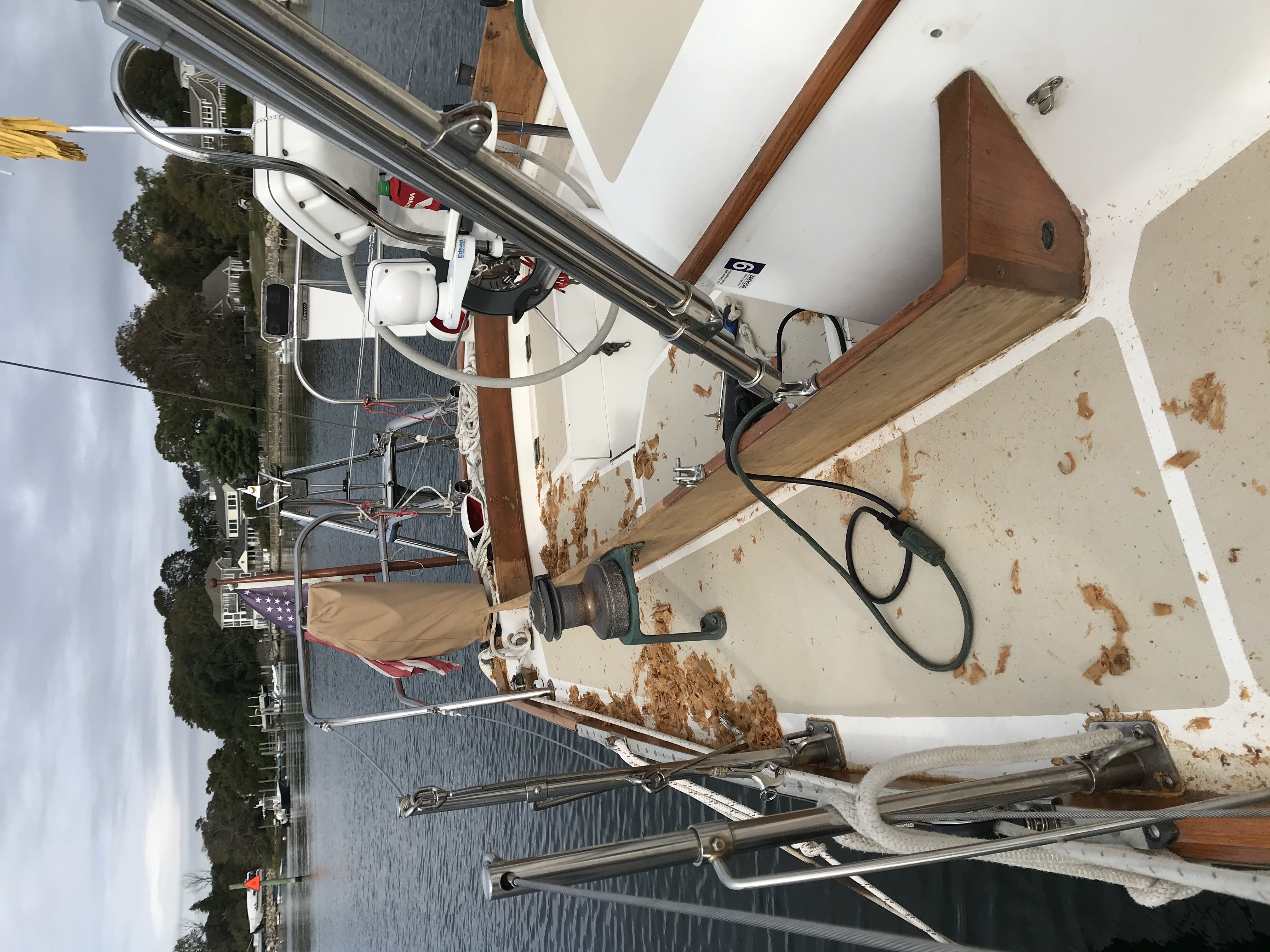

I’ve been busy since the first week in September attending to Orion’s brightwork. It’s an onerous task (interspersed with day sails) but the end is near. After stripping with a heat gun and scrapers, the lightest possible sanding, plugging and bunging some old scars, it’s finally time to apply the finish of choice. For me it’s Cetol Light once again. All I need now are four decent application days and it’s time to do some sailing.

Nice job, Jim. I see you have some "fine" equipment on hand and a fine go-with work ethic.

Thats gonna look good when you're done. Teak looks so good but hurts so bad to make it look nice. Dennis

Wow, what a lot of work, Jim! Nice results so far with minimal loss of the teak.
