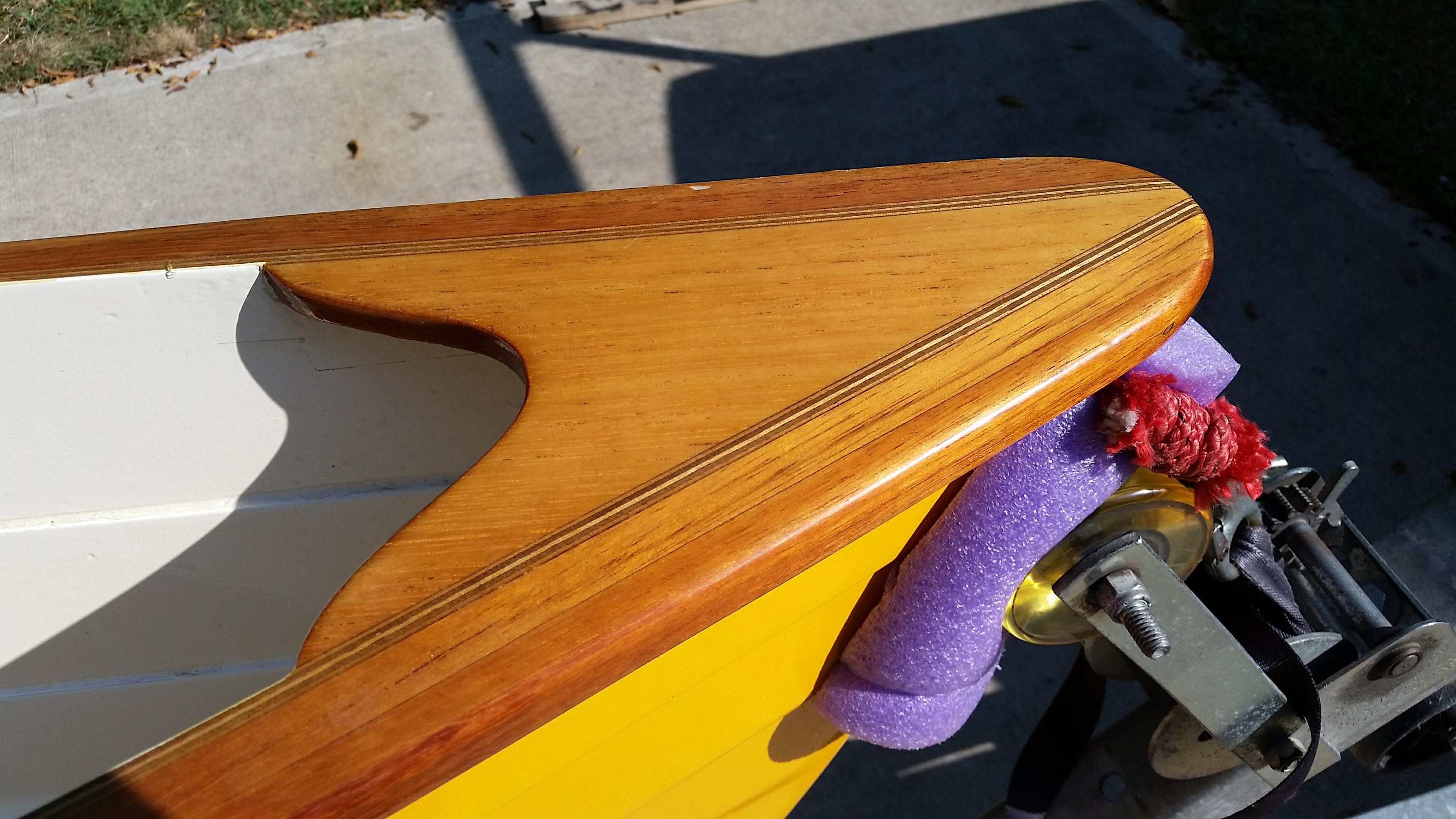

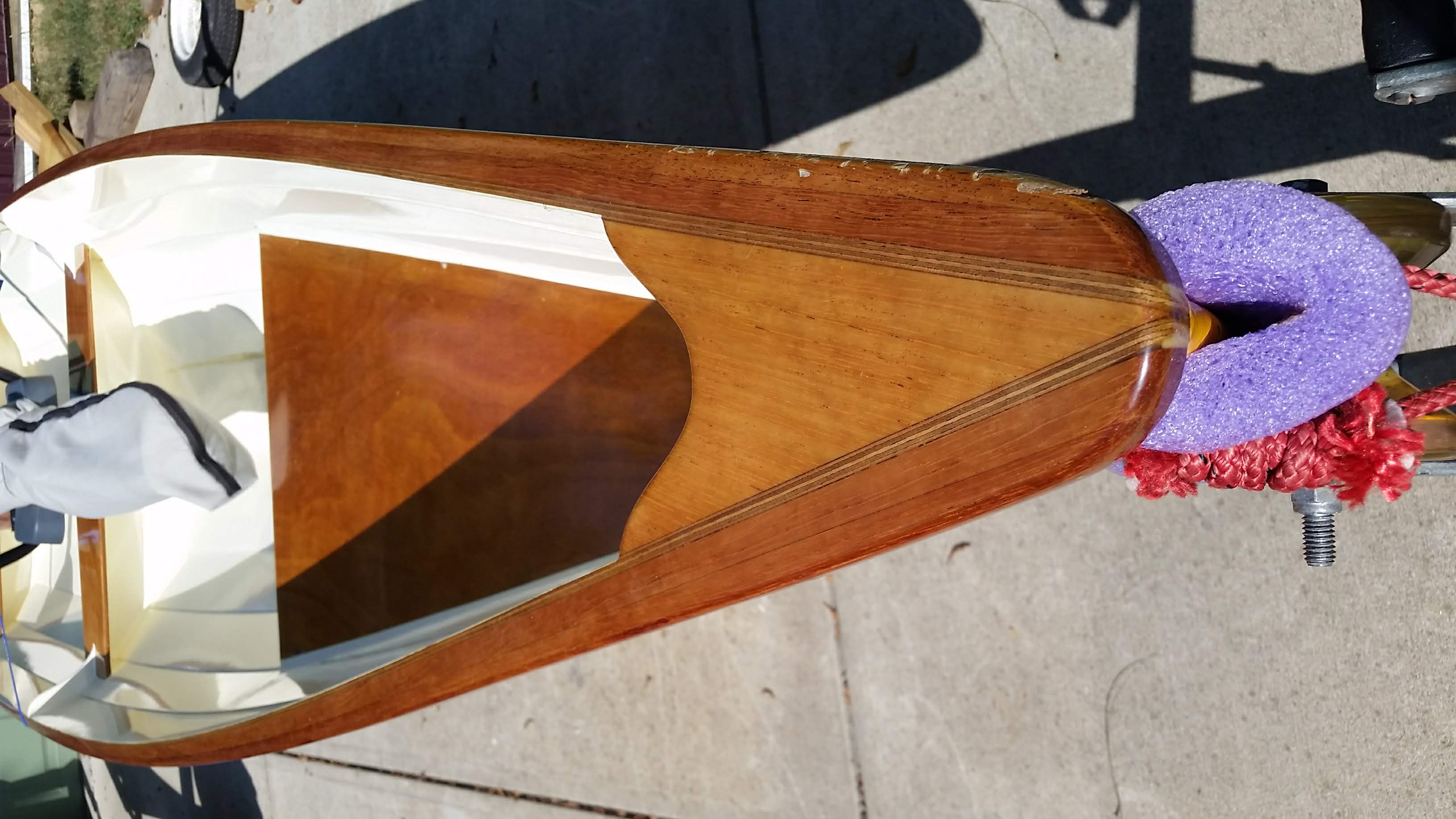

This technique is widely used and well accepted. Andy Miller on Boatworks Today has a video describing this method.
If done properly, there should be no reason to "strip" the epoxy from the wood. If the varnish surface starts looking bad, you can sand and renew it without removing any epoxy. If the epoxy gets damaged somehow, you can sand off the varnish and add a new coat of epoxy. You should never need to expose the bare wood again. Prerequisites for a good job include careful preparation that removes any oils and old finishes. Some previous owners may have used stuff like silicone deck stain or other stupid coatings that render the wood unable to take epoxy, even after sanding and washing with strong solvents (don't ask me how I know). The other thing is to use a non-blushing, low viscosity resin like Mas LV. The resin saturates the wood surface and creates a thin layer of wood-epoxy "composite" that resists damage better than the wood under varnish alone. It also provides a perfect substrate for the varnish. Finally, you must use an excellent varnish. I use Petitt 2015 because of it's UV inhibition.
The pictures below are of my 10 year old wooden Annapolis Wherry, a 18' stitch & glue rowing boat. The hull is planked with Okume plywood, the gunwales and deck are mahogany. Although the boat is stored in the garage, it gets extensive use in all kinds of weather. The entire boat is was coated with Mas LV before painting. The decks and gunwales are finished with the epoxy-varnish system. They were varnished with Petitt 1015. I have not done anything more than wiping it off after rowing, and very occasionally washing the boat. The damage visible to the port gunwale was where a mouse decided to sharpen its teeth one winter. Otherwise, it is holding up rather well I'd say.

LilYachty wrote:This technique is widely used and well accepted. Andy Miller on Boatworks Today has a video describing this method.
