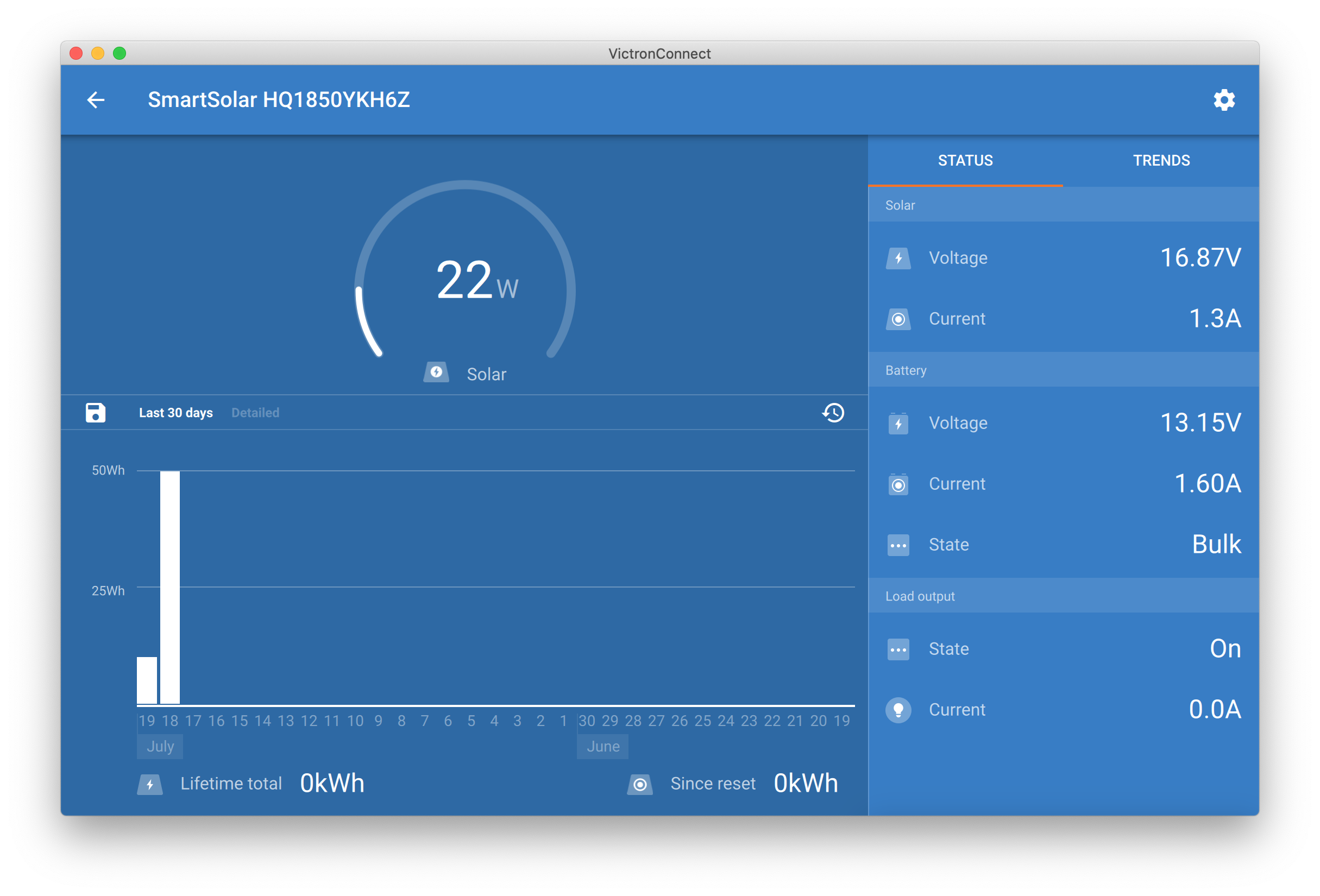

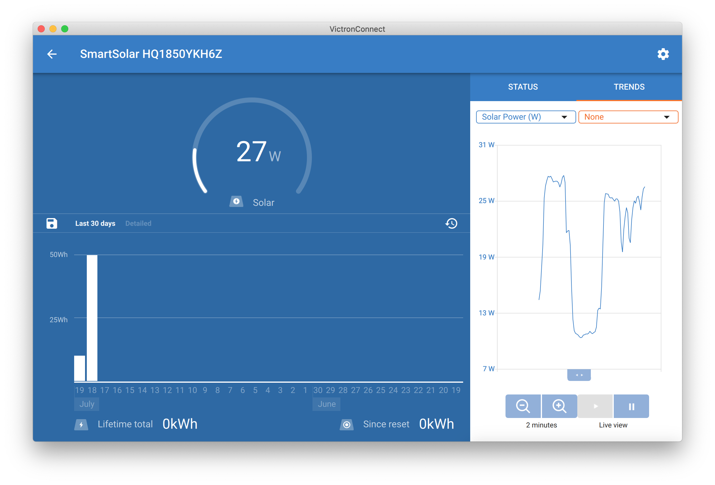

I have this all wired up in my backyard and it seems to be running just fine. In full sun without any attempts to aim the panel I'm getting 30-some watts out of it, which is right in line with my expectations. Victron offers two versions of their controller, one with built-in Bluetooth and one without. I spent the extra for the BT connection and I'm glad I did. Their apps seem to work well and provide good insight into the performance of the system.
Victron's Mac app
Victron's Mac app
Screen Shot 2020-07-19 at 11.14.46 AM.png (680.08 KiB) Viewed 1126 times
Current metrics from the app
Screen Shot 2020-07-19 at 11.13.48 AM.png (673.75 KiB) Viewed 1126 times

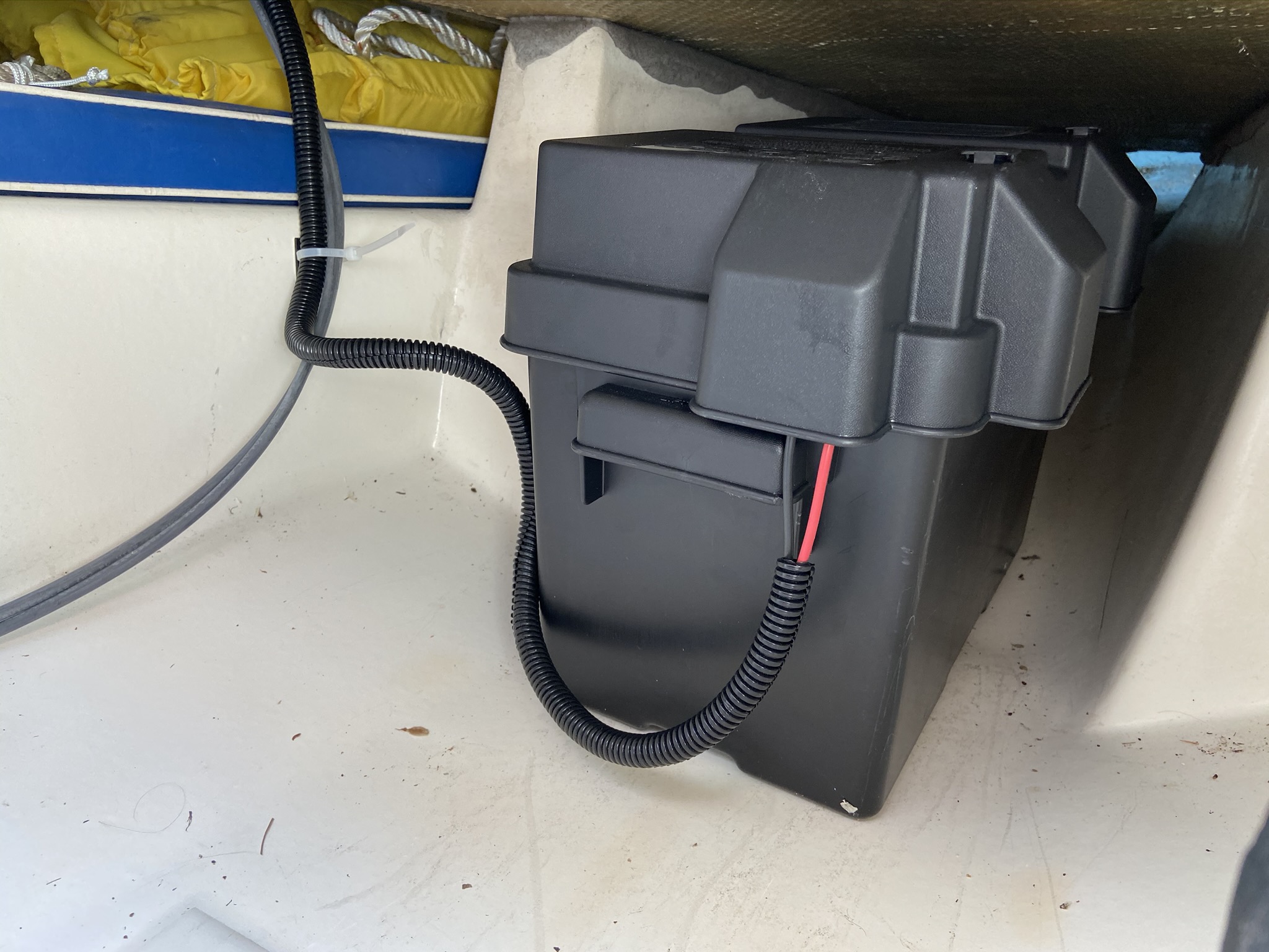

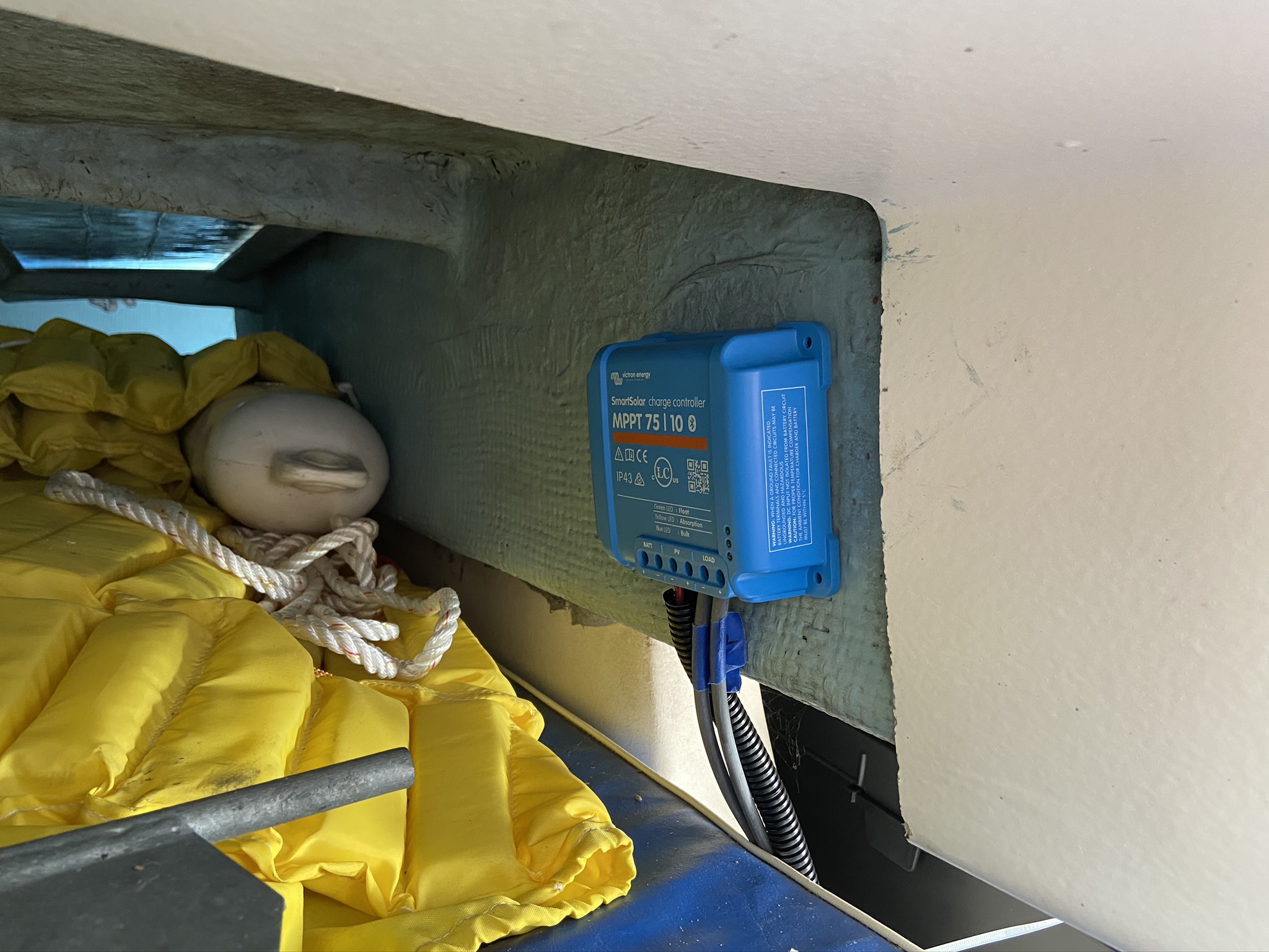

I wouldn't say I have the setup finalized, but it's all assembled and working. I "installed" the charge controller in the starboard quarter berth with some self-adhesive velcro (the heavy-duty kind). The battery box lives under the cockpit sole. Some 8 AWG leads run aft under the sole and terminate in an Attwood trolling motor socket. The motor itself has the corresponding plug, which makes it easy to attach/detach.
Attwood trolling motor plug installed
NOCO group 27 battery box
Victron charge controller

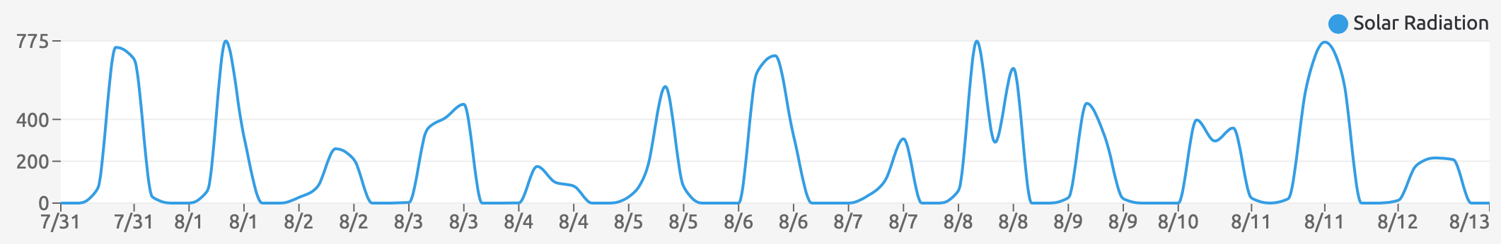

Lastly, this graph of solar radiation from my weather station gives some idea of how sunny each day was.
Sun history
Sun history
Screen Shot 2020-08-15 at 9.32.54 AM.png (116.55 KiB) Viewed 1058 times
