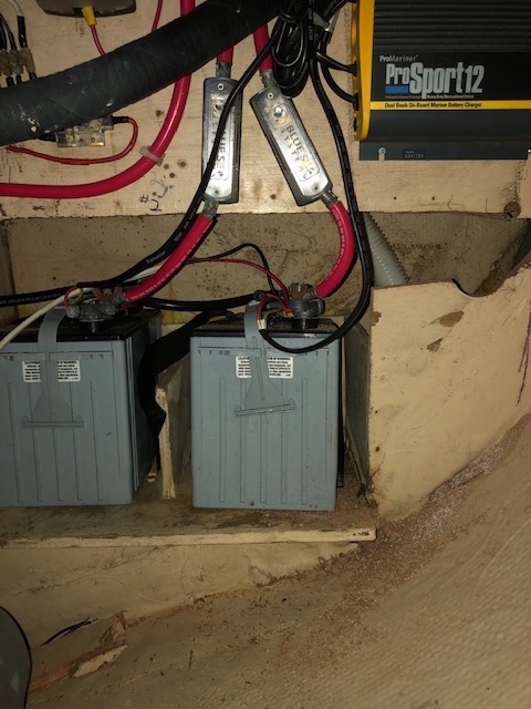

Hi All,
The battery compartment upgrade from 2 batteries to 3 is complete. See pics below. I also cleaned up the wire routing quite a bit.
Battery compartment before.jpg (104.22 KiB) Viewed 686 times
Battery compartment inprocess.jpg (98.52 KiB) Viewed 686 times
Battery compartment after.jpg (98.5 KiB) Viewed 686 times
Keith

Keith,
Looks really good!
Jeff
