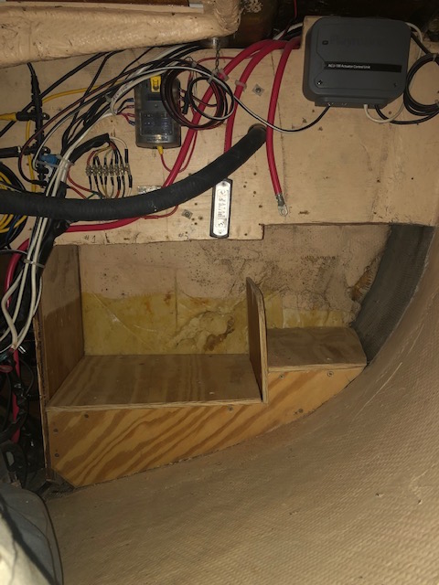

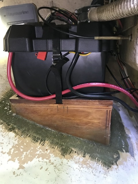

Orion now has a three battery system. Orion has always had a two battery bank. Since I have owned her this has consisted of a flooded group 27 starting battery and a flooded group 31 house battery. Since I decided to add refrigeration I thought it prudent to go to a two battery house bank along with a dedicated starter battery.
The best place to add a battery shelf was determined to be in the starboard cockpit locker all the way aft. This was essentially an unused space and the addition of a battery box would not adversely effect the items currently stored there. When my icebox was loaded with 70 pounds of ice I sat on an even keel. With the addition of refrigeration I had a slight list to port. The addition of this battery will cure that.

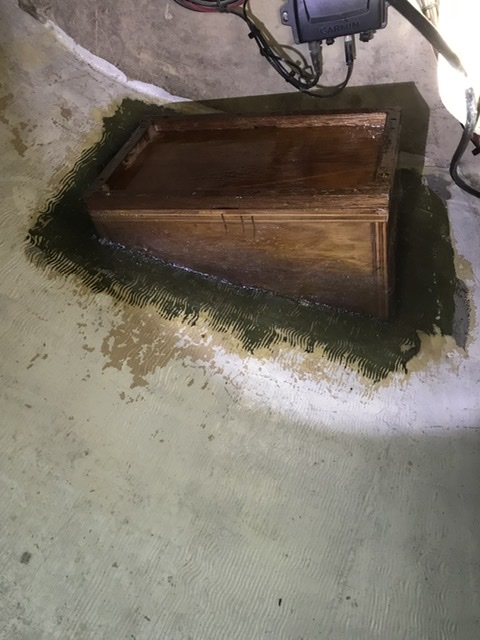

The new battery shelf was constructed of 3/4” exterior ply (with considerable assistance from a skilled carpenter, thanks Steve) fastened with stainless screws and thickened epoxy, then coated throughout with epoxy. I used a 2 1/2” hole saw to make a vent hole on the low side to ensure any condensation which might form on the hull would not build up in a sealed space. This shelf took a lot of trial and error until it fitted snug against the hull because of the compound curvature of the hull in this area. Once I had it fitted I drew the outline of the shelf on the hull and used 40 grit sanding disks to get the area down to bare fiberglass to ensure a proper bond when it was glassed to the hull.
Since I wanted to be certain that this shelf would never come adrift I had a pro do the fiberglass work. One has to know one’s limitations. I’ll get in there with some fresh bilge paint once winter is over.

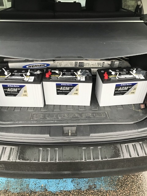

My original intention was to just add a third flooded battery but then I started doing some research, mostly because my batteries were from 2016, and I decided to go with AGM batteries. I found that East Penn makes AGM batteries which they market themselves and they provide AGM’s for several retailers who just put their labels on the East Penn product. Defender had the best price and I was going to wait for their spring sale knowing there would be some discount given. Luckily West Marine had a 20% off sale a couple weeks ago, same East Penn battery as sold by Defender with a different label, so I took advantage of it. I purchased three group 31 AGM’s.

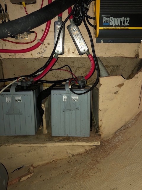

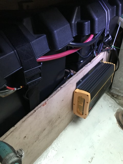

Great minds think alike! I'm in the process of modifying my two battery compartment to three. On MOONDANCE the battery compartment in under the bridge deck on the starboard side. You can see in the pics that I'm cutting out the old somewhat rotted plywood and replacing with new. The third battery had to move up a bit due to the curvature of the hull but I offset the higher center of gravity by lowering the other two about an 1 1/2". I tabbed mounting blocks to the hull so that the entire new assembly can be easily screwed in instead of the permanent stapled structure that the factory had. It is all painted now and just has to be screwed together in place. I bought two AGM group 24 batteries in 2013 so they will be on their eight year and still holding up well. At that time I upgraded the cables to 1 AWG, shortened them significantly from what the factory had and added 250 amp fuses very close to the batteries. I also just purchased the third battery at the West Marine 20% off sale as well. The new battery will be the starter and the two old batteries will be the house bank. I will send the final install pics in a few weeks after it warms up a bit and stops snowing.

Nice work. I have a Blue Seas terminal stud fuse block on each battery. After reading Maine Sails article a few years ago I added them. Can’t be too safe with the stuff of which I possess only a rudimentary knowledge. I know only enough about electricity to pay it all due respect.

Thanks Jim,
I just noticed that you have slotted the plywood to run the battery hold down straps through. That is a great idea instead of the screwed down plastic battery hold downs. Looks like I have to cut six new slots in the bottom boards.

Thanks. Those slots are cut into the cleats, made of decking hardwood, which are screwed and epoxied to the top of the plywood box. Steve Laume came up with this useful feature.Keith wrote:Thanks Jim,
I just noticed that you have slotted the plywood to run the battery hold down straps through. That is a great idea instead of the screwed down plastic battery hold downs. Looks like I have to cut six new slots in the bottom boards.![]()
