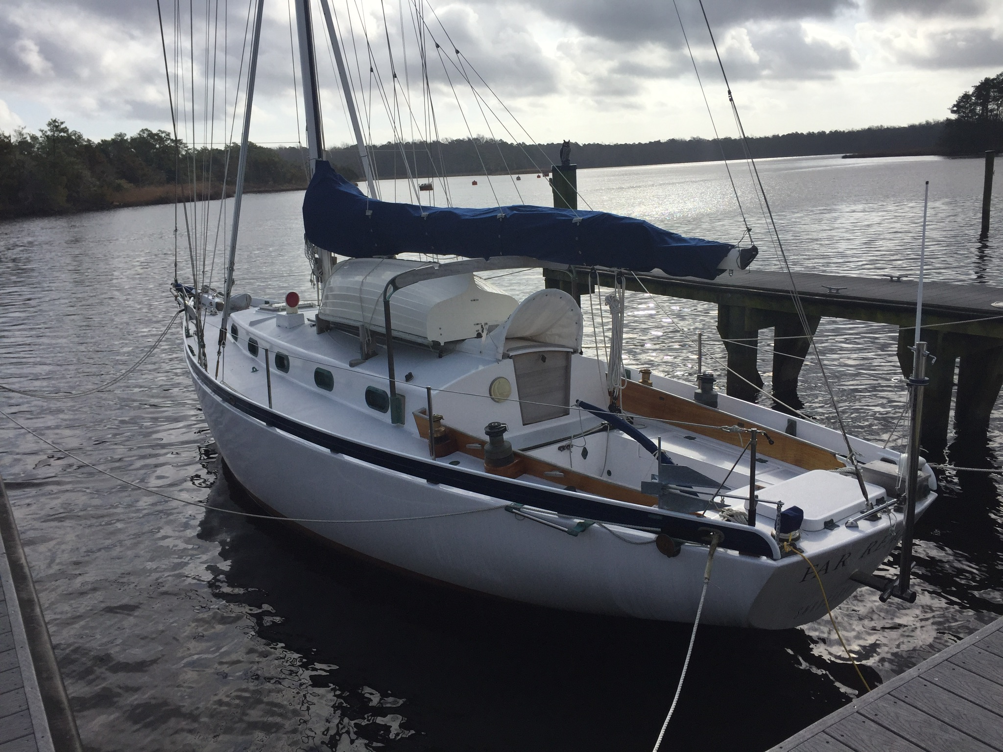

Here is a picture of the Far Reach without a stern pulpit. We are able to board her effortlessly.
