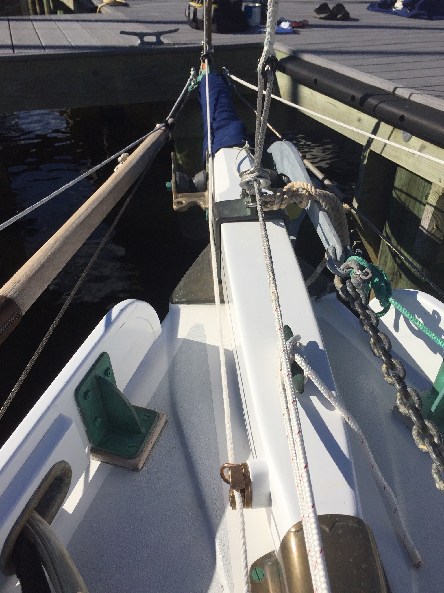

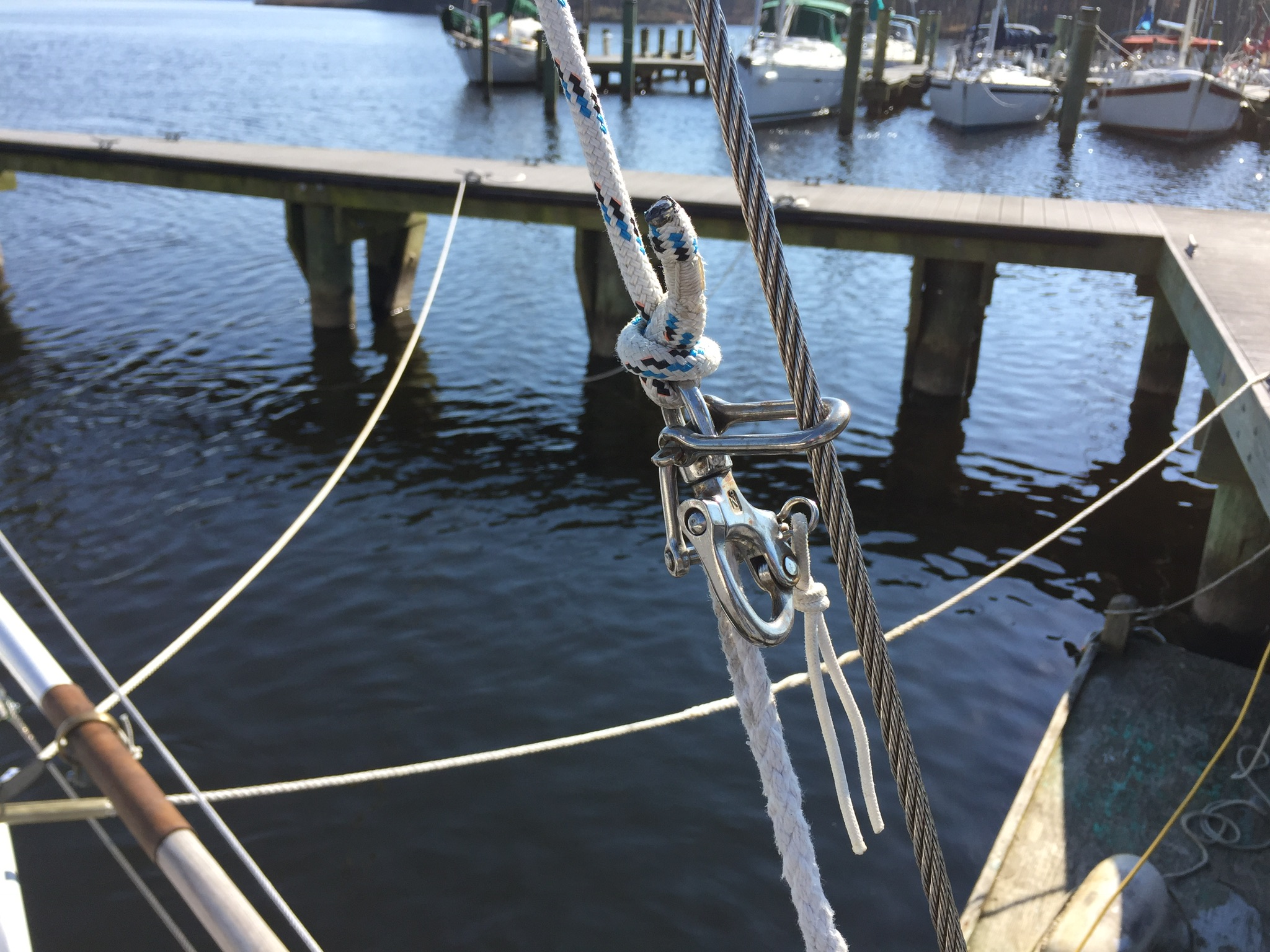

We use a jib downhaul as part of our headsail handling system. A jib downhaul is a line (in our case 1/4” 3 strand dacron) that is attached to the jib halyard shackle and then shackled to the headstay. It remains connected to the halyard regardless if the jib is raised or lowered. The downhaul runs down through a low-friction ring seized to the jib tack fitting and then leads aft to the foredeck. When you let go the jib halyard and the sail drops you just pull on the downhaul ensuring the jib comes all the way to the deck and thus it can’t be partly blown back up the headstay. Unless you are into drama and high adventure, when you drop the headsail you have to know it will come all the way down and stay there. That’s what the jib downhaul is designed to do...help pull the jib down when the wind is up and then keep it down.

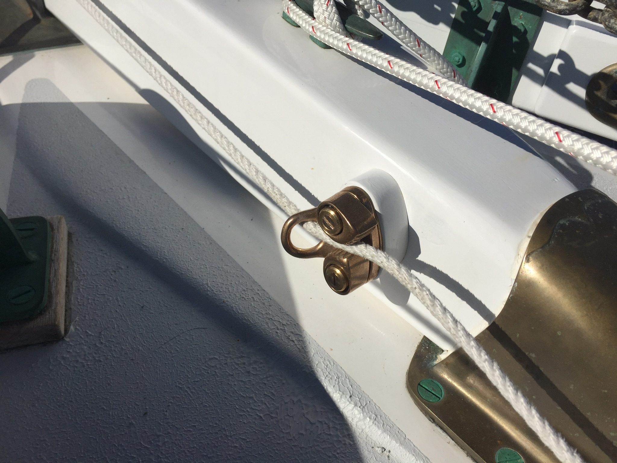

The thing is, I had not figured out a good way to cleat off the running end of the downhaul. For two years I simply tied it off to the forward port stanchion with a round turn and a couple half hitches. It worked but it was not ideal. It took two hands. It could get hairy at night, off-shore or not, to get the jib down and secured. I thought about installing a cam cleat to quickly secure the downhaul. I did not want a Harken or Schaefer cleat for a location I knew would be bathed in saltwater. Also, aesthetically, a modern cam cleat would clash with bronze deck hardware. And, it needed to have an integral fairlead to capture the line in place because the cleat and line ends up under the sail when its down on the deck.
A couple years ago, I read a review in WoodenBoat magazine extolling the quality of hand-made bronze marine hardware JM Reineck and Son. I sent away for the catalog—only about 5 pages long. Jim Reineck did indeed make a bronze cam cleat with a double row of delrin ball-bearings and an integrated fair-lead. Looked perfect. I had seen a similar one used for the same purpose on another boat I have long admired. But it was too expensive. I lusted for it for about a year. I kept looking at it in the catalog. Finally, I could resist the temptation no longer. I called Jim Reineck. He was very personable and answered all my questions. I gave in and ordered it. It arrived a couple weeks ago and it is in fact a gorgeous piece of hardware. But, it’s not bling. It’s got a real job. It’s well made, tough, and is designed for combat. I installed it last week. I have not had a chance to use it under sail but I have practiced with it at the dock. I think it’s going to work out well. Still not as convenient as a furler. But, it’s a simple solution for simple system.

Usually, I am on the foredeck since I can't see lowering the jib from anywhere, well except maybe at the mast. With the genoa at full hoist I can stand at the mast to release the halyard. The end of the downhaul is long enough that I can hold it in my hand at the same time. Most times, I have a turn on the winch with the halyard. Then, I take a step or two or three forward—whatever is required—let the halyard slide through my hand while I pull on the downhaul. Or I might just let go the halyard and start hand over handing the downhaul to keep up. The nice thing about the cam-cleat is by pulling the halyard to the starboard side I can snap it into the cam cleat. By snapping it to the left it is pulled out of the cam cleat but is “captured” by the fairlead so I can snap it back into the cam-cleat if desired. I can do that from a reasonable wide area on the foredeck. In other words, I don’t have to be in a specific place to operate the downhaul. Of course, as you know, as soon as the jib starts dropping you have to gather it in so it doesn't land in the water. Down wind I try to blanket the Jib behind the main and usually it drops right down onto the deck.
There is no way around going to the foredeck—got to gather the sail and secure it to the bulwark with sail ties and one around the sail and the bowsprit. I feel safe on the foredeck in most conditions. The 7” tall bulwarks help. But I have crawled up to the bowsprit and hooked in a safety line when the situation required it. I have been scared sh#tless a couple times too—at night off shore when the wind and seas were up and it was dark--I was probably wondering how much a Harken furler would cost! But I kind of like that feeling. I enjoy the preasure of having to depend on what I know and use my wits to sort things out. I’m not a nut or foolish, at least I don’t think so, but I like things that are hard, else why do it? If it’s easy anyone can do it and what would the challenge and reward be? I am sure that is not sounding quite the way I mean it. Anyway I am starting to ramble. In average conditions there are no heroics involved. Just certain things taking place in sequence. The key is to figure out how to make it simple, safe, and reliable.
The cam cleat is on the aft end of my bowsprit. But it could just as easily be mounted anywhere that makes sense on the foredeck. Or even somewhere near the toe rail. You could also install it on an angled teak wedge near the bow so it would angle back up towards you on the cabin top near the mast. You just have to work it out. And, I used a system similar to what you describe for a long time. It was satisfactory and could not be simpler. But, I think this new modification will improve it. Time will tell.

All interesting, and I too also prefer simple hank on head sails. Just a personal preference which I have written about here before. I have often sailed alone on local and coastal sails on the east coast of Florida, and intercoastal. I have always installed and used a jib downhaul on both my previous 23 and 27 (non CD) sailboats, and this CD 25. I preferred using a 2" basic standup turning block up near the bow jib tack, also running the 1/4" line terminated with a halyard twist shackle at the jib hoist, and run aft along the stanchions, then up to the top of the cabin portside thru a bullseye to a cam cleat. Putting a surgeons knot in the cabin end keeps the end of the downhaul from getting free. The downhaul was long enough from there for full jib hoist, and I hardly ever went to the head stay when dropping the sail, especially in a blow, or anchoring, and simply head up to pull it down, controlling the genoa by snugging the off wind sheet until I have time to go forward, at my leisure. And makes a quick re-hoist easy too. But I do not stop there. I do the exact same thing for a mainsail downhaul, as it keeps me off the top of the cabin. A sail can not run up the mast if you have it snugged down to a cam cleat. I leave my normal mast mounted halyard winches at the mast for occasional use, and topping lift for poles, or a wind scoop. I believe in and use stand up turning blocks installed at the bottom of the mast, for both raising and lowering not only the jib, but likewise, the mainsail in the same manner, to cam cleats or stoppers just forward of the (2) winches on the port and starboard top of the cabin. It is likely that the larger boats might be better off under larger working sails at the mast mounted halyard winches, but for me in smaller boats, I would much rather work from the cockpit and not go forward alone when ever possible on most days. Not only that, but all the nice ladies we have had sail with us were happy to haul sails up and down from the cockpit and it made sense to them after one time. I did the tie downs. And to show how lazy I really am, I also believe in a Boom Gallows set the right height to clear a tight mainsheet boom position sailing to windward, and designed to be a perfect height for resting the boom end when the topping lift is slacked, with the sail pulled down. Plus the boom gallows mount is often a good grab point underway. I sail for fun, and like to make it easy.
