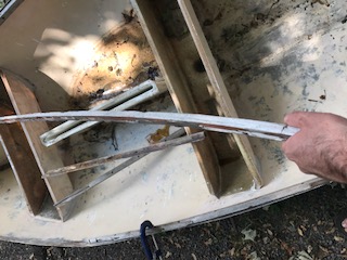

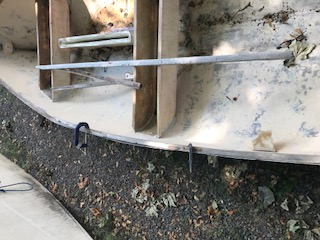

The Starboard inwale is the only complete piece of teak that I have for the gunwales. I have pieces of another piece. I'm adding these pictures for reference. Sadly, this boat has taken a back seat to a J/24 repair and a Laser project, so please pardon the mess.

You can definitely make those bends without steaming or soaking the wood.
You might also look into teak substitutes at your local lumber yard. Not a Home Depot but a real lumber yard should have some very nice decking lumber that is oily, straight grained, 5/4 X 6 and in long lengths. I did a CD-14 and a canoe with the stuff and it works out nicely for a fraction of the price. It is easy to find and you can pick through the pile to find a really nice piece, Steve.

pro tip.. buy a length of 2" pvc pipe and cut it into a lot of 1" rings. Then take the rings and cut them on a band saw on one side. you now have a lot of simple clamps to hold the new rail on when you epoxy it to the hull. If they are too tight, just make the cut wider until its the proper tension.
