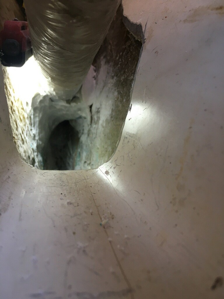

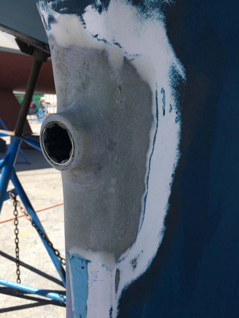

I think we got it this time. Launched on Friday just to test the new shaft log for leaks. Looks really good.I think the yard guys feel pretty dumb for their first attempt to repair but I am really happy now but I don't know if I can pay for it. I am hoping they will credit me some. will know next Friday. I have more photo of the shaft log project but I can't post them till I figure out how to separate them.Here are three . The first shows how they cut the engine tray to access the shaft log. The 2nd is the finished job and the last photo is the exterior. I asked about the set screws to take the bearing out and he told me they didn't use them. They glued the bearing in place. I hope thats OK. Any Comments?

Those all look familiar. Good luck on the bill.
