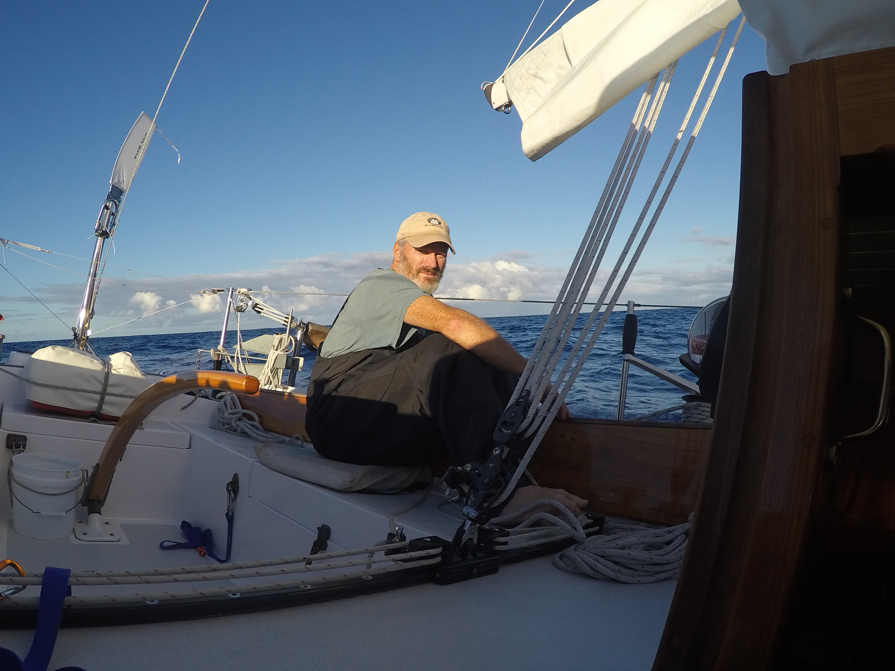

It's doable. I did it on my CD 36 Far Reach. It's not difficult but it is time consuming. Depending on how you do it you are probably looking at $1k-2kif you do all the work. Here is a link to the details of how we did it. http://www.farreachvoyages.com/projects ... rsion.html
Since you have not bought the boat yet my first response is to find a boat with a tiller. I suspect there are a number of them out there.
If you really want a tiller (I did) do not be deterred but do be prepared for the task.

It's doable. I did it on my CD 36 Far Reach. It's not difficult but it is time consuming. Depending on how you do it you are probably looking at $1k-2k if you do all the work. Here is a link to the details of how we did it. http://www.farreachvoyages.com/projects ... rsion.html
