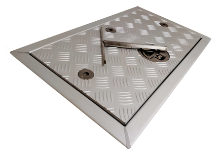

After many years of twisting my 6'2" body through my CD36 port lazarette to get behind the engine, I installed an access port in the cockpit floor. I wish I had done it years ago. It has made possible what was previously impossible. I used a Bomar cast aluminum access hatch. They make two types, both with fully-removable hatches. One tucks in on one side and has twist locks on the other. The other has a tee-handle and four positive-locking dog latches, which I preferred. The cockpit floor is 1" thick and I have seen absolutely no flexing. The hatch was not cheap, but I did the installation myself, saving money and getting it done right.

That's what I'm talking about. Perhaps with some careful glass work you could sit it flush with the current cockpit sole. At about 28" x 22" that should make you fit down. OK so it's a whole year's worth of your boat upgrade fund...ah well.
https://shop.hamiltonmarine.com/product ... 6061.html
