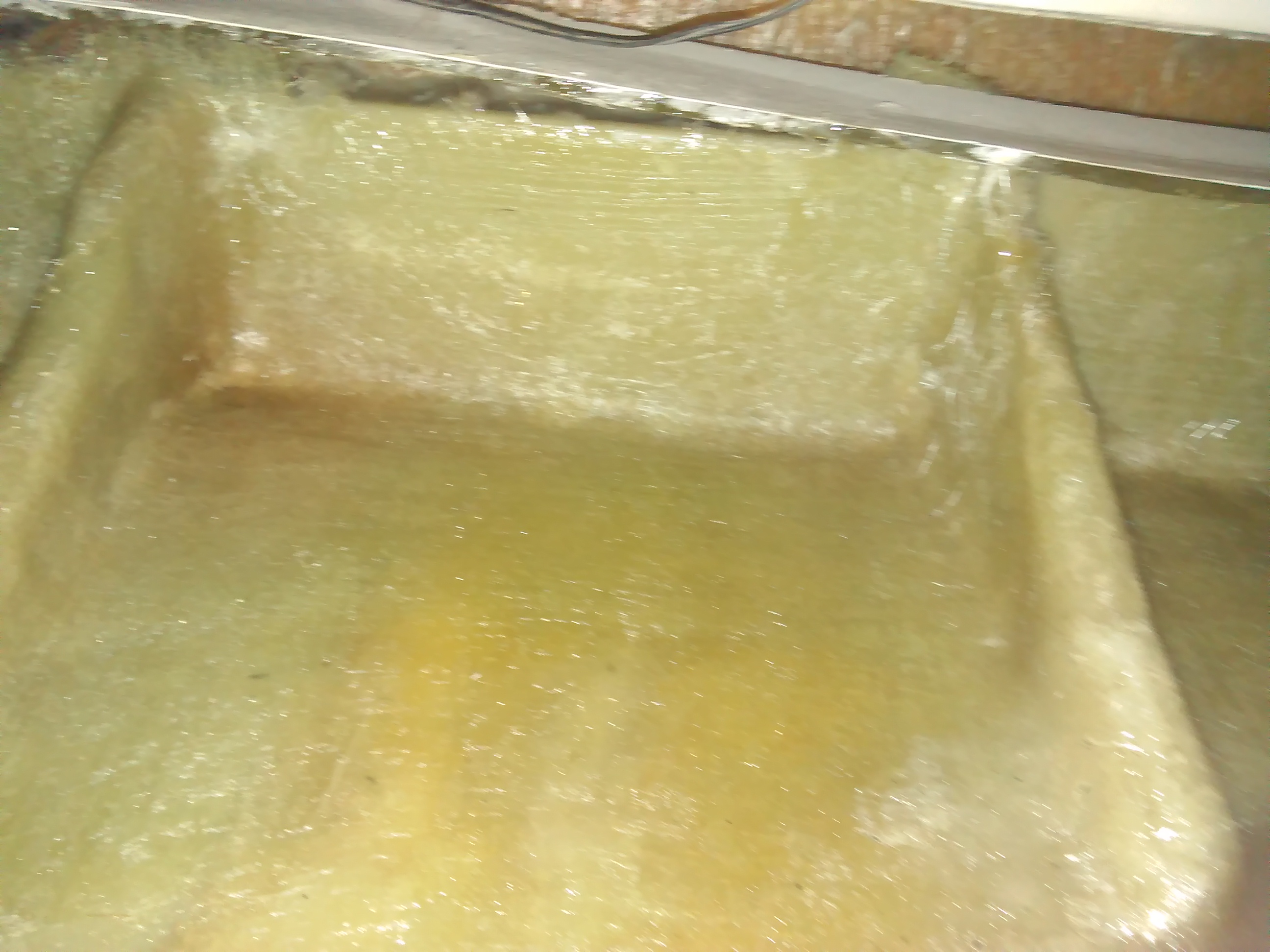

CD 30K "Leoma" update.more photos for your entertainment. I thought I was ready to put the mast up and launch but found at least 4 bad swag connections,decided to change all the wires and unstep the mizzen as well. The photo of the mizzen step didn't come out, It is broken. They will make one out of g10. The middle photo shows one of the side backing plates made of g-10 and g-10 knee braces.,There was a void above the plate that is packed with a mixture of chopped and fibers and whatever else they put in. I noticed the original also had filler in that space. All the stuff is on deck so the surveyor can have access . He is gonna survey like it is so I can get a slip at Ventura in August

"Leoma" is looking sharp. The G10 backing and braces look as good as any retrofit that I have seen.
