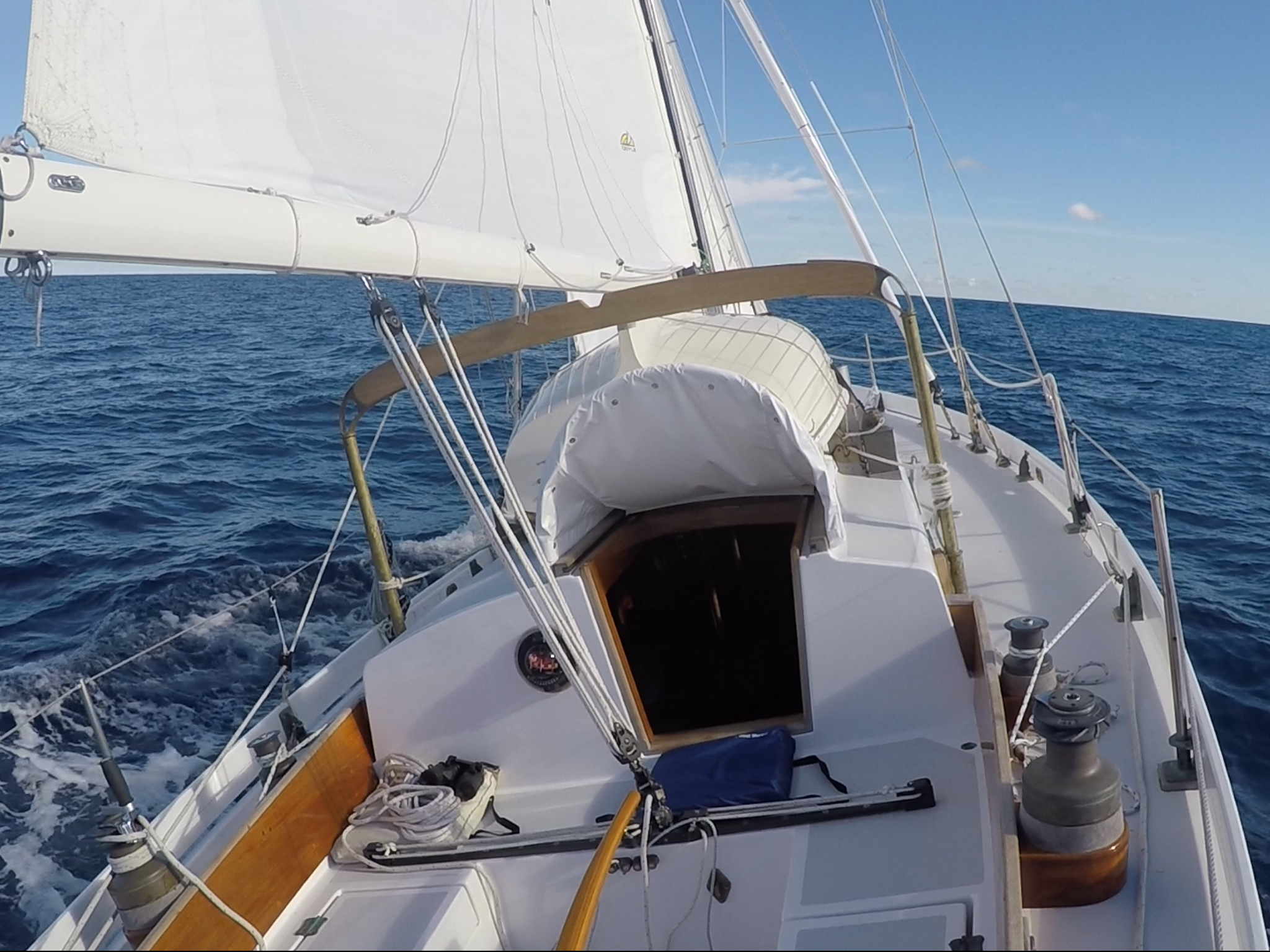

I installed a boom gallows. Very happy with it. Here is a link to the daily log. Scroll down to 7 Nov 2015.
http://www.farreachvoyages.com/dailylog ... esent.html
- IMG_0563.PNG (4.42 MiB) Viewed 630 times
