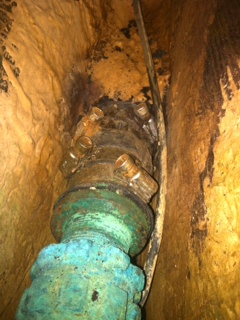

We hauled out Air Raid late October 2013 to do the usual bottom paint and other maintenance that needed to be done. It is at this time I made the corporate decision to pull the MD11C to help with the access for replacing the shaft log hose, cutlass bearing, and of course the stuffing box packing I am sure it is overdue. (read on)
Can this be done with the engine in?
I saw no way to get my big butt in a place that only the brave dare, and the admiral said no way! Hence my decision to pull the engine. (Not fun)
We found all kinds of stuff in the bilge including 2 screwdrivers and one wrench along with 30 years of gook. It was not pretty.
The reason for the long story is the shaft log hose.
After gaining access to never - never land. Only 2 of the four hose clamps for the hose are accessible the aft two are buried under whatever Cape Dory poured in there. (Still working on those) the forward 2 were easy. I reached down to loosen the clamps on the stuffing box and found the hose just a little too easy to move side to side of course the prop and shaft has been removed. Well I wiggled the packing gland a bit just to see how much wiggle I could get.
The hose tore in two with no more effort than it takes to tear off a paper towel. No Kidding!
I was in shock, disbelief, amazed, and holy crap all at the same time. . (Not my exact words they were more colorful)
The other half of the hose is still intact on the shaft log.
I have pictures as soon as I can figure out the posting pics thing.
I could not gain access to the other 2 clamps. I (we) ended up prying from the inside on the clamps and she turned the shaft log a quarter turn at a time from the outside until the hose and clamps were free. The clamps were not your standard worm gear clamps they are Band-It type clamps crimped no screws. (can you say fun)
The hose appears to have never been changed and is in my opinion no way (thick) heavy enough to be in such a location but it lasted this long? Anyway the whole thing is out. I have ordered new hose, clamps, packing, and cutlass from Spartan marine. It should all arrive next week,
Sorry for the long post but for those that have not looked into replacing that nasty little hose. Might give it a second thought, from what I found, the blood sweat and tears were worth it. Now the fun part putting it all together.

I replaced all of the above on my CD22D this past year. While my hose showed clear signs of wear, it was not as deteriorated as yours apparently was. While you have the engine out, I would recommend that you consider also replacing the prop shaft and the engine mounts. Your 30 year old shaft is probably no longer perfectly straight (increases wear on the cutless bearing) and may have some scoring (increases wear on the stuffing box packing). You will, also, be amazed at the difference between new engine mounts and 30 year old mounts. One thing tends to lead to another but you don't want to ever have to remove the engine again.
