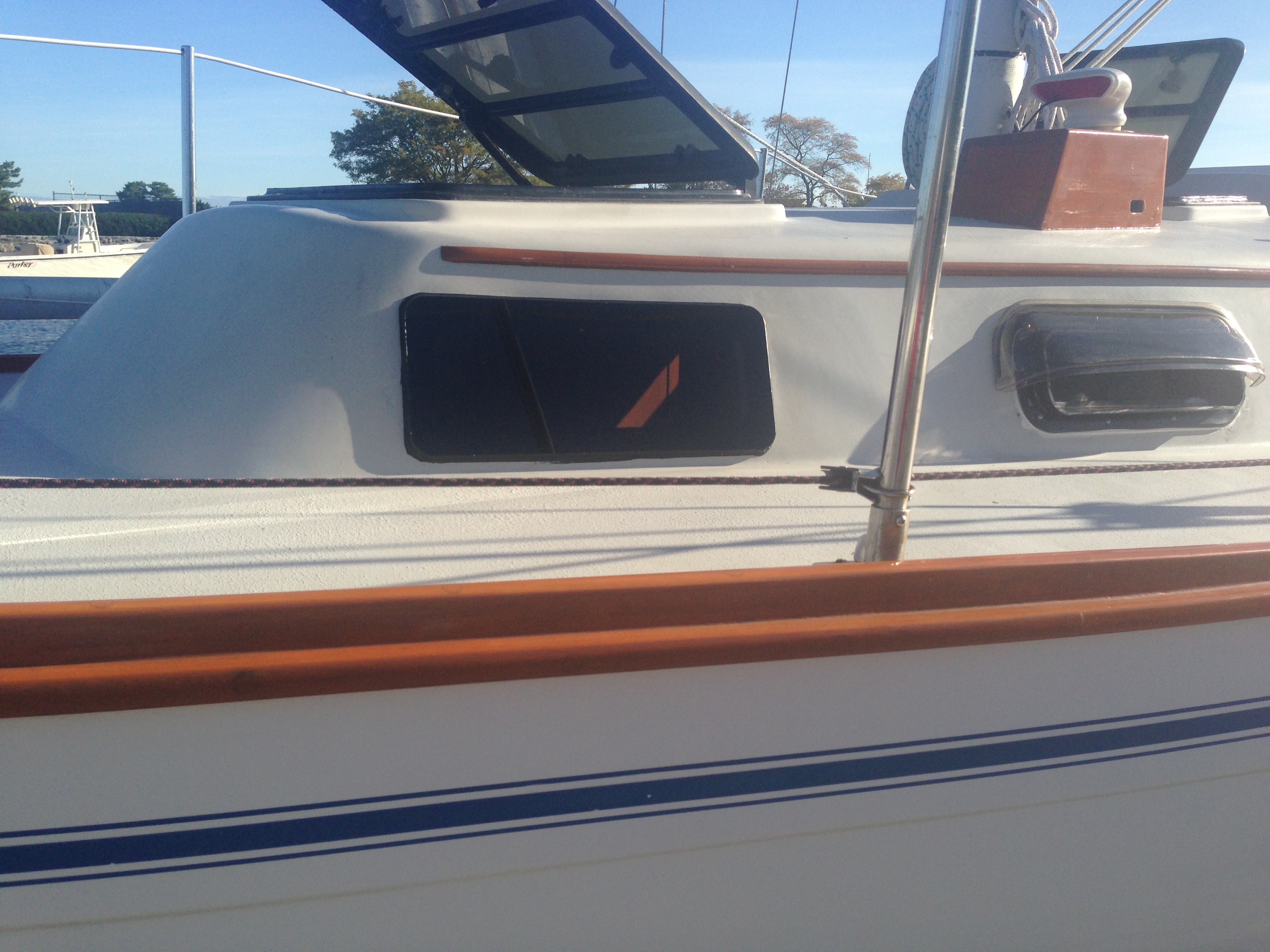

I replaced 4 of the opening portlights on my boat with fixed, surface-mounted home-made portlights.
I found a good article on-line from Sail magazine which was my guide:
https://www.sailmagazine.com/diy/replac ... portlights
I used 1/4" thick plexiglass with a grey tint. I bought it pre-cut.
Plexiglass-
https://www.tapplastics.com/product/pla ... colors/519
Transparent Acrylic Sheets (Cut-to-Size) - Transparent Light Smoke - 57%
1/4 (.236)" Thick, 7 inches Wide, 17 inches Long, with rounded edges and 1 inch radius corners
total cost was $64 for two windows
To attach the plexiglass to the boat I used
3M VHB ( very high bond ) Tape # 4991 ( 1/2 " wide)
And to seal the edges of the plexiglass I used black Dow Corning 795 silicone.
The project was not very difficult, but you do need to be precise in measuring before ordering the plexiglass.
And you need to dry fit and mark (with tape) where you want to mount them because you only get one shot with the high bond tape.
They came out pretty good. Nothing to compare to original bronze Spartan ports but they don't leak a drop and have held up well for 5 years now.
