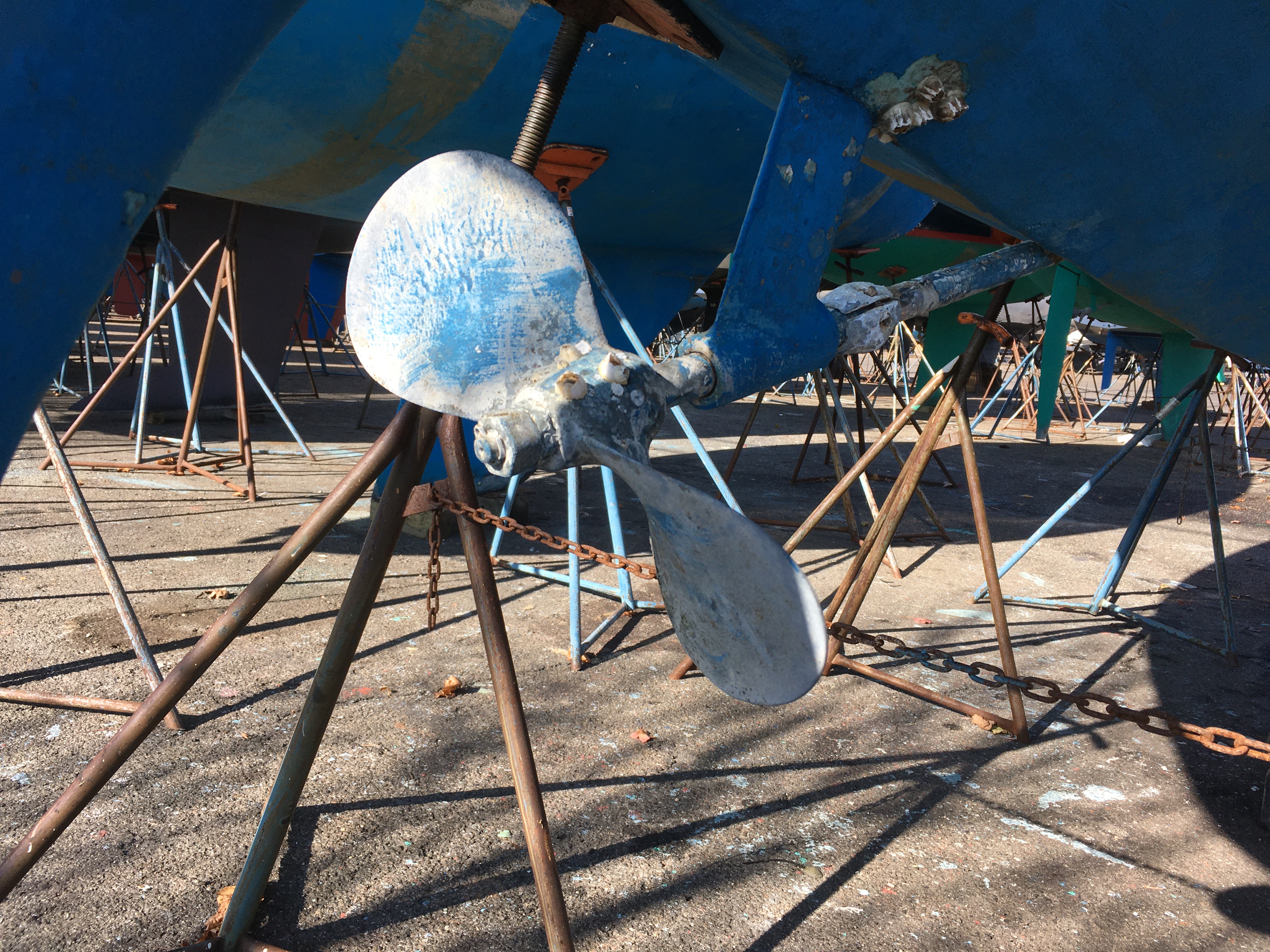

For the 2021 season I thoroughly cleaned the prop and drive shaft and roughed them up with a red scotchbrite pad. Then applied 2 coats of Rustoleum Zinc Chromate paint.
After 6 months in the water (saltwater harbor at the end of a slow-moving river) the result was not good.
Lots of barnacles and a very noticeable vibration and loss of power when motoring.
For the 2022 season I did the same but added a light coat of regular copper based bottom paint- Petit Hydrocoat. And I took a swim in August and used a metal scraper on the prop blades and drive shaft.
The result was very acceptable:
I used the boat and motor quite a bit - about 2-3 times each week and about 30 minutes of motoring each outing.

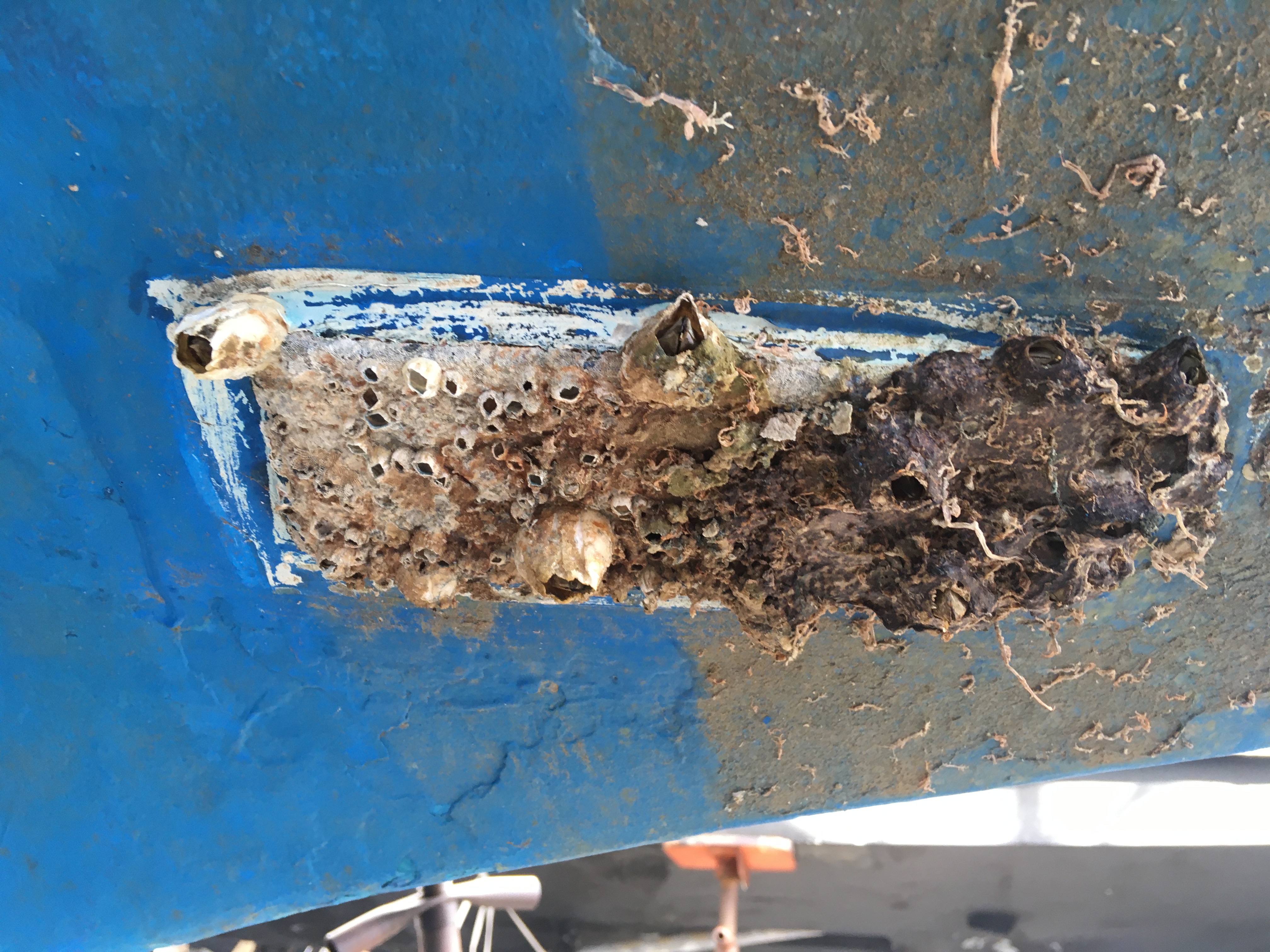

Not a direct comparison but here's a picture of the bronze grounding plate which only got the same paint but no August cleaning:
Any thoughts on how best to paint and maintain the ground plate?

The grounding plate should be left bare. It’s made of sintered bronze and it will attract growth, but it must be left bare to do its job. Just give it a scrub, if possible, mid season.
Nearly every harbor has its unique environment so what works in one spot may be a disaster a few miles away. This season I just put a few coats of paste wax on my prop and it was only covered with some soft scum and a hundred pinhead sized barnacles. That was in seven months time. I only scrubbed it with a brush once in June.

Thanks Jim. I'll strip the ground plate back to metal.
I'll plan on an annual prop and plate cleaning swim.

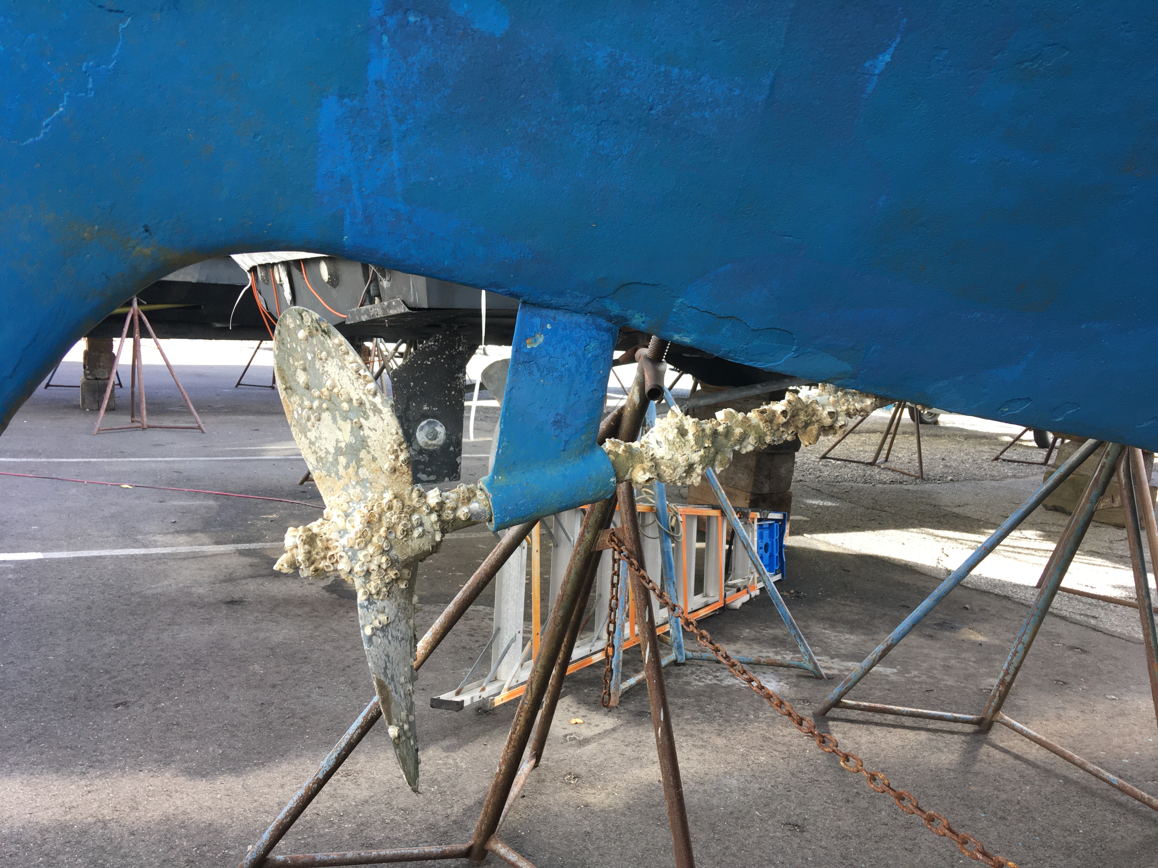

Updated for 2024 results.
For the 2024 season I again used the zinc paint - Rustoleum version.
I did not put anything over it such as copper-based antifouling paint.
The results were terrible. Must have been a bumper year for barnacles.
See the picture - even the zinc on the prop shaft was covered in barnacles.
So, either zinc is not an effective barnacle barrier or the zinc I installed doesn't contain much zinc.
I did go for a swim and scraped the prop fairly clean in September and then hauled the boat in November.
The dyna-plate had been cleaned thoroughly and rebedded before start of the 2024 season and left bare.
It too got lots of barnacles. Interesting to see that the areas where the SikaFlex sealer was exposed had zero growth.
Not too concerned about the dyna-plate. When the prop gets barnacles, the engine tends to vibrate.
The dyna-plate doesn't cause any problems.
For the 2025 season I am going to try PropGlide on the prop and shaft.
Will update this next year with the results.

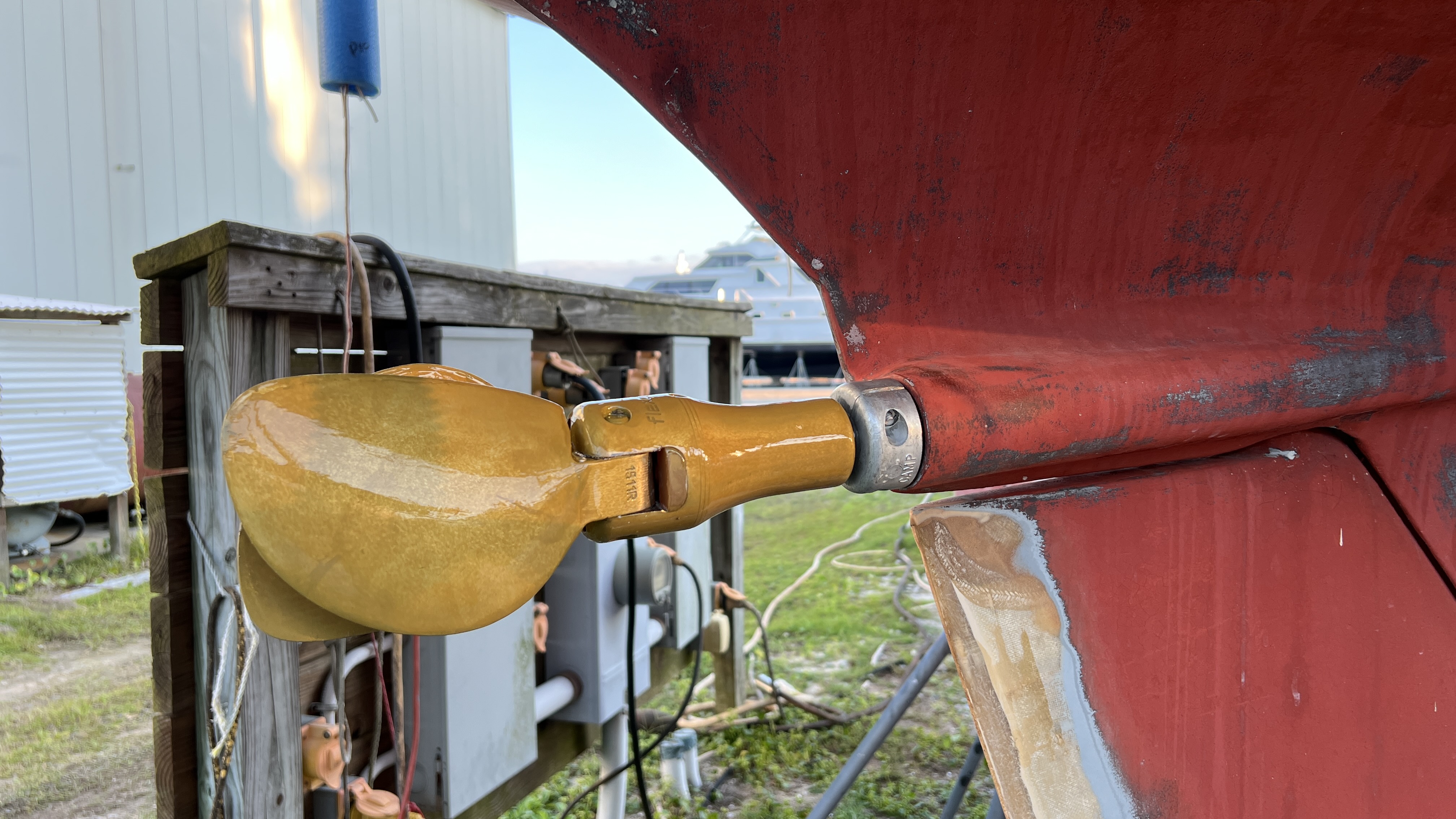

I decided to try Prop Speed for the next voyage. They make a small kit for a single small prop. Got it on sale. Just curious about it. Very specific instructions. There is an etching compound then a two part mix of what feels like a rubber silicon top coat. Have not splashed the boat. Will be interesting to see how it holds up.
