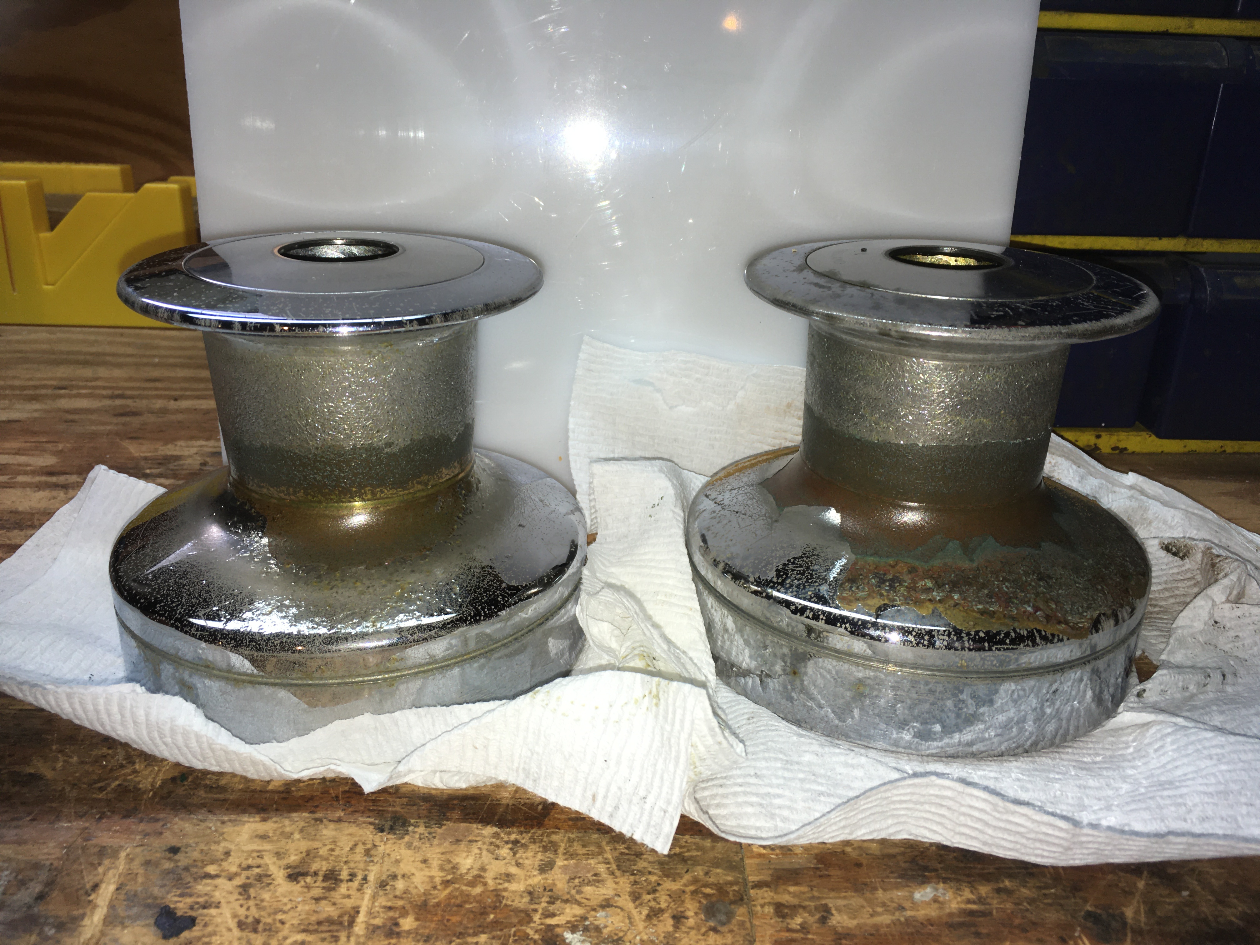

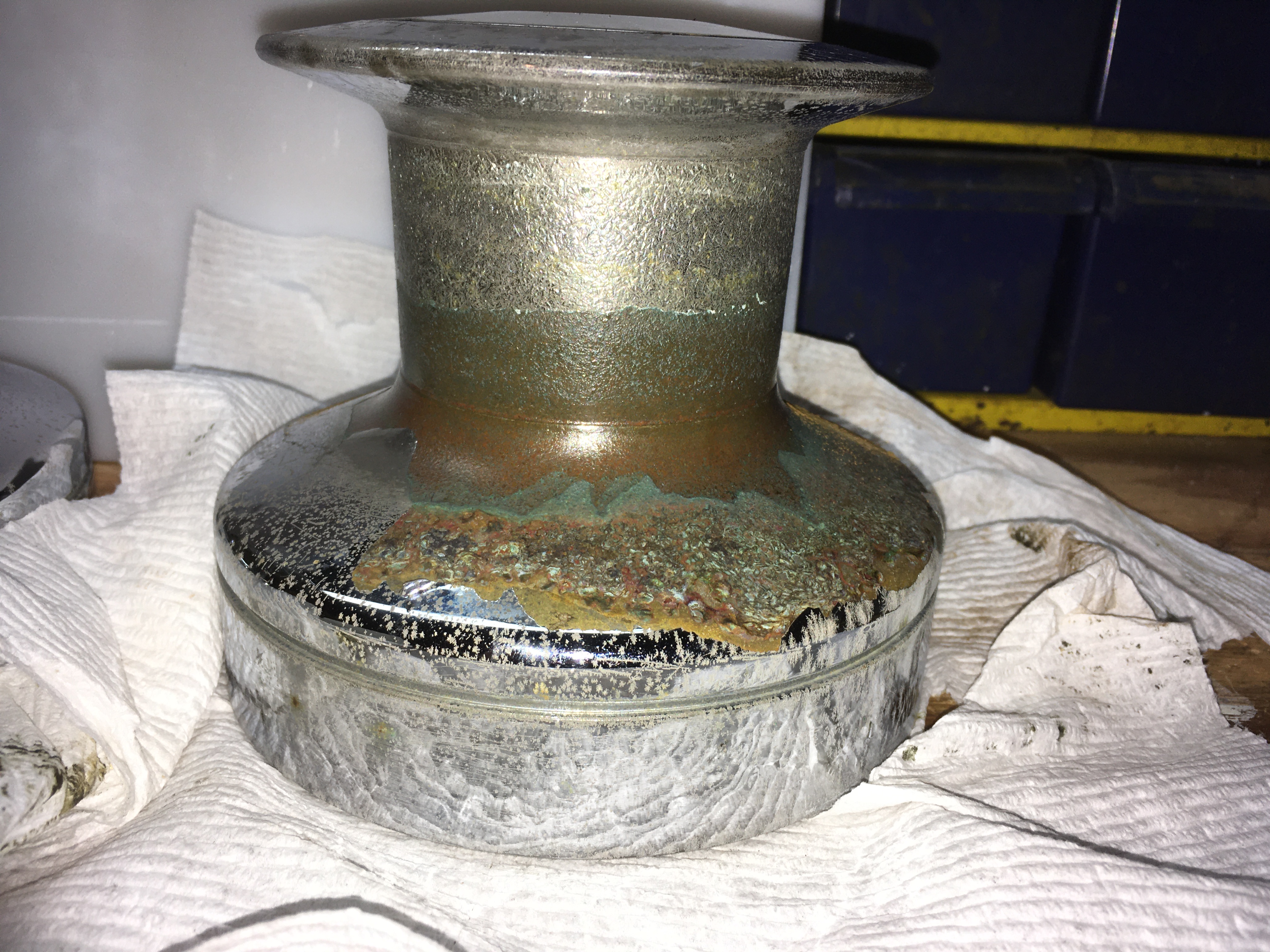

The jib sheet winches are Lewmar 30 Two Speed.
They work well but the chrome plating is coming off in. Kind of tearing off and leaving sharp edges.
I'm thinking of removing the chrome plating and leaving them bare bronze.
I'm thinking of taking them to a chrome plating shop to get an estimate on stripping them.
I'd ask them to not smooth out the roughened surface where the jib sheet contacts the winch.
I welcome your thoughts and opinions on this.
If I go ahead with this I'll post some more pictures as the work progresses.
Here are the before pictures.

Re: Removing Chrome from Lewmar 30 Winches
A plating shop will have no problem stripping your drum and the top cap. Just disassemble it yourself and bring them only those items you want stripped. The stripping process uses harsh chemicals but the stippling on the I.D. of the drum should not be affected by the stripping process.

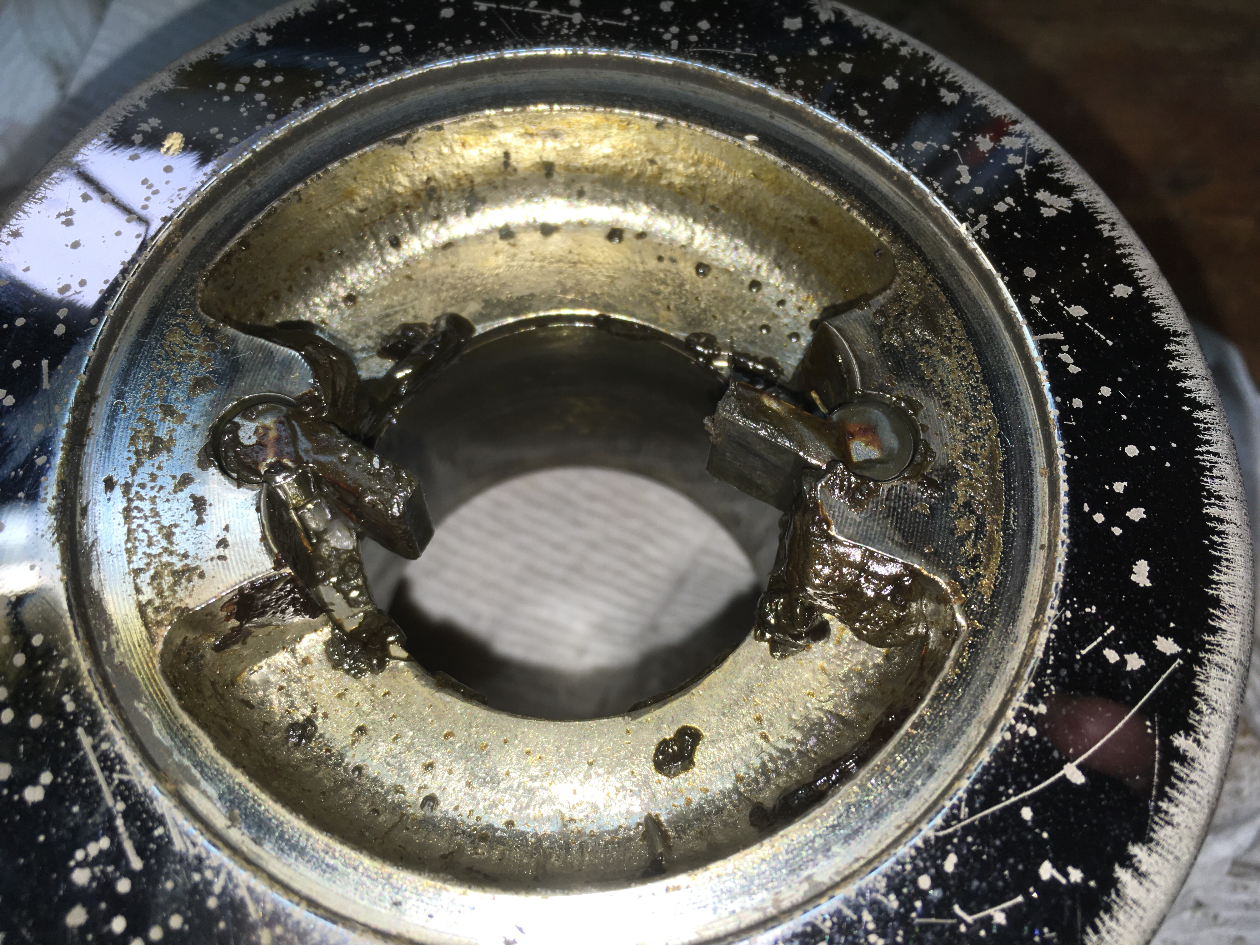

I've got the drums off. The only moving parts attached to the drums are the pawls near the top.
I'm guessing that they will not be harmed by the chemicals?
Yah, they look pretty dirty/greasy. I've had the boat 4 years and this will be my first try at cleaning them.
You want to remove the pawls and springs. Small parts will not be welcome at the plating shop. They are easily misplaced and they can contaminate a tank.
Concur with Jim. The pawls and springs come out easily. When you reinstall do not grease the pawls and springs. Just light machine oil for them. The bearings of course get greased.

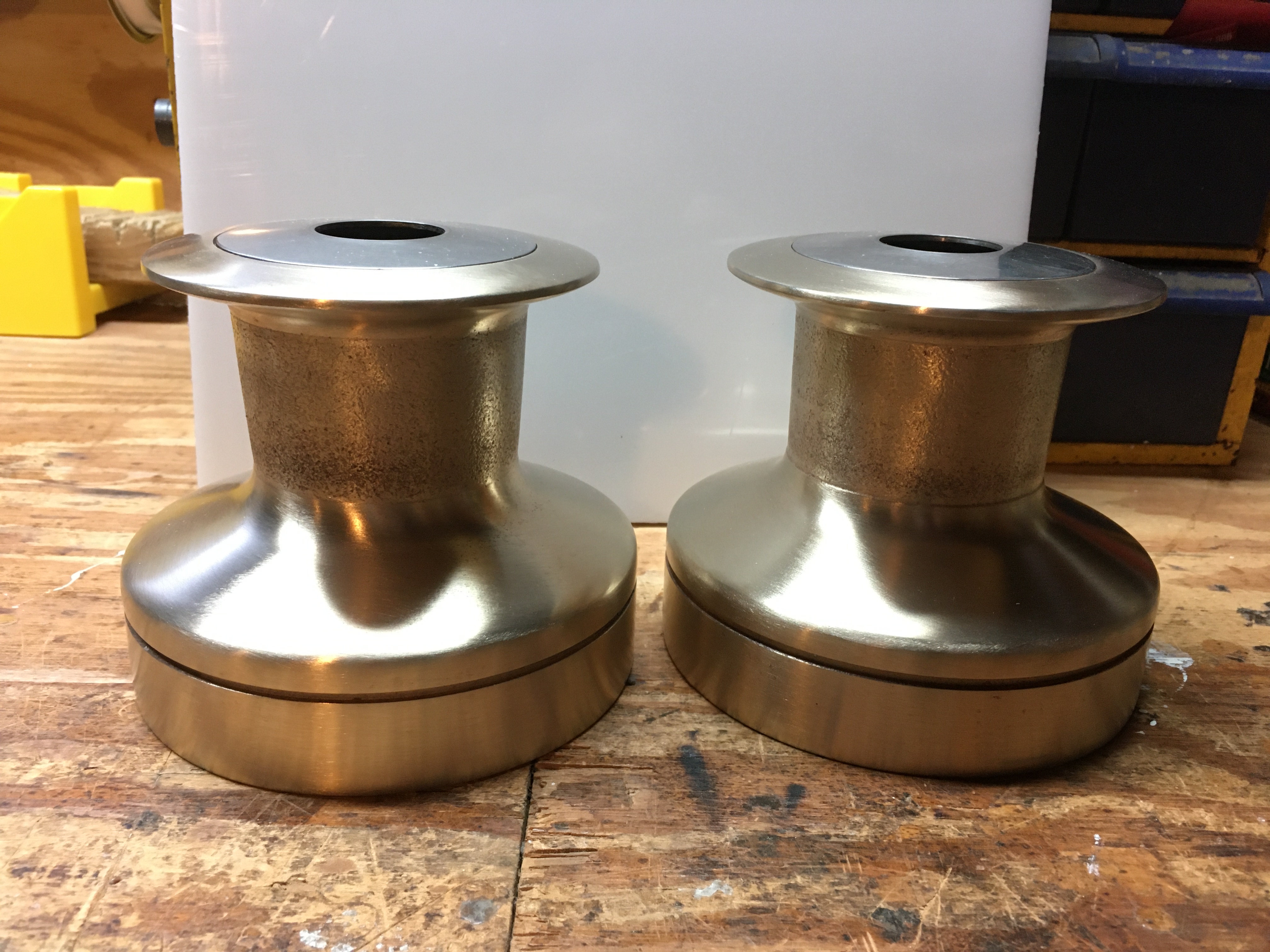

I got the winches back from the plating shop today.
I did not ask them to polish them but they did that anyway.
They came out very nice.
Next I plan to put the pawls and springs back in and oil them with 3-in-1 oil
and clean the bearings with mineral spirits and grease them with Lewmar Winch grease.

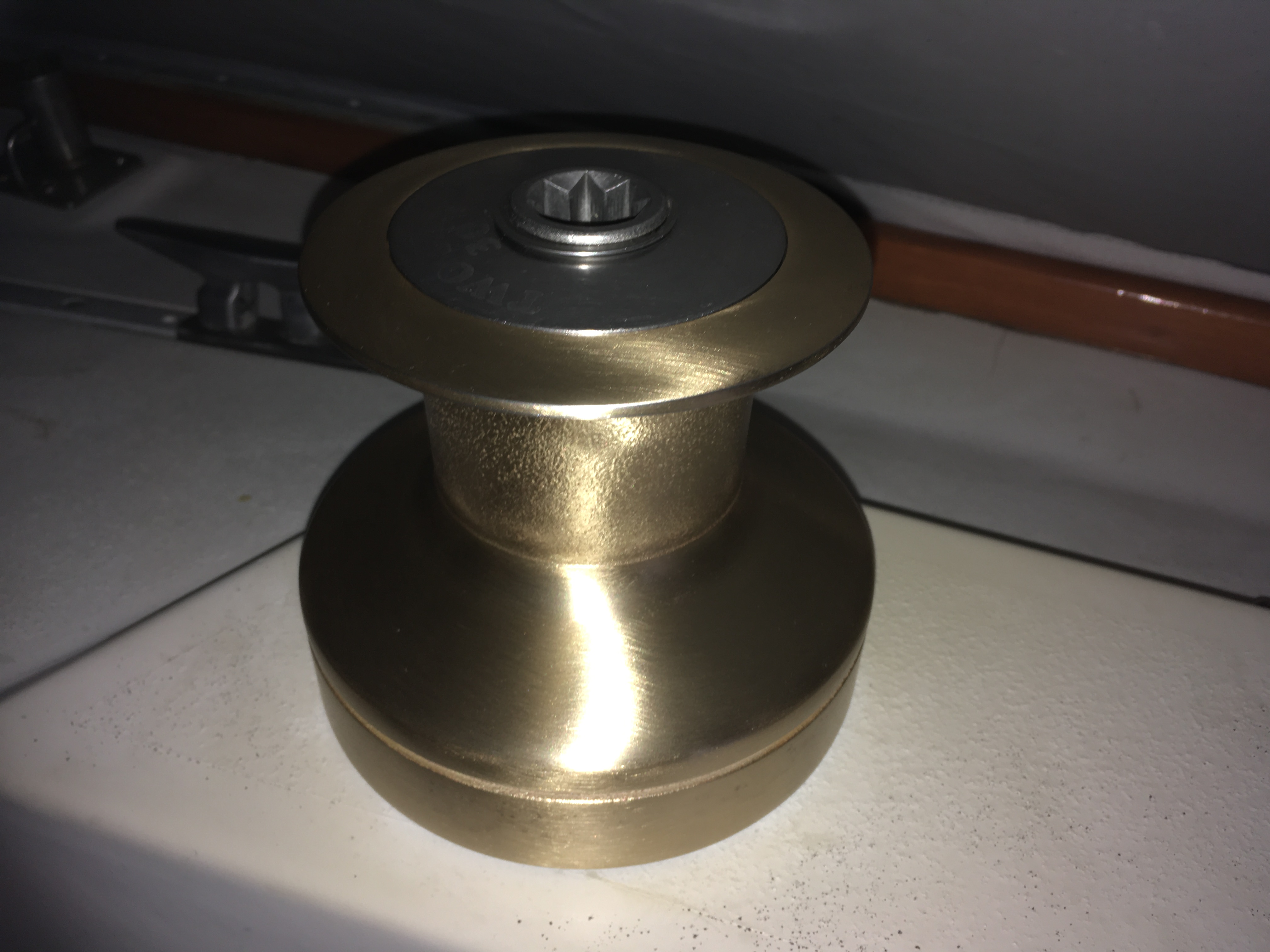

Thanks all for the tips.
I cleaned, regreased/oiled and reassembled onto the boat.
New pawls and springs have been ordered and will be installed soon.
They do look great back on the boat. It's nice to have a cover with a big zipper to allow for winter projects.
