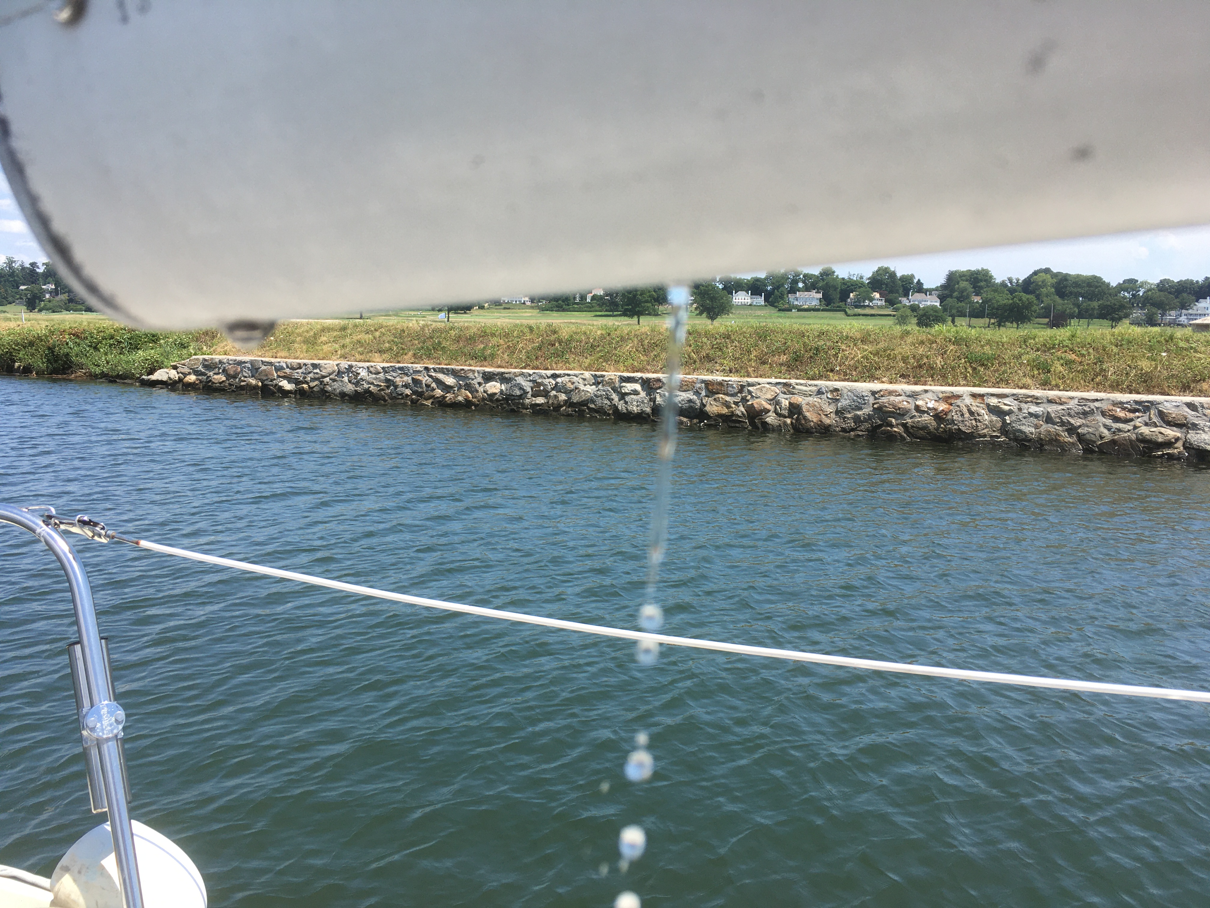

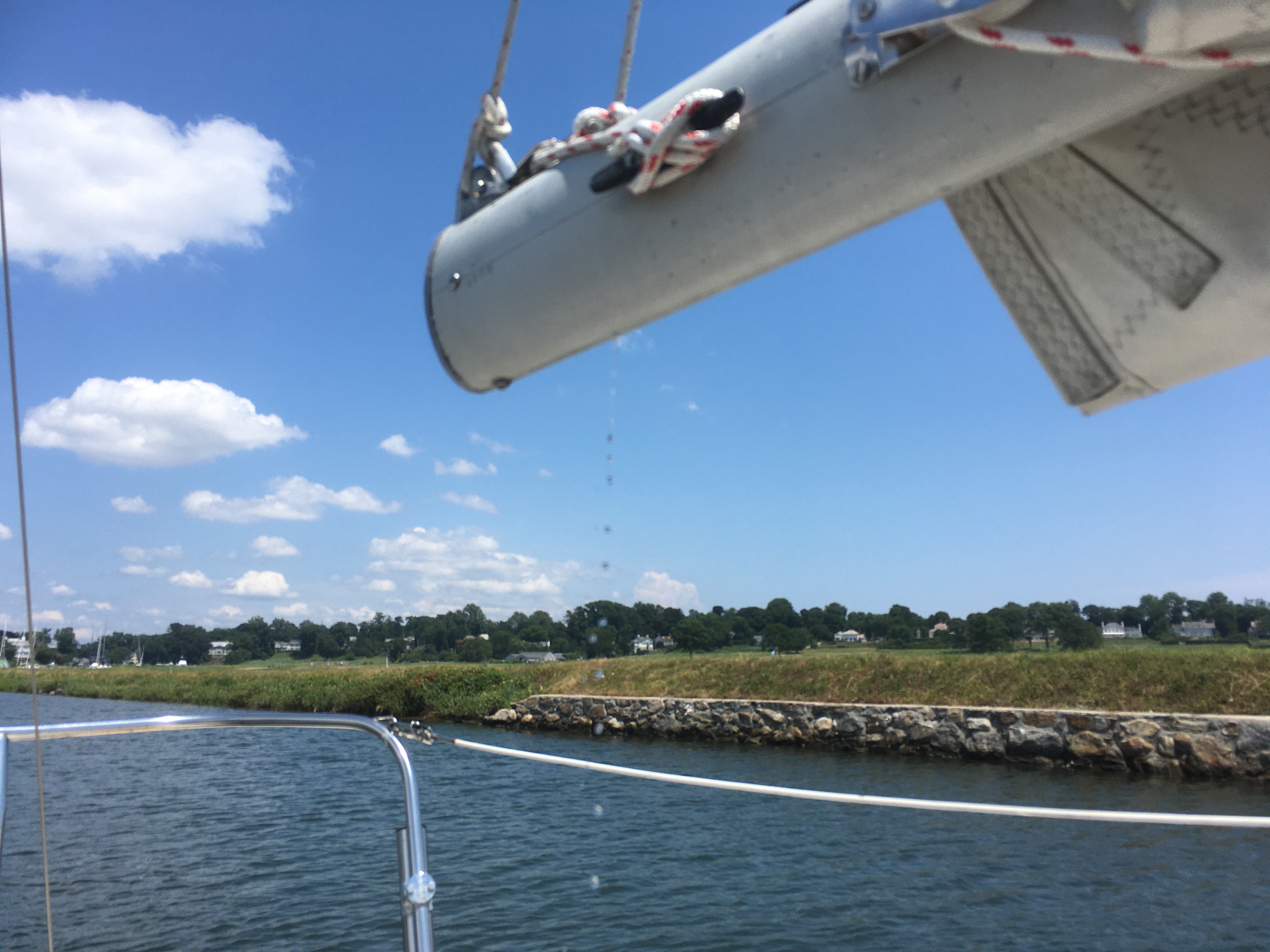

Thought you all might get a kick out of this -
I was out sailing a few weeks ago and got caught in a sudden rain storm. I was in deep water in the middle of Long Island Sound and it turned into quiet a squall. I furled the genoa and road it out with just the main. Pretty manageable to continue sailing. The rain got very hard and the main sail got a very good washing.
Within 30 minutes the skies cleared, the wind lessened, and the seas calmed. A couple of hours later I got back to the mooring and was completely dry from the warm sun and wind.
Anyway... Ever since when tacking I would see water come out of the boom. There is a bail for the mainsheet about mid-boom and water would come out from the bolts. This had never happened before and I generally don't get caught in the rain and keep a cover on the mainsail when in port.
So yesterday I drilled a small hole in the bottom of the boom near the aft end. Water poured out. Maybe two cups of nice clean fresh water.
I'm not recommending that you try this but if you do then I'd recommend a cordless drill that you don't care about or a non-electric hand-drill. I could see a definite electrocution concern.
Ken

Or raise the boom so the water flows to the other end. Then lower it to drain

Tangent: I crew on a Tartan 4100 in our local beer-can races. It has a big Park Avenue-style boom (the top of the boom is shaped like a wide gutter to catch and store the main). Whenever we get a good rain storm several GALLONS of water will accumulate in the boom and in the folds of the sail. Lifting the end of the boom with the topping lift drains a lot of it, but not all, so when the main gets raised and the water shakes out of it, whoever's downwind gets a pretty good shower.
