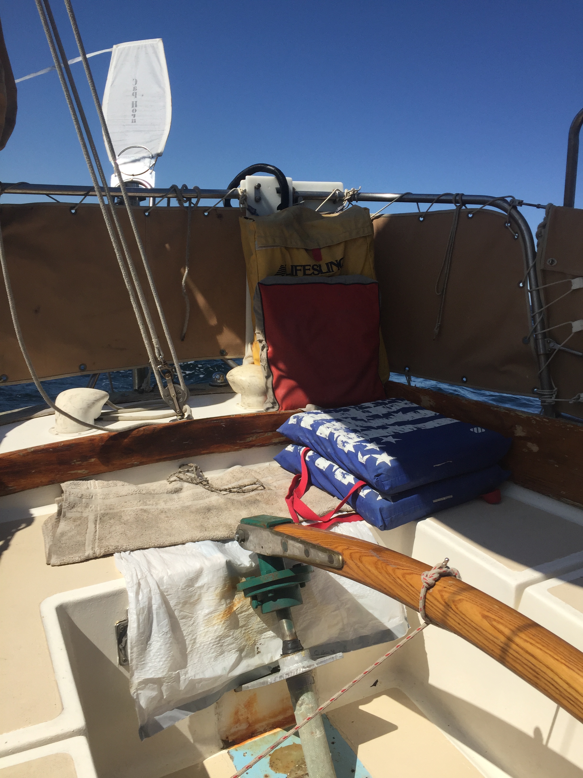

I took "Leoma" across the channel this weekend . The windvane worked perfect coming back on a broad reach. Thee was no need to use it going since she holds the coarse pretty good close hauled.. Anyway hopefully this is the last time I will use this tiller. My worm gear steering should arrive tomorrow.
The weather fax reception was much better out there. I don't have a copy to show you

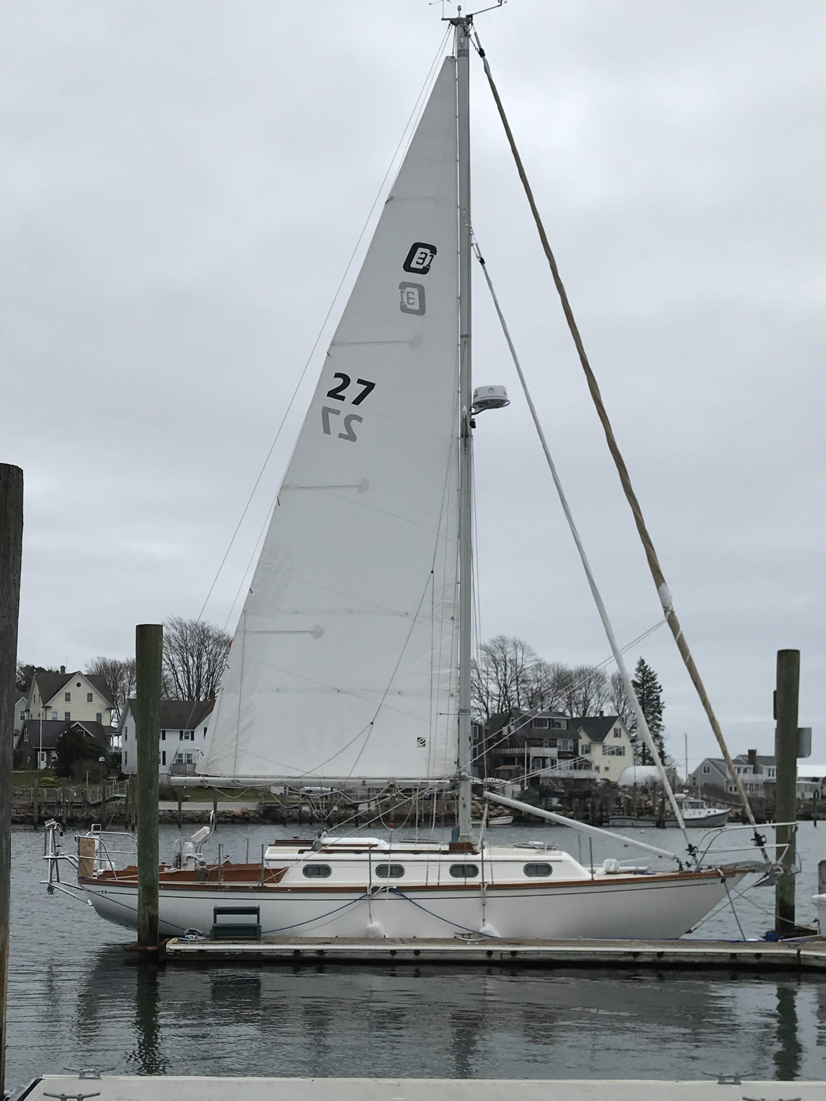

Here’s a couple photos which illustrate the method I have chosen. I have lazy jacks which are fixed to pad eyes about four feet up from my spreaders. My adjustment is done from a cleat attached to the bottom of the boom about three feet from the gooseneck. I made them out of 3/16 Amsteel dyneema and four Harken Carbo blocks, two on each side. I adjust them after I’ve gone for my first sail of the season and rarely ever adjust them again. Since they are fixed in place my mainsail cover has three zippered cut-outs on each side to accommodate the lines.
I have never found it necessary to bring the lazy jacks forward to the mast when raising sail. I can count on one hand the number of times they have fouled a batten when raising the main over the years. It is probably attributed to the fact that my lazy jacks only extend about two thirds of the way toward the clew. I designed them to catch the belly of the sail when dropped, not the entire sail along the foot.
My way of rigging lazy jacks is ONE way.....not necessarily the right way for everyone’s application.
Hopefully you can adjust the image size of the photos I’ve attached so you can see the lazy jacks more clearly.

- This was taken on 4/5/20. I had just bent on the main for the season. My lazy jacks are a bit loose in this photo as I had not yet been out for a sail.
- 9D718477-7CAF-4168-AD7F-D5F1898FEFE8.jpeg (1.42 MiB) Viewed 867 times
- Orion under sail last season. You should be able to see the lazy jacks in use.
- B91E4A21-6E26-4F19-BB1E-AE9D713E72A7.jpeg (579.2 KiB) Viewed 867 times
