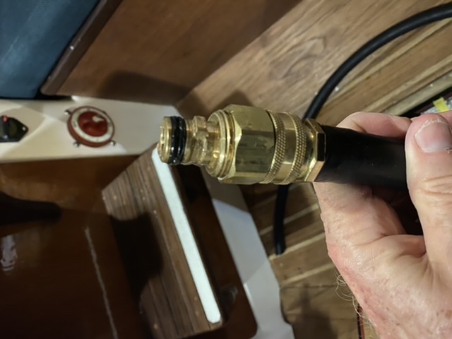

Well I’ve decided to keep my boat in the water at Rhode Island YC thru the winter. In order to be able to quickly pump antifreeze thru the seawater cooling/wet exhaust circuit I added a Groco SSC service adapter
https://www.groco.net/products/valves-s ... ce-adaptor
just inboard of my Groco cooling water thu-hull which resides in my keel space - a mod I made a few years ago during a general refit. It works great, takes just minutes to pop the little plug and fit the 6 ft hose I cut and fit the service plug to. With that in place the hose just slips into a gallon jug of antifreeze and that is almost exactly what it takes for “pink” to appear flushing out of the exhaust port. I’m sure there is likely some dilution occurring but it’s also -50 degree antifreeze. If I ever anticipate single digit temps I’ll switch to -100 degree antifreeze .
I’ve decommissioned the head and fresh water tank/pump for the winter. The head and holding tank have been flushed with antifreeze. The club provides upwellwrs for the season. They are only on if ice is anticipated. Power stays on in the marina and so far I seem to be able to lift my cabin temp 20 degrees above exterior with the single ceramic space heater I’ve got going. That should add a layer of protection and generally lower humidity as well. It’s a nicely robust unit. I put it in a fry pan just to be cautious about contact with the cabin sole.
I’m having a cockpit “tent” made by a local canvas shop. It won’t be comprehensive but should keep most of the rain and inevitable snow out of the cockpit. There were 10-15 days last winter where a little sun and 40ish temps had me thinking - darn I wish my boat was in.
A few pix
A few pix

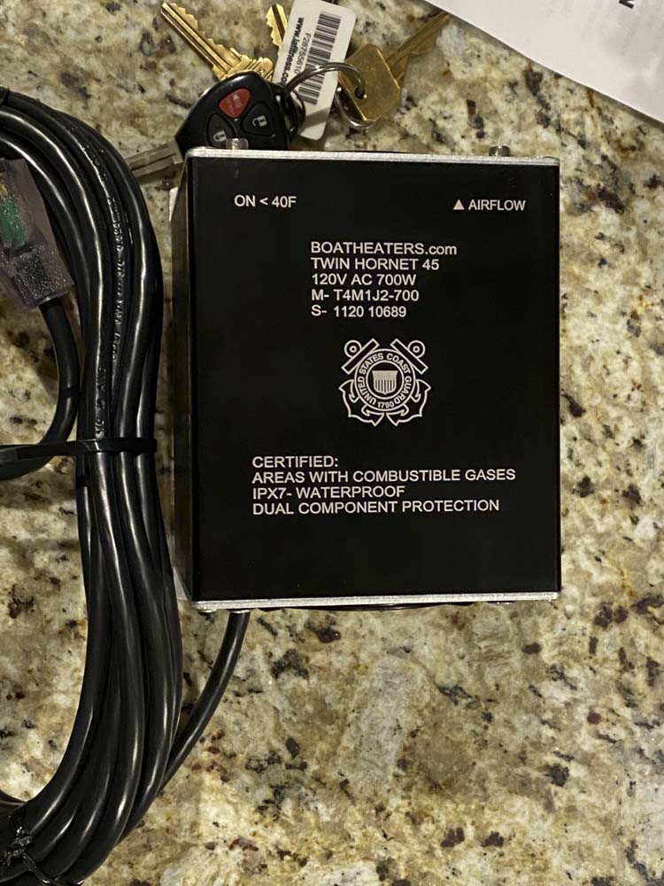

Following Steve Laume's advice I got a "proper" bilge heater ...
Thanks Steve ...
After as thorough a comparison as I could make of various heater devices I got a Twin Hornet 45 by BoatHeaters ... basically an on demand 700 watt heater with built in blower.
It's surprisingly small and appears to be of very high quality in build and materials; well beyond a typical electrical cabin or space heater. But most importantly, meets ISO, SAE, ABYC certifications as specified by the USCG.
It will be powered by the A.C. utility outlet on my Xantrex Inverter/Charger which has an GFI A.C. pass thru feature when shore power is available (with no ground connection to the DC system). I can disable the inverter feature (a custom setting) so that if shore power fails this little heater will not kill the batteries. (Default is that the inverter goes on immediately when supply AC is disconnected and there is an A.C. load present on the GFI outlets).
I've got an idea for a little aluminum scoop to direct airflow down into the bilge area thru the cutout in the sole on my 27 - which should then also allow warmed air to "lift" up into the engine box at the back end of the bilge.
a few pics: (ps. have been having a good time so far sailing in 35-50 degree weather which is the whole point ... I just layer up ... it's starting to seem "normal"
cheers. Fred
Thanks Steve ...
cheers. Fred

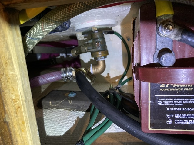

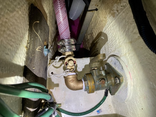

I am going to play the Devil's Advocate for a second. Are you mixing brass and bronze?
Danielle Elizabeth
CD30
Danielle Elizabeth
CD30
Re: Sailing thru the Winter / Groco SSC service adapter
Fred Mueller
Jerezana
CD 27 Narragansett Bay
Jerezana
The hue is what made me thunk it. Dennis
