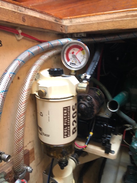

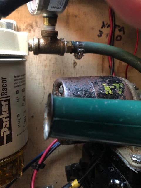

I just installed a racor vacuum gauge and I can barely get a reading in it. I first installed it in the extra output port and it barely moved off zero. I bleed the system several times but no change. Then I moved it inline between the filter and the fuel pump and the same results. My filter is 2 years old with maybe 100 hours on it. I expected to see that it would have a lot more vacuum and probably show that it needed to be changed. Looking to see what others who have installed the vacuum gauge have seen. See pics below of the final install. In the first pic the engine is running and you can see the gauge is barely off zero. When I shut the engine off the needle does move back to zero and when I pump the manual fuel pump lever the needle does bounce a bit.

I though the gauge was supposed to go on the in the output side of the filter.

It is between the fuel filter and the fuel pump connected to the out side of the fuel filter. I don't understand what you mean by "inout side" of the filter. My racor filter has one in port and two outs ports. It is a 500 series fuel filter/water separator.

I have had a vacuum gauge in my fuel system for many years and I have never seen it register much of anything. Mine is an early model without the pointer so I only check it on occasion and don't know what it does when I am running at high RPMs. The gauge has lead me to believe that most people change fuel filters far more often than necessary. These small engines are not ever calling for much fuel so there isn't much pull that would create a vacuum with very little restriction.
My feeling is that your gauge is showing you exactly what you want to see, Steve.
